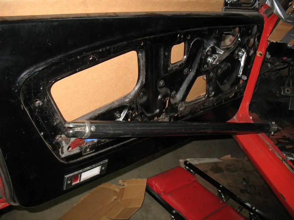

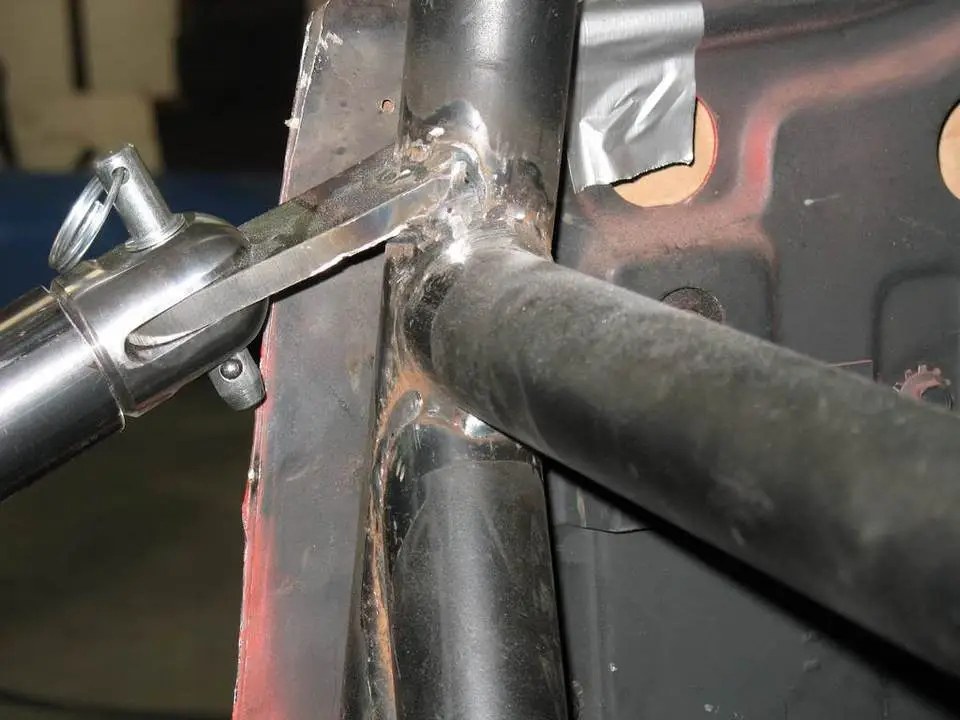

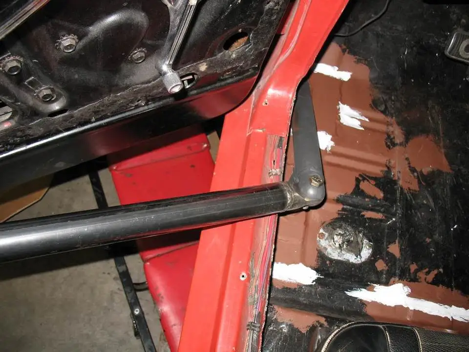

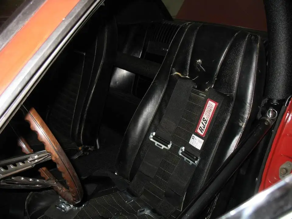

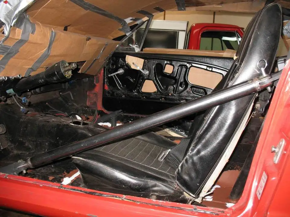

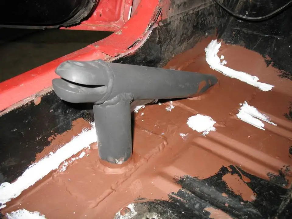

A good hinge kit will make most 6 point roll bars livable. I used the good Chris Alston hinges and love them (old tall guy with bad back.) Hinged bars are legal down to 8.50's or so. I can remove my bars in less than a minute if I don't want the inconvenience.
You can read about my adventures in installing my roll bar last winter here:
11.50's no more--Legally! - Ford Muscle Forums : Ford Muscle Cars Tech Forum
