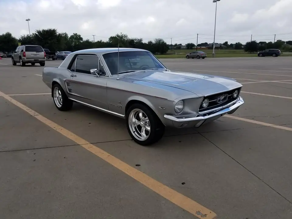

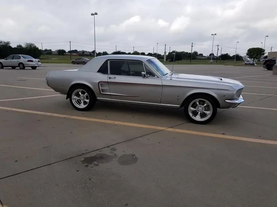

This is a 289 car with what looks like relatively newer suspension pieces and stock setup. I bought the car about a month ago as a project car (pics attached) and it feels like the steering isn't adjusted right. Wonders on the road and doesn't return to center. I thought I would do the Shelby drop and re-align the car per DazeCars recommendations. I'd like to upgrade to the Borgeson power steering or even rack and pinion at some point but not in the budget right now.
