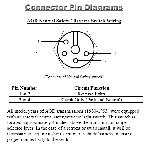

I am doing an AOD swap and will be splicing the existing NSS to connect to an aftermarket Shifter. The existing two prong (trailer type) switch has a black wire and a blue wire. I just want to make sure that I connect them correctly. The AOD has a four prong switch that I need to splice into the existing two prong (c4) NSS. Any help would be appreciated.
Thank you
