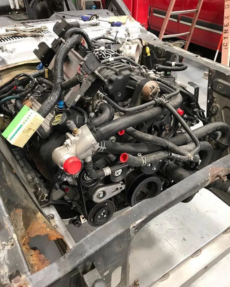

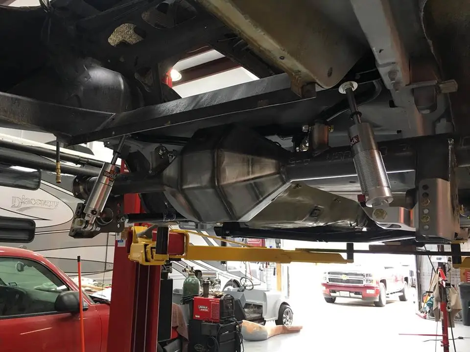

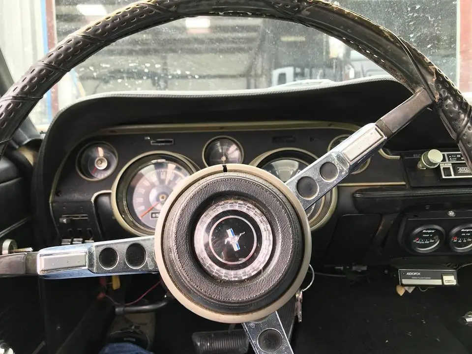

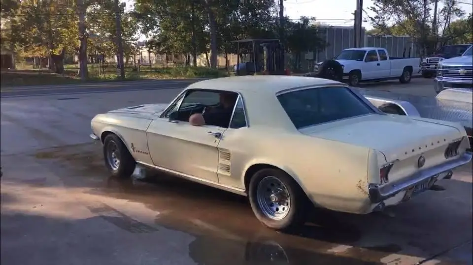

I started this project back in November of 17 and have been working on it since it was a $5,000 car with two rust spots and you can't fit more than 2 fingers in either of em

Nice, can we get some details about the build? whats the plan with it are you building a streetcar or a racecar??
That does not look like a 302 under the hood, I assume this is a gt500 swap yes?
Yes it is a 08 5.4 gt500 in it with a protouring pack from total control parts it is a street car that will be happy on the track as well but mainly a daily driver.
