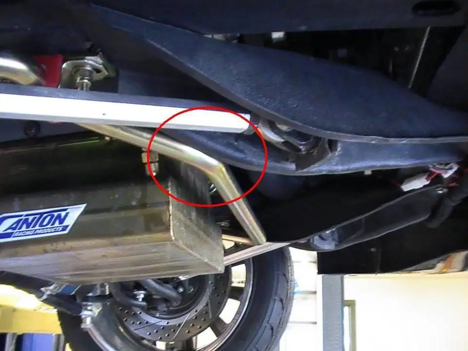

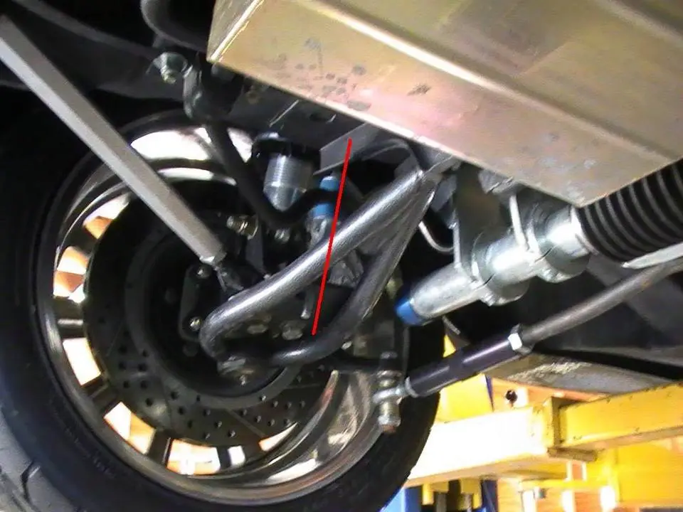

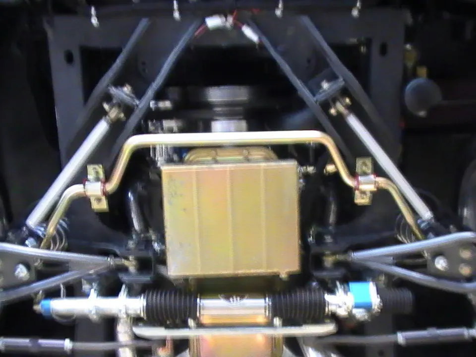

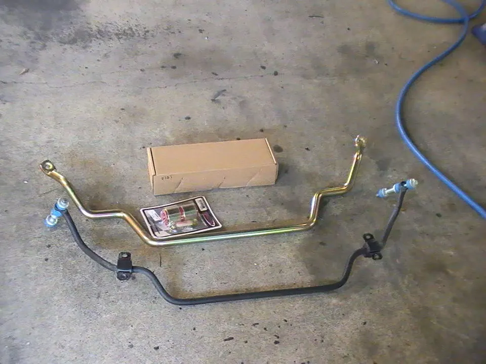

I replaced the factory front swaybar with a 1" from NPD. Factory was either 5/8" or 11/16". The kit came with 1" mounts, which I did not know. I purchased this 1" bushing kit.
The factory swaybar causes the end links to be tilted back, when used with the coilover suspension (see pic).
I heard you would have problems using a 1" swaybar with an FE. I seem to have no clearance issues. Only problem with this bar is that it does hit the frame when the tires are lifted off the ground. So this should only be a problem when I pull my General Lee "jump the river" trick.
I used the old end link bolts and had to shorten the bolt spacer in the (middle) about 3/8".
I have a 1 1/8th sway bar under my FE on my 70. The main issue is your oil filter will get crushed by the sway bar. I used a relocation kit and so far I have been fine without any clearance issues with the stock control arms. Mine is a magma purchased form mustangs plus years ago.

Maybe that is what they were referring to. My sway bar would have to break loose on the passenger side, snake around the front, up under the drivers fender and SMACK the oil filter to do any damage to it! :D

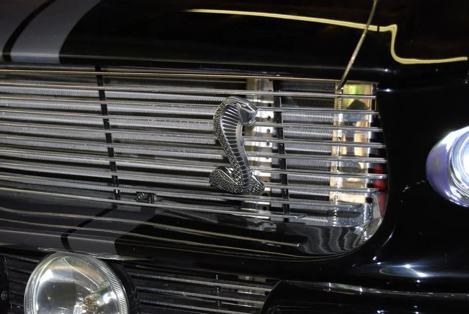

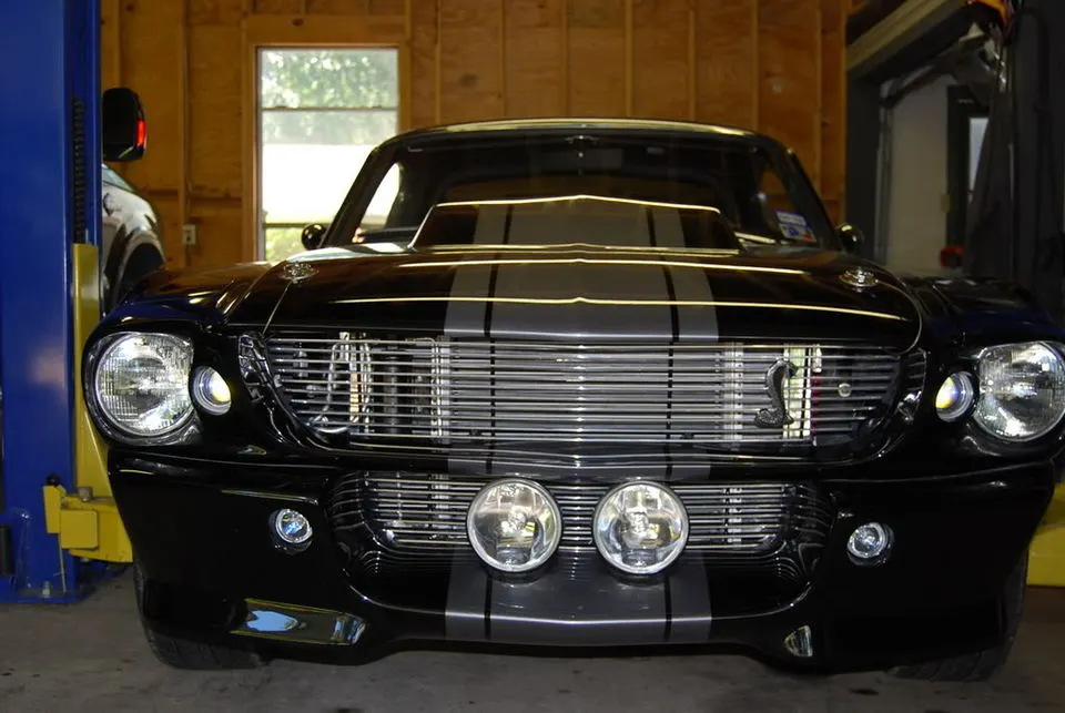

And I made the piece from the radiator to the grill

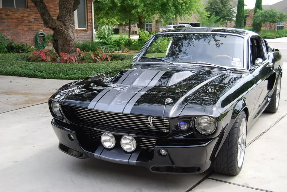

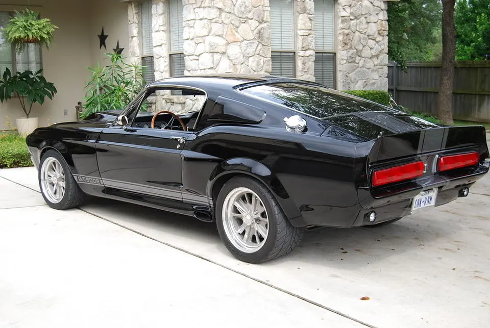

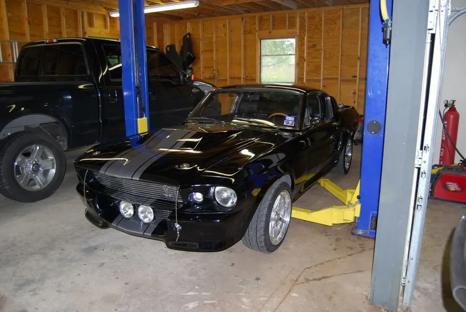

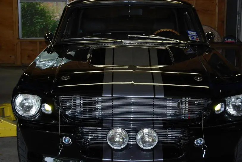

New Pictures
Got her up to a buck 20 (for you guys that dont like street racing, that is a 120 miles per gallon). Surprisingly smooth. Quickly came upon other MGP enthusiasts. Had to hit the brakes.

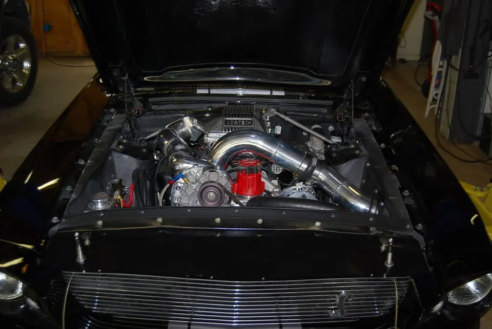

Here is some of the newer photos out of the garage:

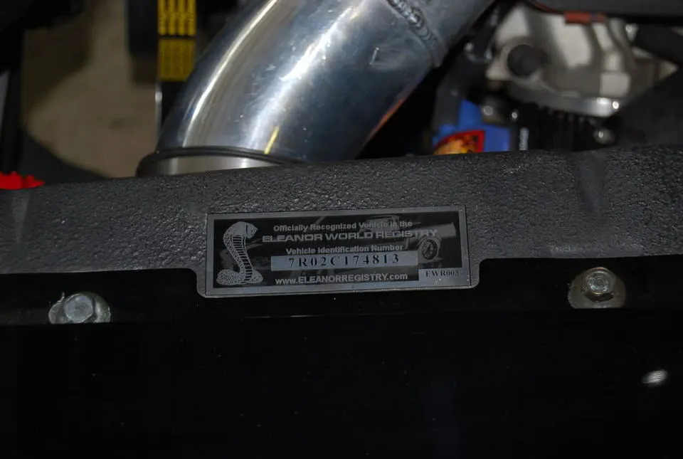

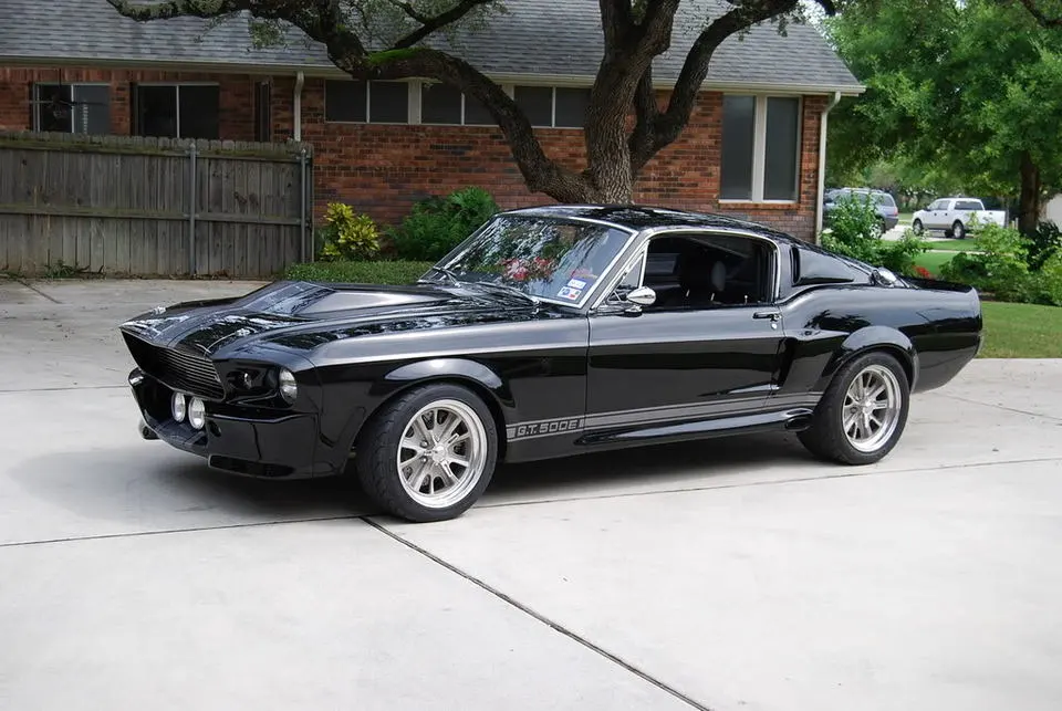

I just got my EWR plates and installed the fender tag. I am getting the door sill plates engraved later on today and will install them, also. I used 3M Plastic Emblem & Trim Adhesive. It is clear, and I thought it might be better than 2 sided tape.
I am entering Medusa in the MOCA (Mustang Owners Club of Austin) Mustang & Ford Show in Austin on August 4th from 10am - 2 pm.
27th Annual MOCA Mustang/Ford Show

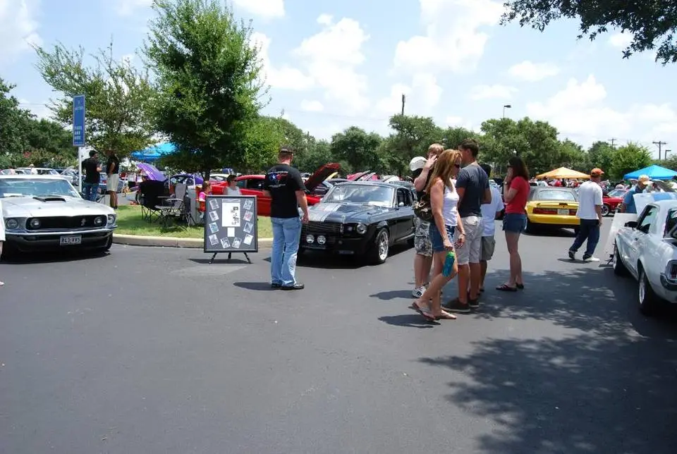

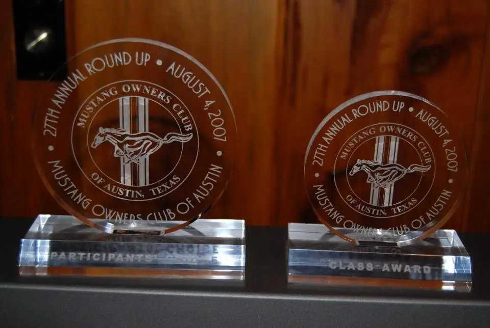

I just got back from the 27th annual Mustang Owners Club of Austin, Mustang/Ford show. I put my car in the Modified 64-78 mustang class. Medusa was an View attachment 373196 (attention whore).
She won a Class Award (runner up in class) and the Participants' Choice (everyone who entered the show gets to vote on their favorite). There were a lot of entrants and spectators there.

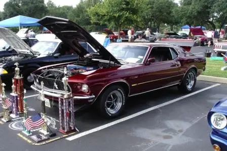

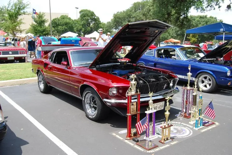

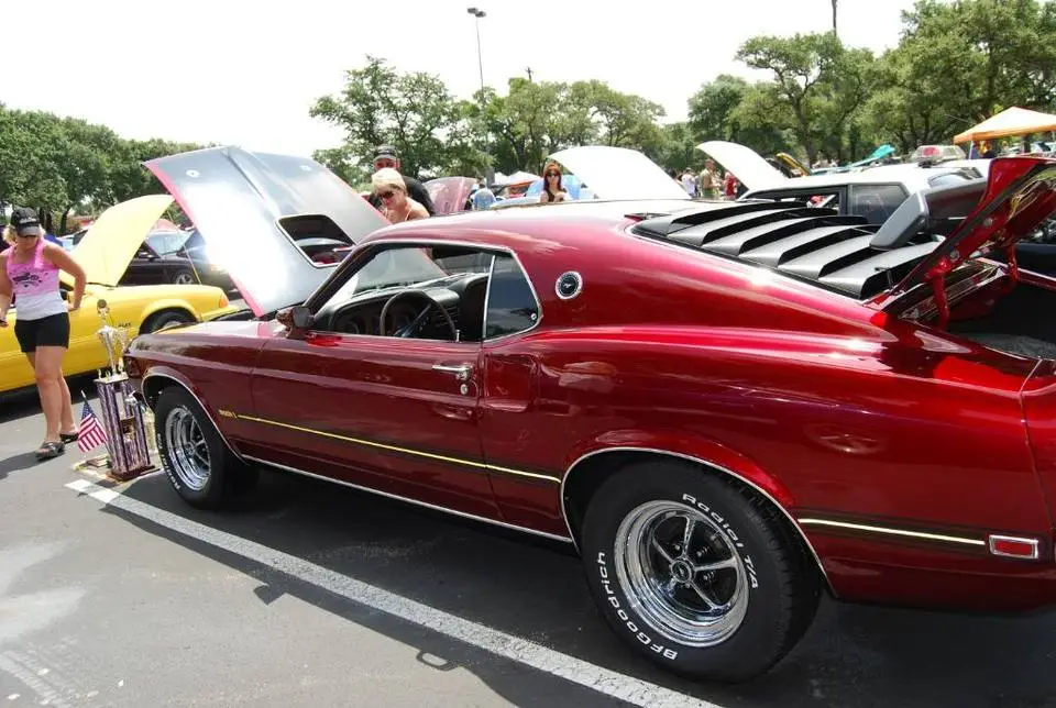

Would you happen to have a pic of the class winner? I cannot beleive there would have been a nicer car there, period.
Here is a photo of the class winner. The car was slick, and trust me it was a tight class. Normally I own the class, but there were 4 cars better than mine.
