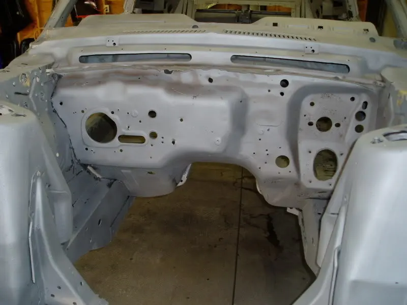

I am finally able to get started on my 67 Super Snake Project.
Sent the car off to the media Blaster 5 weeks ago. Got it back yesterday. Nothing but virgin metal :jaw:

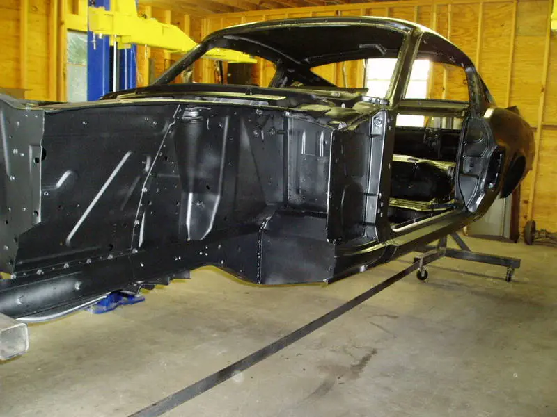

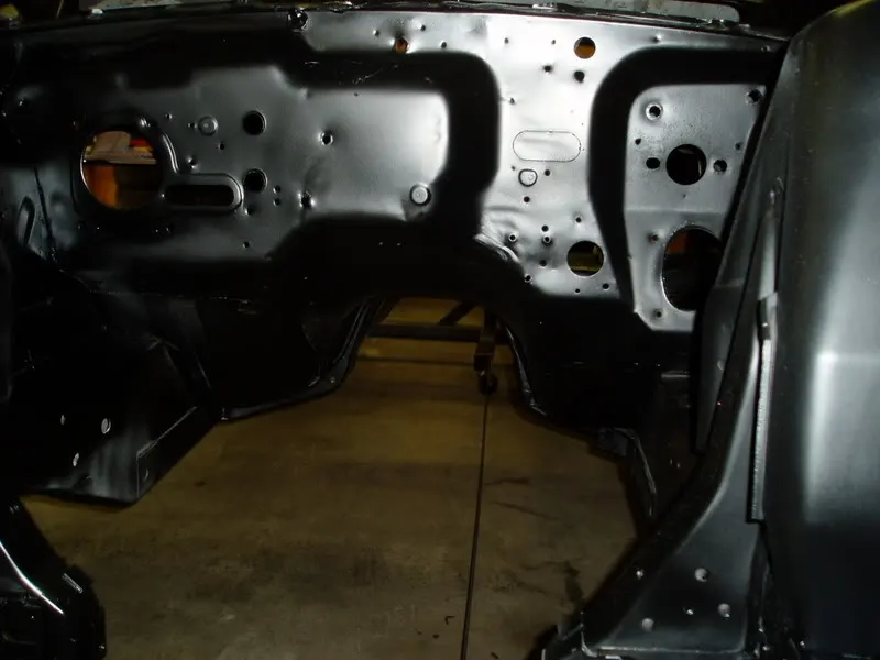

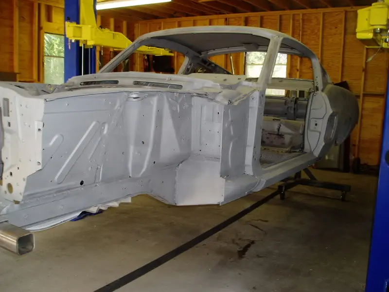

Epoxy Primered
After much thought, I decided to go ahead and epoxy primer everything. No sense in having to remove all the rust again. Plus it makes me feel like I have accomplished something :)

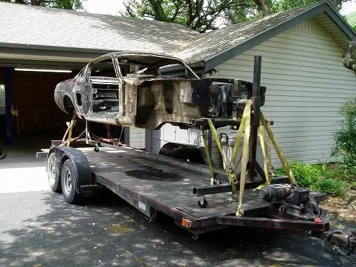

Was your car on a trailer heading down Interstate 65 in Alabama Sunday?
I saw a 67 or 68 primered shell but I was headed north and it was headed south so I didn't get a good look at it. BTW it looks good.

Question: Did you cut those two long ovals near your cowls at the top of the firewall to gain access to the dreaded cowl area without having to drill out all the spot welds?
I just went and looked at my '67 coupe and I don't have those holes...
Just curious. Thanks a lot! :nice:
Cooling Vents
Yes I cut them out. Two reasons, one to gain access. And two, adding a little more cooling for the engine. Unique Performance, who builds the Shelby authorized 427 Super Snake, reports an additional cooling of 6-8 degrees by adding these vent holes. It uses the high pressure at the base of the windshield to force air down through the cowl and into the engine bay area.

JC6715, be aware that if you use your interior vents you'll be pulling in some very warm engine air too.

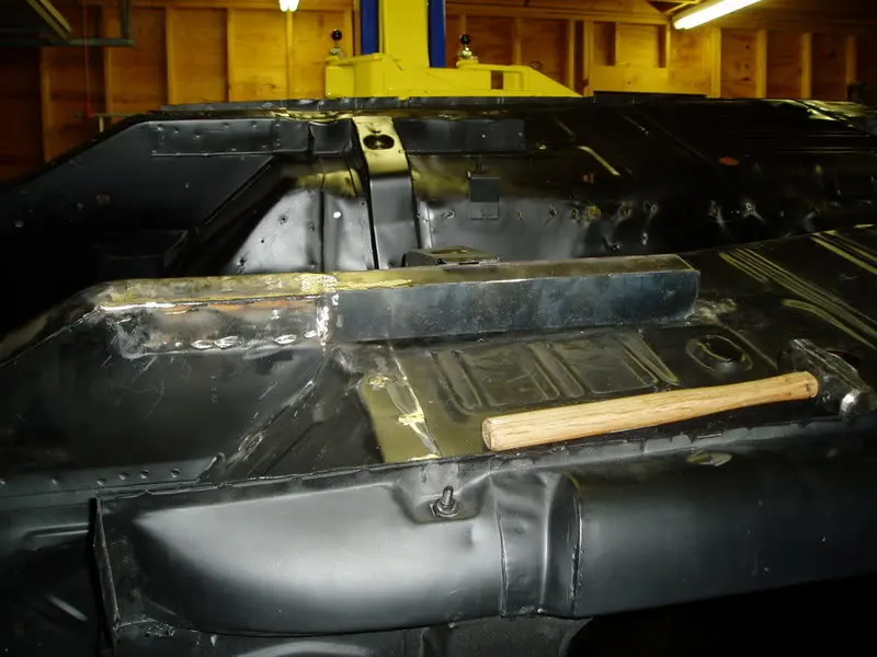

I went ahead and extended the front frame rails toward the rear with some heavy gauge metal. Then I will install the inner floor supports over the heavier duty frame rails. This is the point that the Sub-Frame brace will attach and tie in to the rear spring mounting point.

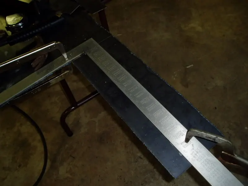

I fabricated the rails using a plasma cutter and a square to guide the cutter for a straight cut.
