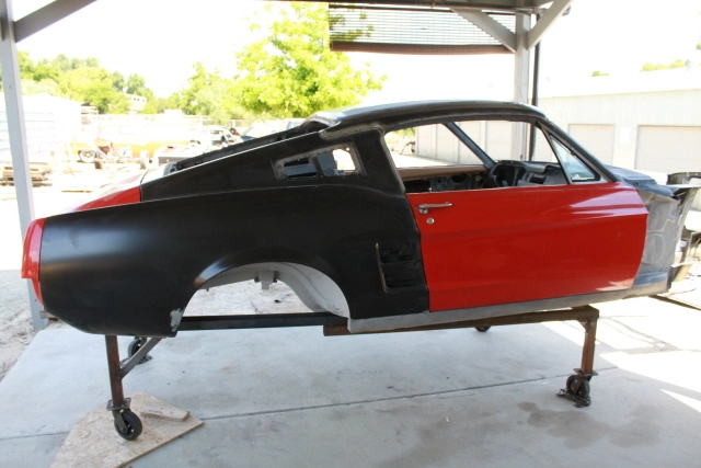

if its half way decent thats a deal, i have been fighting this 67 fast back
roof all day the dang thing dont want to let go ,some wise ass at ford
spotwelded the crap out of it ,like every half inch the blaster whiped them
out to were i cant find them,i have been working on just removing the roof
for about 8 hours now. its only going to take about 30 minuets to put the
new one back
yea there was quite a few spot welds on mine too, the worst part was that they got a lot of them so far back on the lip it was hard to use the spot weld cutter and I had to use the cut off wheel on it. I went throught three of those double sided bits...

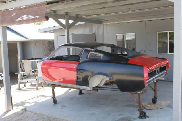

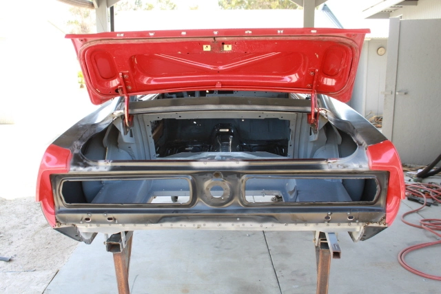

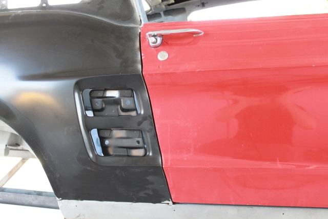

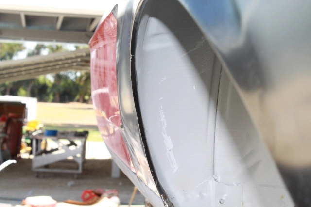

i got mine done. that was the hardest one i have ever done. if i would not have
made my spott welder work again i would probably still be working on it. went
with the dynacorn tail panel for 67 cougar lights,every thing fit fairly well.
rolled the wheel lips for beter clearance

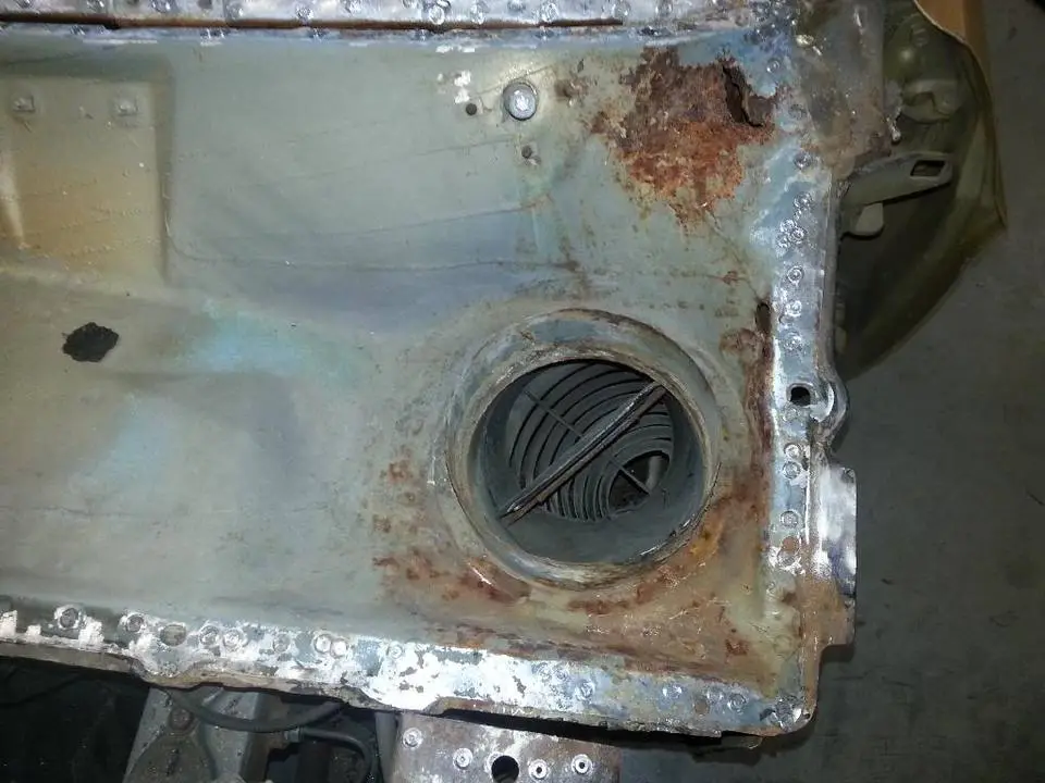

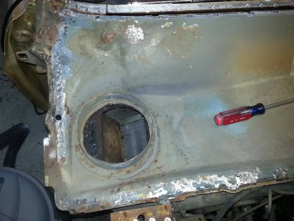

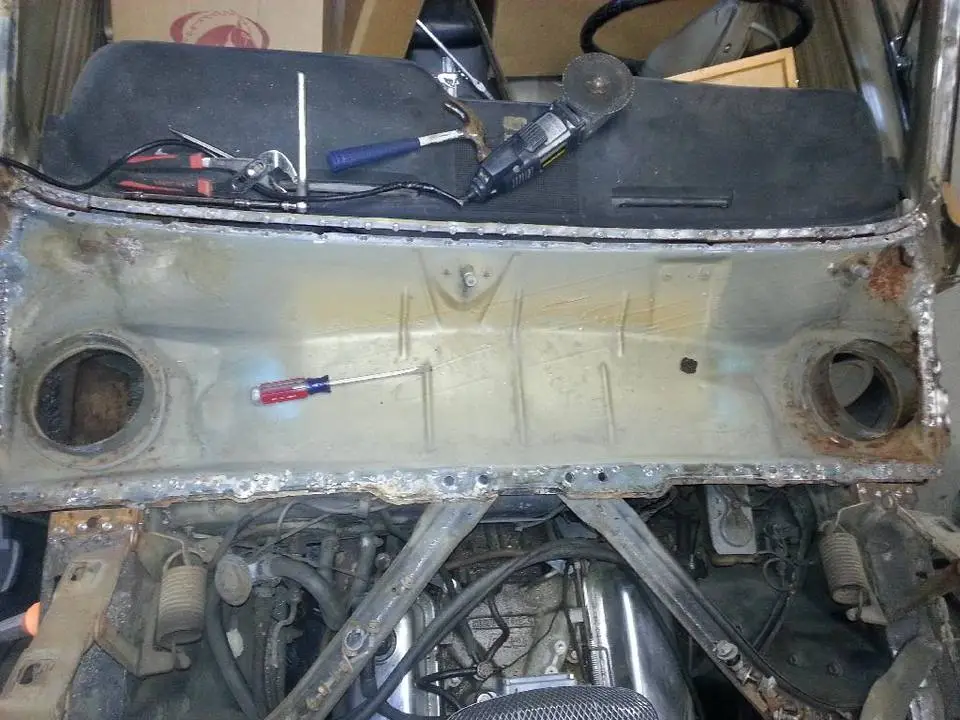

well, I got my donor roof skin sitting on my car now, just got to clean up some of the surface rust and prime it so I can get it welded up, I'll get some pics of that up later, but I also finished up taking my cowl off today, and to my surprise, it's a lot more solid than I thought...
