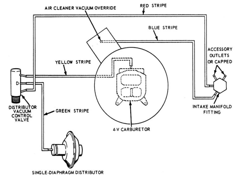

About the idle control valve that's good info to know. I had one in the original water neck and took it out when i installed new carb because the carb instructions said to hook up advance to carb. I cannot put connection in heater line because i cannot leave heater valve open in summer because it will overload a/c. A/c will not be able to keep up in this heat. My heater line also has a manual positive cut-off.

didn't catch part of that last post. I do not have a place in thermo housing to put control valve. I installed a new chrome housing. I still have the old iron one and can put it back in if need be but stiil instructions on carb say to connect advance to carb. I can talk to edelbrock about it. i don't see what difference it will make as far as carb goes. It might be better to do as you suggest.
The valve has no effect on the carb, or visa-versa. One of the simplest hookups is this one, which would be quick and easy to install:
http://www.mustangbarn.com/images/vacs/68 f37.jpg
I have one of those valves I have been meaning to install. Is the line going to the carb supposed to be ported vacuum? All my original vacuum lines are long gone, so I don't have any colors to go by.

Make sure the dist. vacuum line is going to ported(gets higher when revved) and not manifold vac(drops when 1st revved).
If it an Edebrock 1405 carb the vac advance port is on the left side(higher up) port looking @ the car from the front.Not to mention it will ADVANCE your timing @ idle ,a classic mistake done by many.
