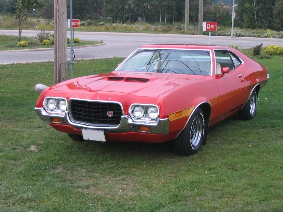

Just realized it was out of a Red Two Door Torino GT , The Starsky& Hutch lookalike. I changed the spreadbore intake for Square mount intake. I was building this up for Nascar Charger car around 92. It was going to go into a Fox Body Two door coupe style Fairmont. Then I had a heart attack and everything changed.

I've always loved '70s Torinos. Nerd alert: the above Torino is not a proper S&H car. The show and the movie used post- '74 cars, which had the bigger bumpers and slightly revised styling.
