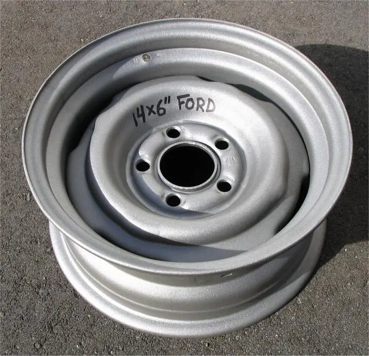

Picture of Rim
Here is a picture of the rim. I suppose the rims could be from 1967 because the car was made in september of 1967.

A September 67 build would be a 1968, not a 67, so it would have 68 wheels. You do not have 68 wheels, you have early wheels. Note the 5 "fingers" between the nuts. A 68 or later wheel would look like this "ring" in the center:
