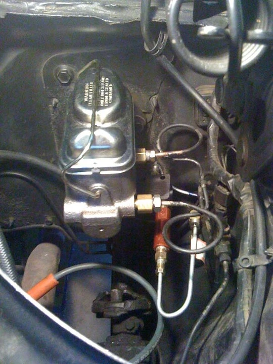

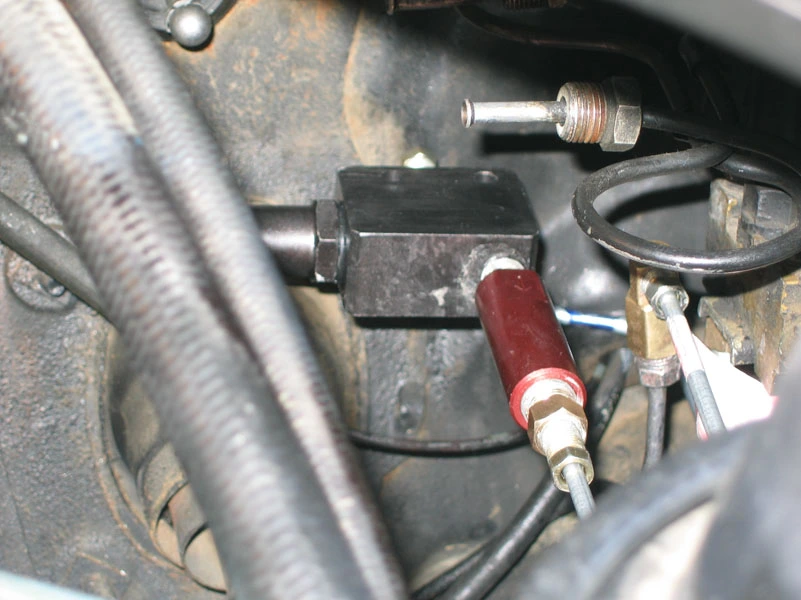

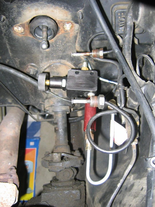

I only had to use two fabricated hard lines, everything else hooked up per the stock locations. This was to plumb in the proportioning valve. The valve is hidden under the master cylinder and is free hanging. I think I will zip tie it to the master cylinder for extra insurance. I also had a custom 90 degree fitting made to connect the line coming off the residual pressure valve to the hard line running to the rear brakes. I probably could have found a pre-made one but wasn't all that sure or could have bent the hard line better to use a normal coupler. Anyways, this was my course of action, pricey but it worked!

The OEM master cylinder has 9/16-18 and 1/2-20 ports while the one in the kit has 7/16-24 and 3/8-24 ports. I had a heck of a time dealing with this issue. I could not remove the original hard lines from the distribution block even with the use of penetrating oil and a hammer and flare wrenches etc. The only thing I didn't try was throwing heat at the connectors. I was able to purchase a 1/2-20 female to 7/17-24 male adapter fitting from Hydraulicstore.com - Call toll-free 877-778-3533 item #1053111. I could NOT find a 9/16-18 to 3/8-24 fitting ANYWHERE. I ended up buying a 9/16 to 1/2 fitting and have a machine shop turn the 1/2 end to 3/8 and rethread. This worked!! Just a heads up if you want to go my route and get these adapters done up front.

The final setting for the proportioning valve for my setup was 1/2 turn open from full closed (with full closed still allowing fluid but the valve won't close further).

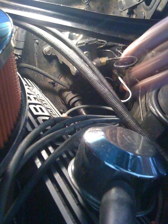

Pictures below----
Showing new tubing....
Showing final connections and master cylinder in place (note the master cylinder adapters)...
TRYING to show the proportioning valve hidden under master cylinder...

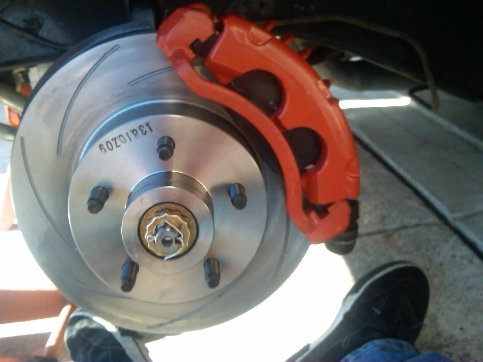

Shot of brake kit on passenger side...

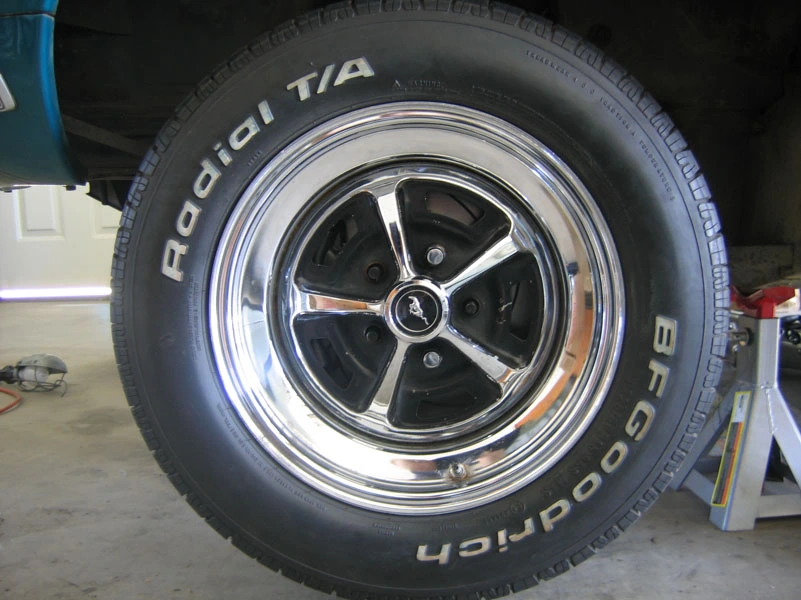

Shot showing the conversion with the Magnum 500 wheel on...

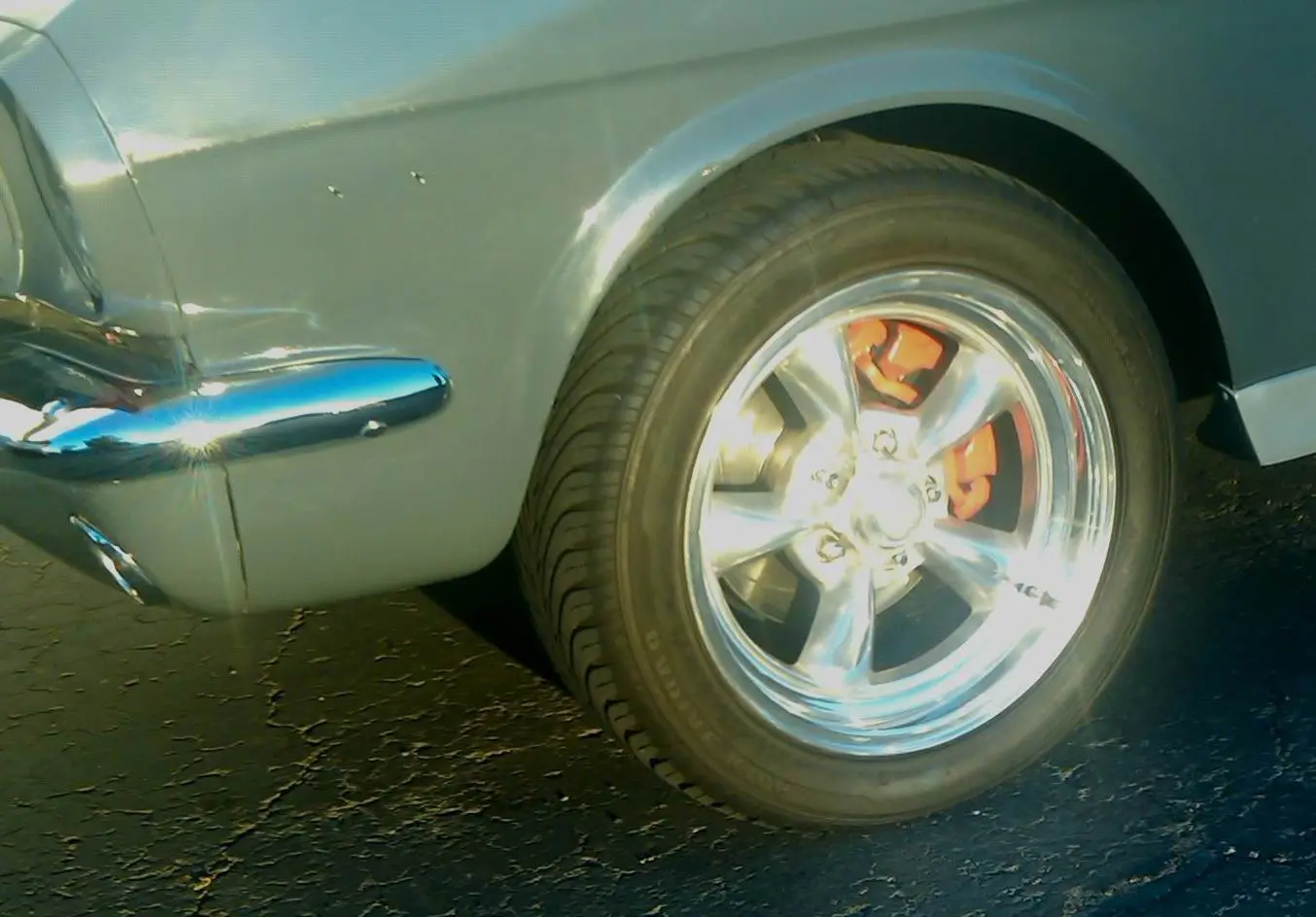

im in the process of installing the 08 gt brakes on my 69.... great kit... they almost dont fit inside my 17 in torque thrust rims... i painted the calipers red with ceramic paint... and i just bought a ford racing proportioning valve and dist. block plug. i have a fox booster and a 95 v6 master cyl... i just got 20 feet of stainless tubing for my fuel and brakes... soooo now i have to finish fitting the clutch and brake pedals in and complete the system... ill try to do a write up when im done...
