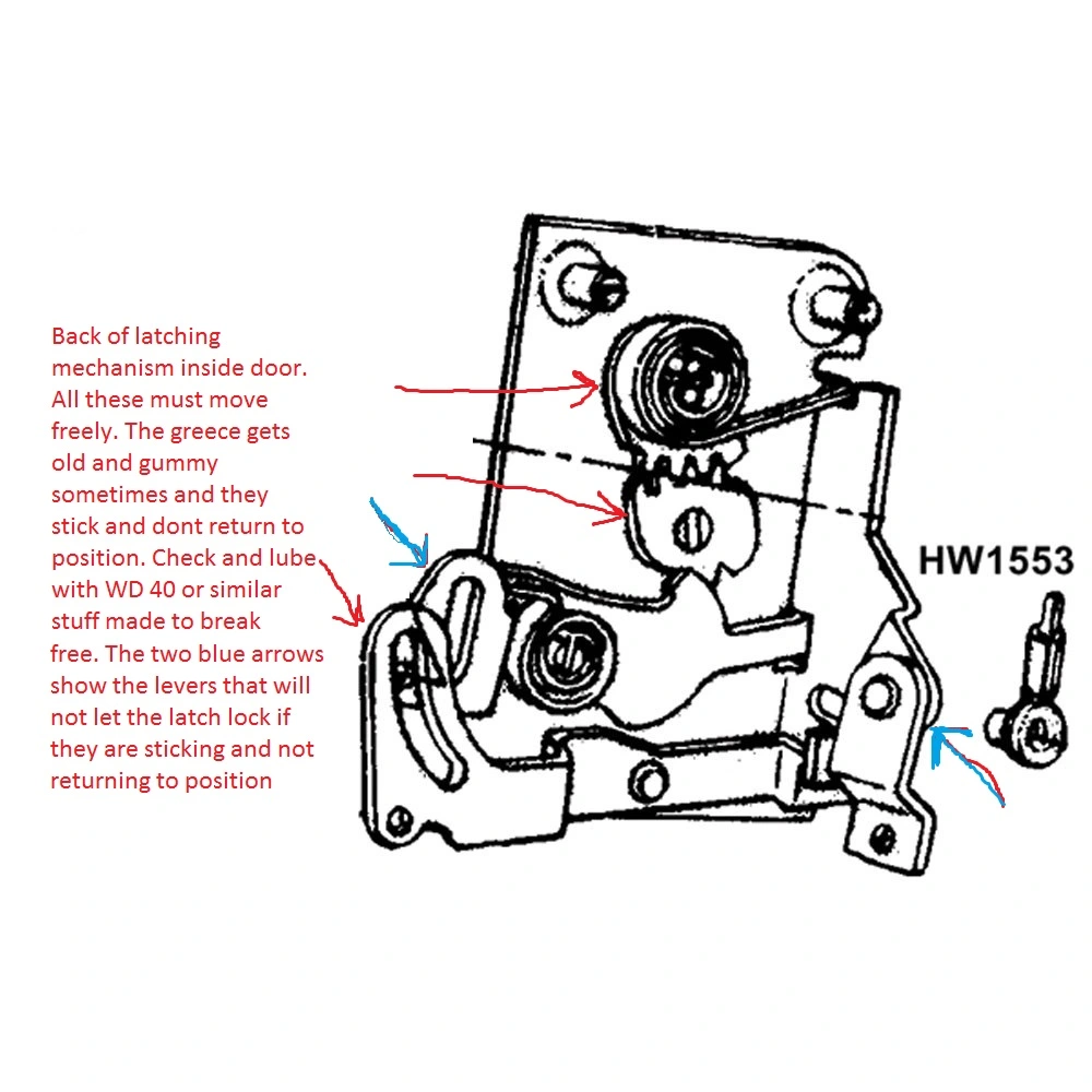

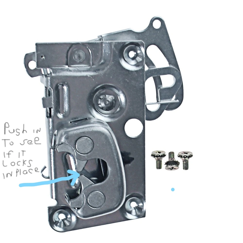

1. First would be gummed up door latching mechanism. You can roll the window all the way down and saturate the mechanism and door handle (exterior handle) with wd 40 or similar. Manually try to latch the latching mechanism with door open with a screwdriver and see if it locks into place if not you can look from the top side window opening and watch the operation while operating the door handle to see if the arms on the latch move properly. You could also remove the door panel for better view.

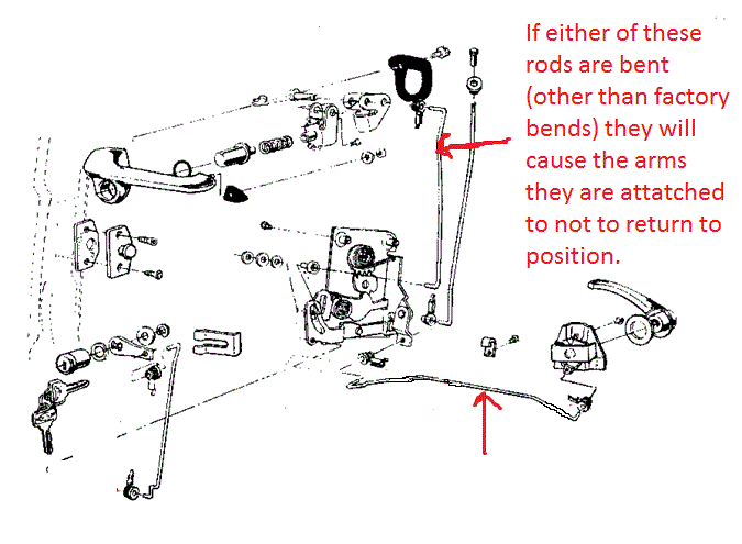

3. Bent rod inside the door from the handles (inside handle or outside handle) to the latching mechanism. - Pull door panel off and check the rods and straighten them if bent.
