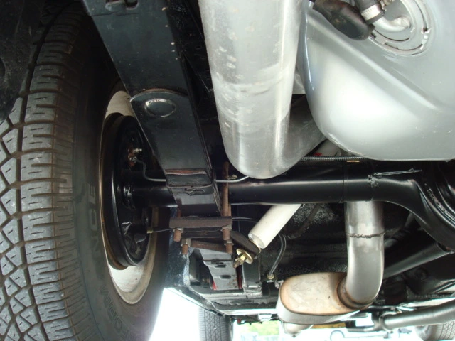

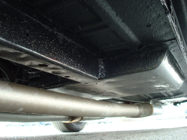

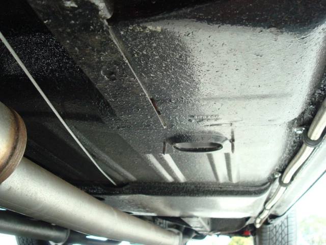

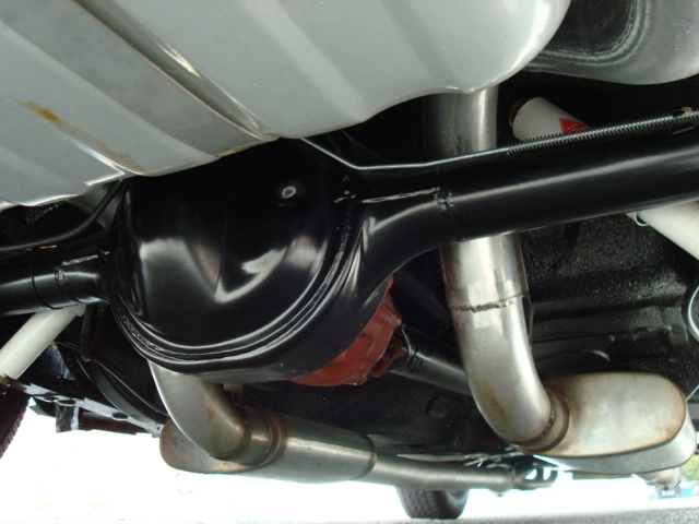

I have a 71 cv ill post the exhaust pics i have hope it helps.

Thanks, not much different from below. Do you have any issues with the exhaust being below the frame? Any power issues with running a straight thru dual exhaust without an h-pipe?
To be quite honest.im not savy enough to notice powerwise.im learning though.i havent had any problems that your average person would notice power wise.i actually inherited the car from my father.as for it being below the frame no issues as of yet.there are a few parking lots i have gotten nervous in that had high speed bumps.im not sure why he chose to run the exhaust that way.im guessing when the old engine was gone.the big block 521 crate motor that was put in it may have had clearance issues.
