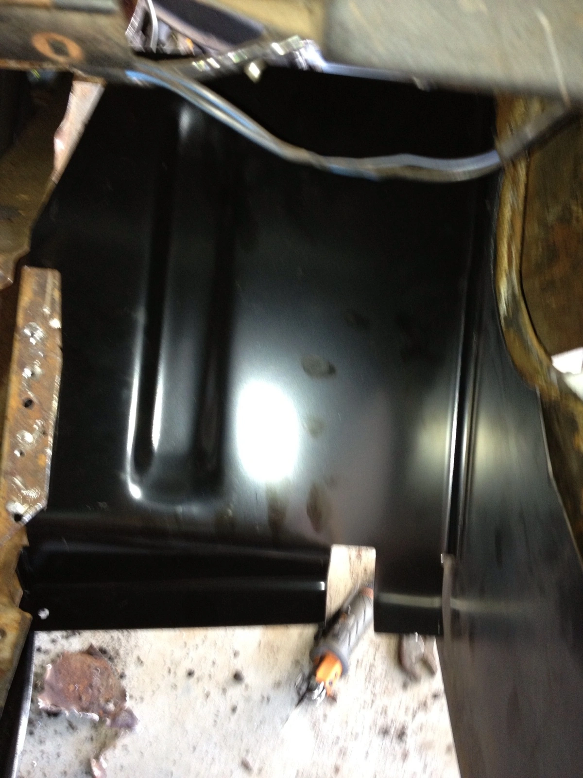

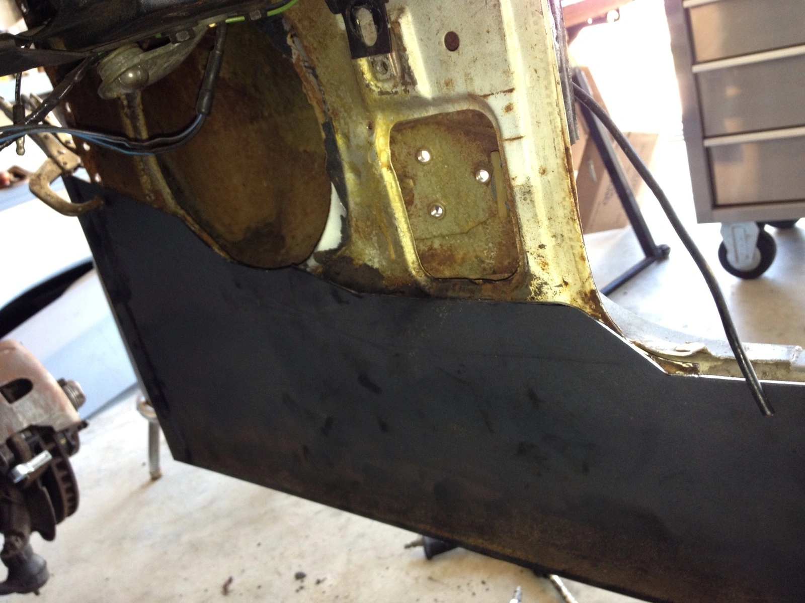

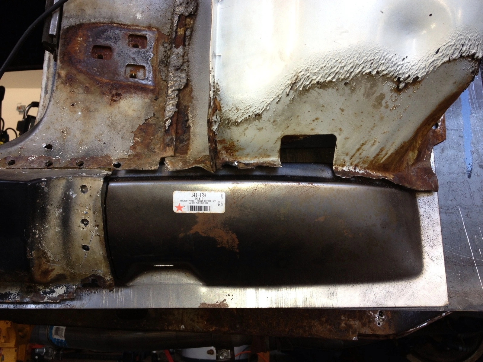

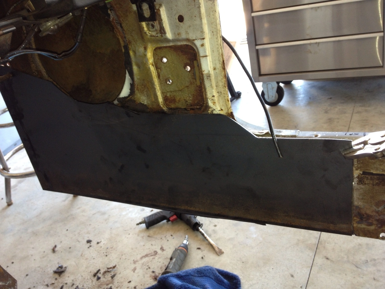

I have formed the patch that will cover the inner cowl and inner frame rail. I have dry fitted the forward rocker panel extension and torque box. The floor pans are out for epoxy primer and I should have them back shortly.
I have ordered a firewall extension and from the picture it looks like it will work. I discovered that there are several varieties.
Next is the fitment of the toe board, which from my initial trial fit, will need some modification.
that should look great when all welded in .with every thing pre fit it shouldn't take long to weld in. the torque box hides most or the patch. toe boards are usualy over sized for trimming . is that a home depot air chisel .i have been thinking of tring one, my lowes chisel just quit .i just bought one of the 90 degree grinders from Home Depot and it is so quiet it doesnt even sound like it works but it does.
Thanks I'm doing my best. That is a Home Depot short stroke air chisel. It works great and was very inexpensive. The make a long stroke model too although I'm not sure of the advantage.
i would think you could control the shorter stroke a little easier than a long stroke. my Lowes chisel just stopped working, it didn't work all that great in the first place .i will have to give that one a try.

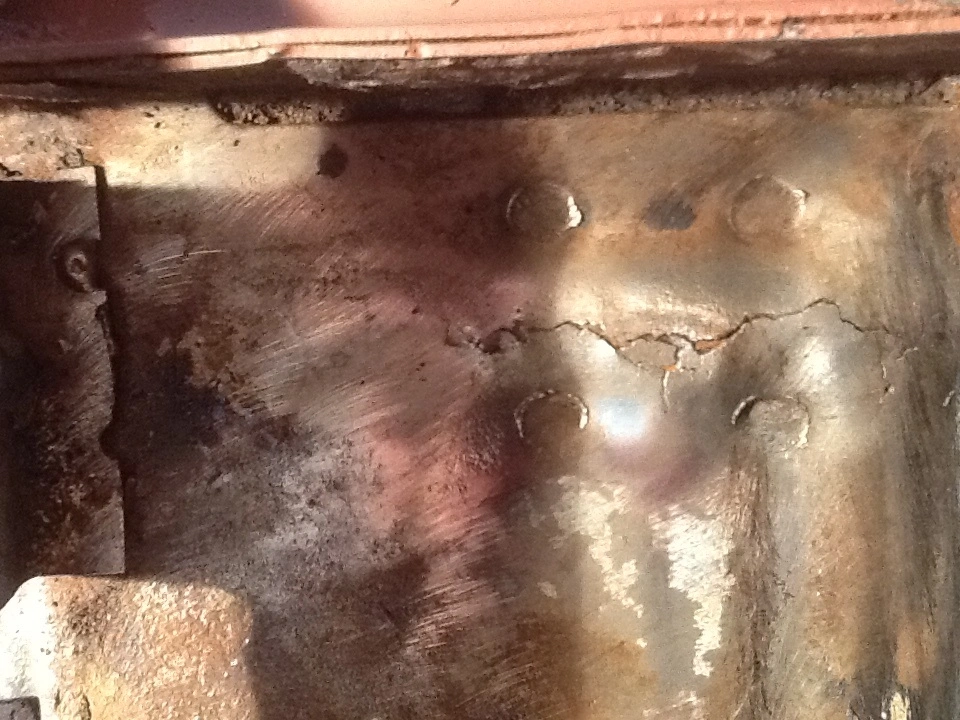

image.webp image.webp While sanding the interior for paint I Found this crack. It is on the right side just forward of the wheel house. From the bottom it appears to be just outboard of the front spring perch. No rust just a crack. Thinking of just running a bead of weld . What are your thoughts?

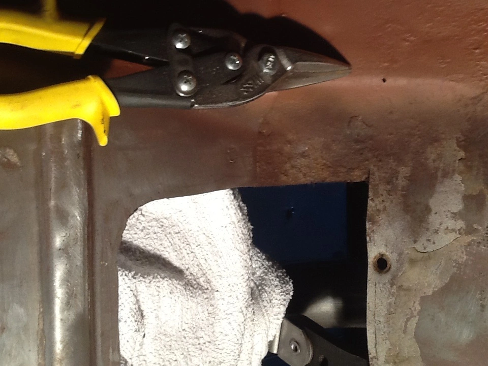

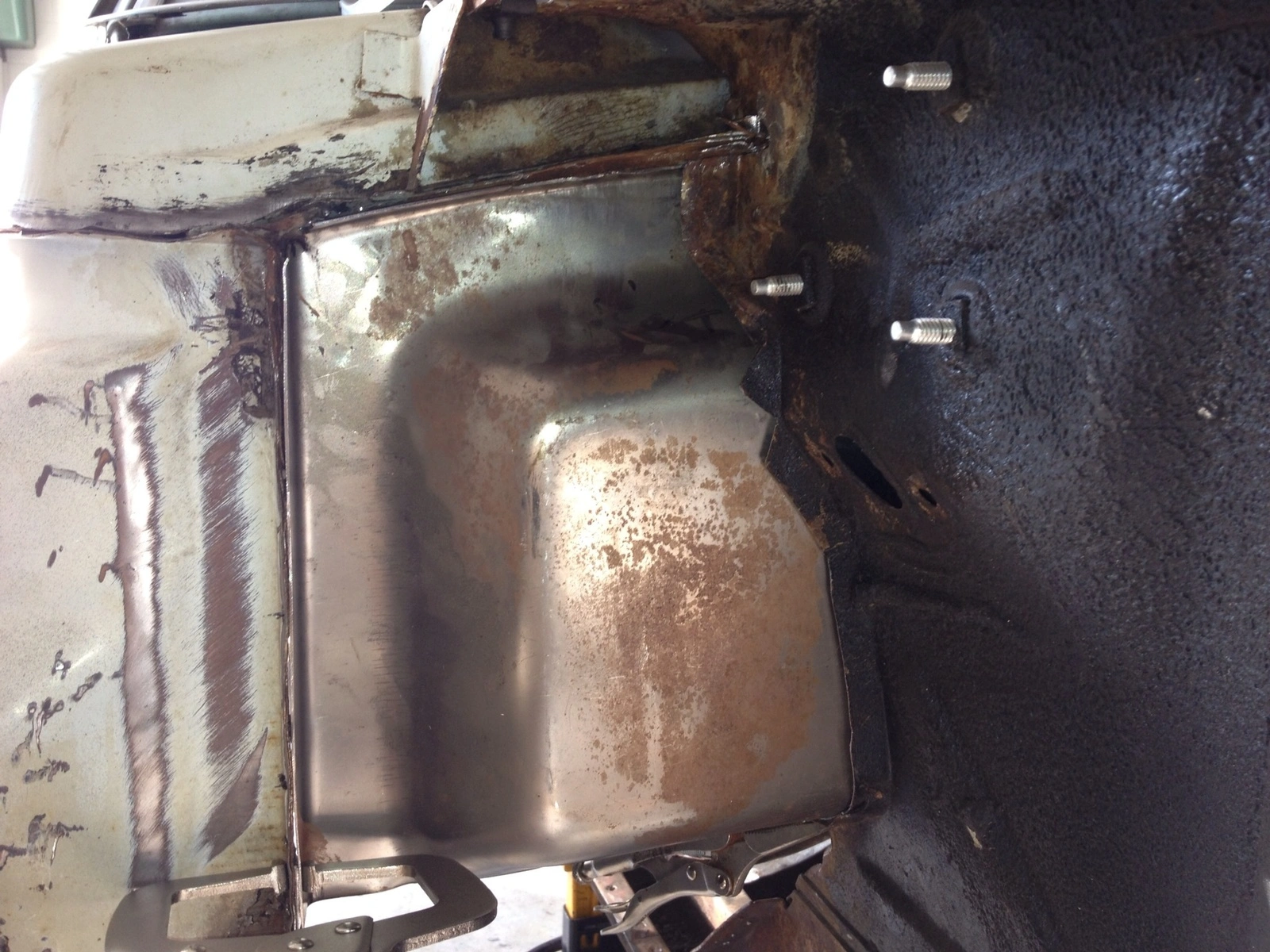

This is my last repair, I hope, on the passenger side before welding. I discovered rust under the rear seat and ordered the repair panel which I have cutdown to repair the flat area under the seat. The problem is the rust continues into the trunk floor transition I can Handel th flat area but the compound curve shown at the tip od the snips is posing a problem. A repair panel is an expensive option to snip out just one small piece for a patch. Any ideas will be appreciated. image.webp
