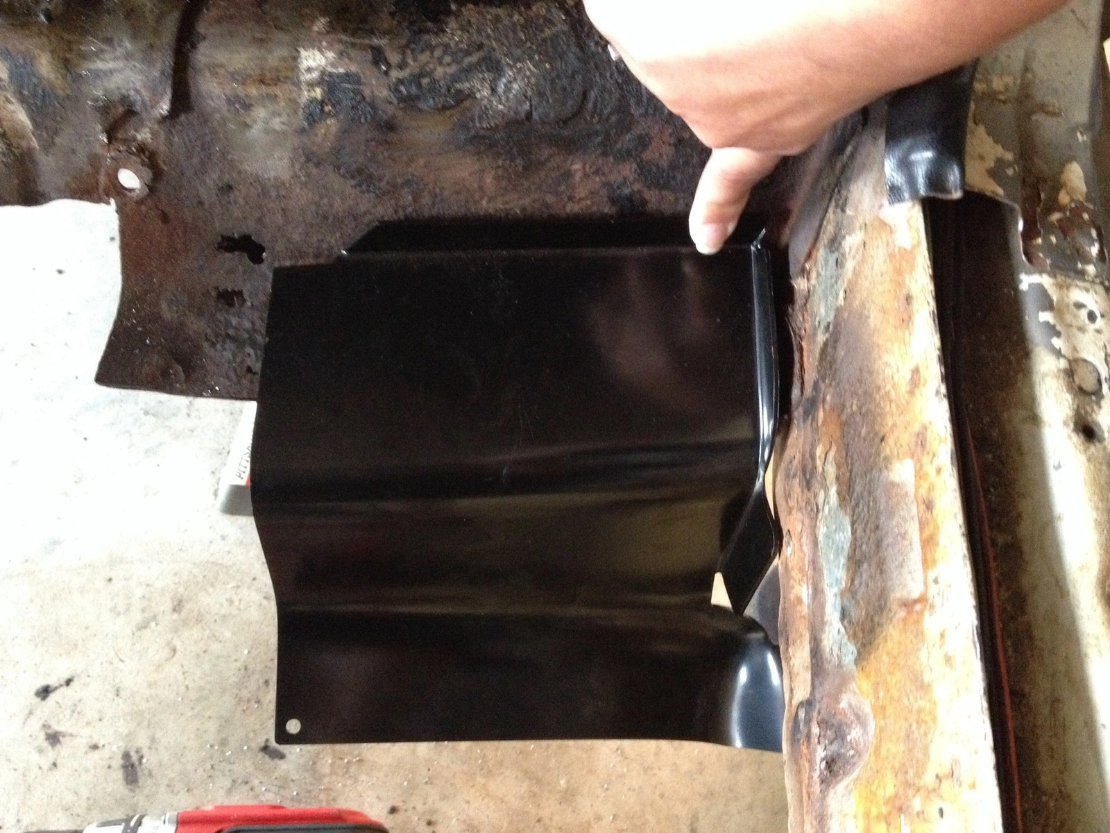

I appears that the upper rear torque box cover is about 2 inches to narrow. It is out of place in the picture to show length difference. Is this a piece that needs to be modified or is a wider one available?
