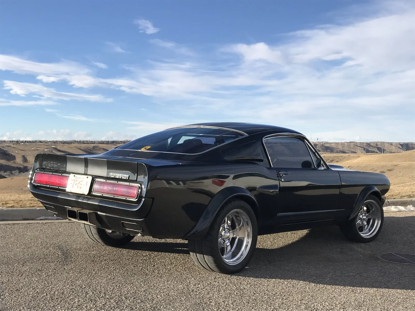

Anything is possible with enough effort, I made it work on my 65, it is extremely tight between the fuel tank and valence, had to narrow the exhaust “manifold “ from pipes to centre. And fill the license cut out in the rear bumper. I am very pleased with the outcome, and is the only 65 I’ve ever seen with center exit exhaust
