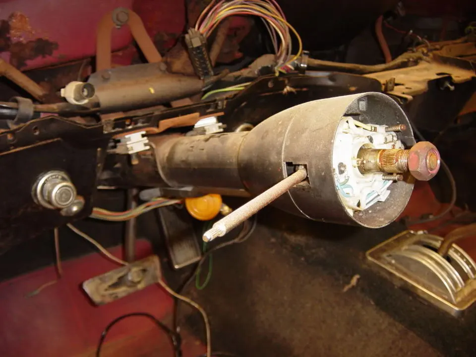

Here's a pic of the column still connected:
You can see the plate wraps under the column and bolts to the support where those white plastic nuts/spacers are.

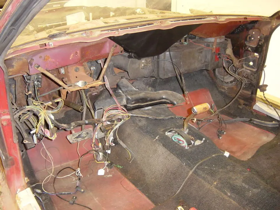

Here's a shot with the lower dash removed so its just the column and pedal support left:
Note that the bolts for the column plate have been removed - they are on the floor in that photo.

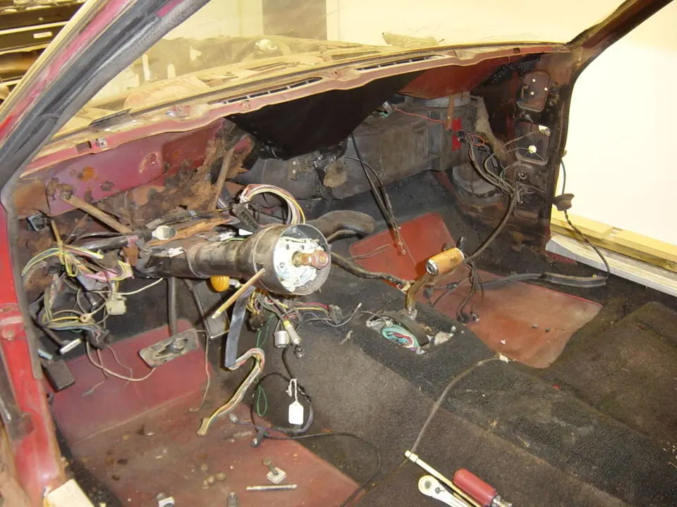

Here's a shot with the column removed:
