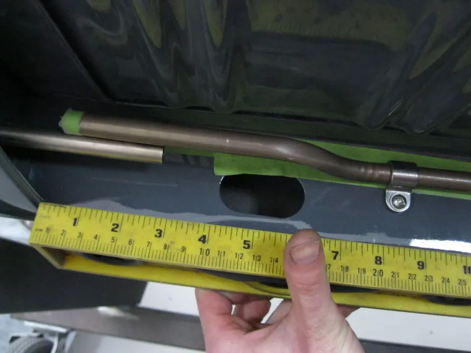

Next, front rail was not replaced but hole for clip has disappeared. :shrug: I poked around with an awl but cant find. Picture with measure anyone? View attachment 65210

this was the stock front floor extension and hole for the clamp (clamp is not stock either).

As it turns out. The new SS fuel line was formed with an extra U shape which does not allow using the existing under rail clip in the factory location. Basically the rail follows the outside of the rail and goes past the front centerline of the tank and then wraps around and comes forward. :flag: Thanks for the assist yall.
