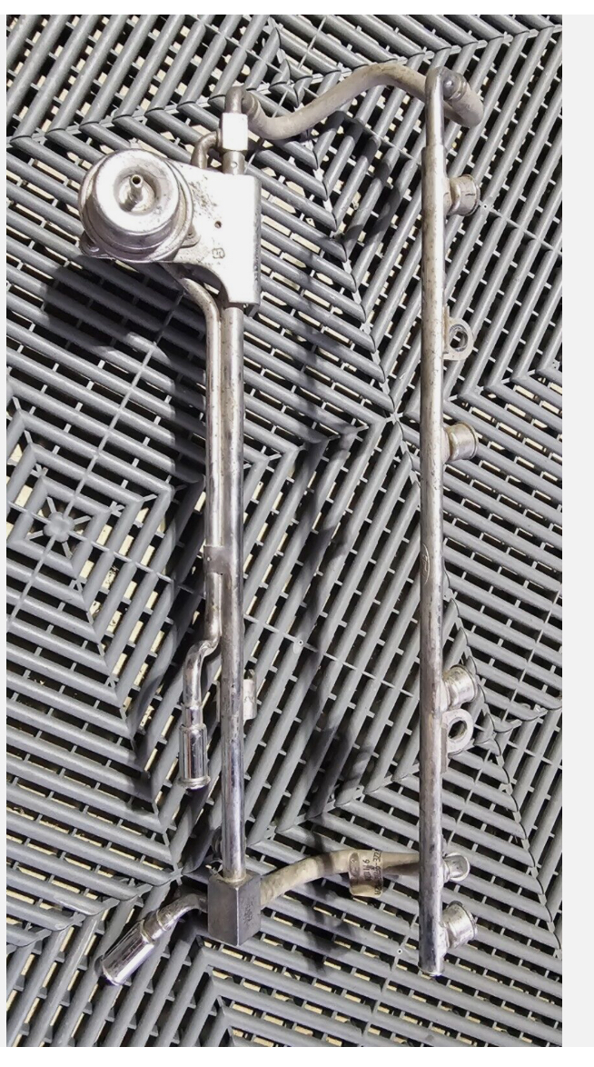

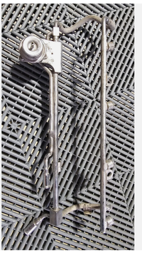

I run an explorer fuel rail on my turbo 331 car. It has rear exiting fuel rails. I run them both on the drivers side. Fuel pressure regulator is in same spot as an EFI mustang but uses the Ford Lightening FPR bolt pattern ( not specific to just a lightening ). This is what they look like.
