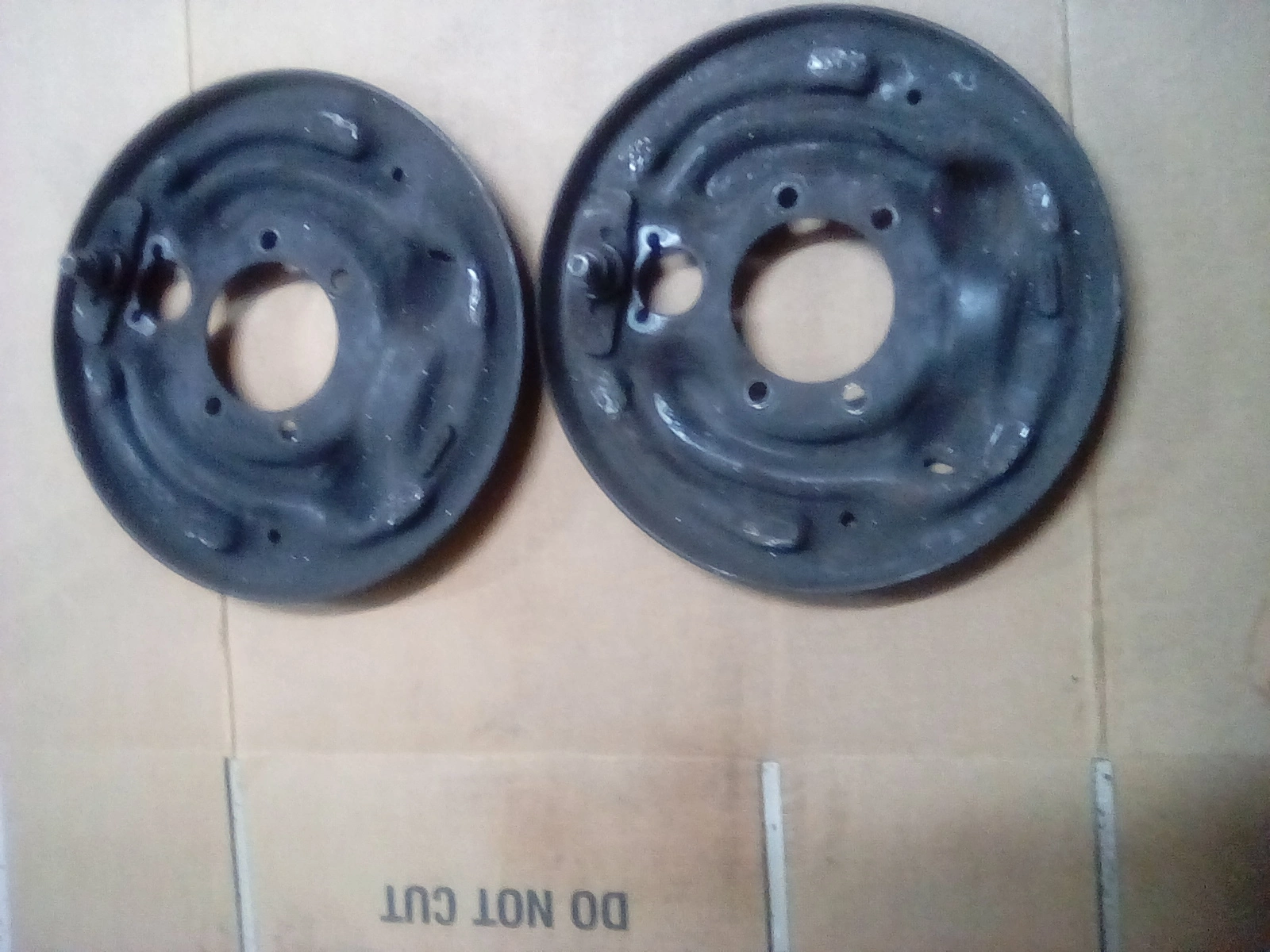

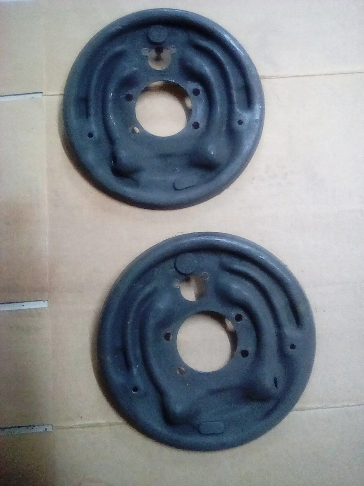

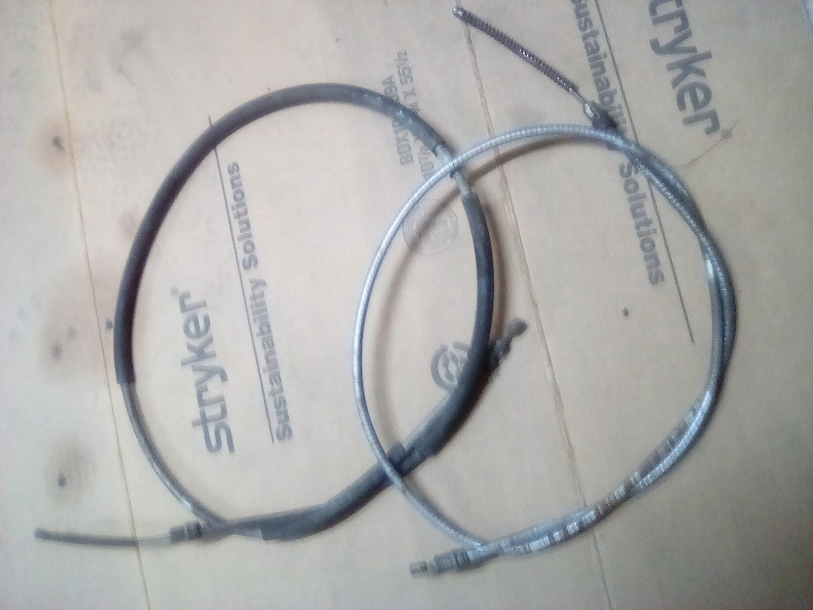

I did the cobra brake upgrade and have the backing plates and e brake cables . Lmk.
