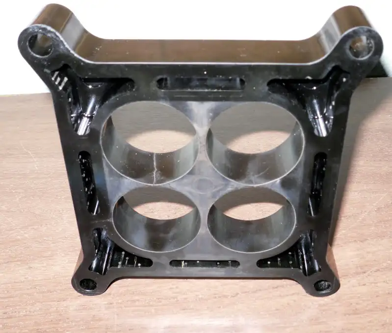

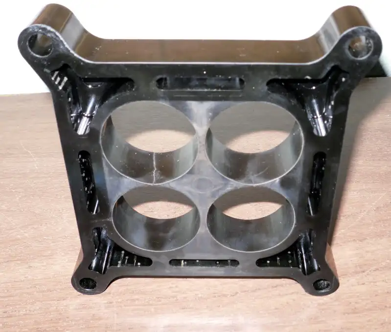

I do have a carb spacer that I didn't replace, so I figured it would be a good idea to check that gasket visually. The gasket looked fine, with no evidence of leaking. The spacer was cracked, but only on the inside (pic). I replaced the gasket and the spacer.
I tried it again and got the same thing... no idle below 3K RPM or so.

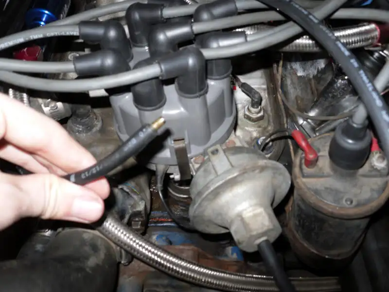

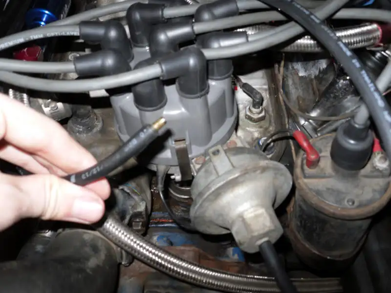

So I decided to try to cap off the lines going to the transmission and brakes just to see what would happen. No change in the idle. Although I did notice a potential vacuum leak with the vacuum advance, the nipple (hehe) came out and is now stuck in the vacuum hose. (pic).
So what am I missing? Assuming I replaced everything correctly what else could be causing my vacuum leak?

Unless I missed it you make no mention of your timing? Have you checked it? Since you stated you rebuilt the engine I'm assuming the distributor was out of the motor. Check your points, check your timing, are the wires cap and rotor new? Are you sure the distributor isn't off a tooth. Considering, your having a similar problem from before the rebuild I'm guessing it distributor or carb related, swap a new one in and see what happens
