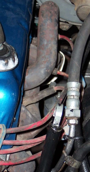

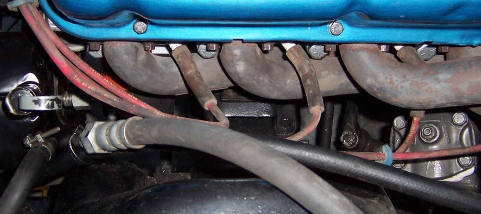

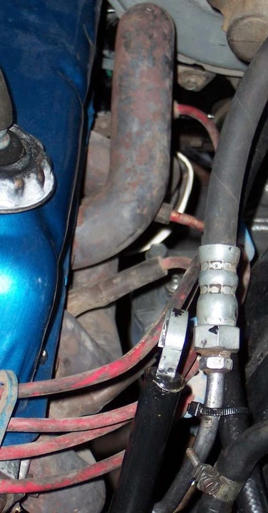

i had the same problem but i have a 351c in my 73 mach. i bought the hookers because i love the tone but when i went to put them on we had tons of problems. i ended up cuting some of the motor mount bracket and then denting one header tube. i didnt see a diff in power engine didnt really mind it much. just if you make a dent make a smooth transition with it. good luck the ps bracket lower wouldnt make a diffrence in my case.

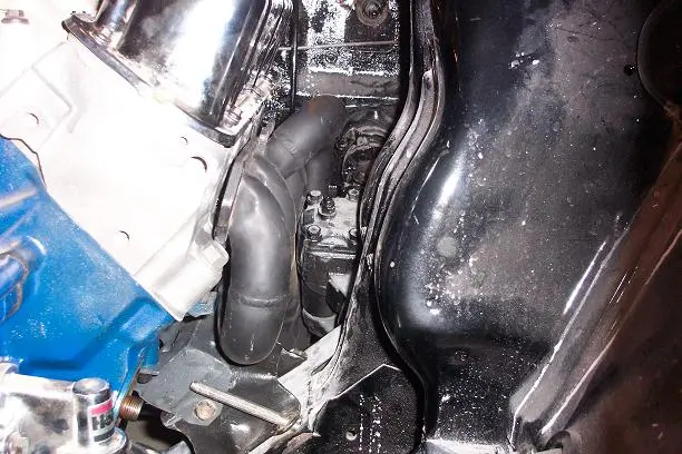

The 6208's fit! And here's how it finished. There is a tab on the steering column, I think for the steering lock in park, now it's gone. Some twisting and turing, pushing and pulling, and the headers finally slid in.
Go figure! I guess Hooker can add 71-73 to their list on these.
Brad

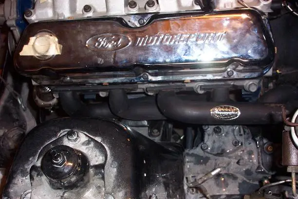

I finally got my pics up on my website so you can view them.
These are how the headman shortys look on the drivers side. You can see there are no clearance issues with the steering system.
