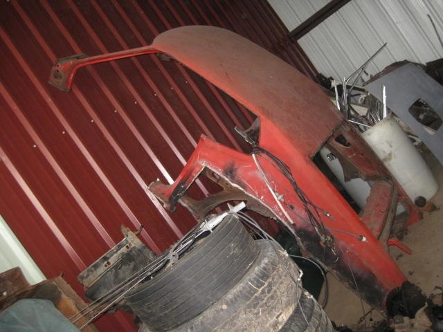

I have had my 73 coupe for almost 10 years and there is personal value to it as I built it with my father who past away a couple years ago. I will never sell the car, although it is not my prefered body style. There is a local guy who has an entire Mach roof section from A pillars to rear of trunk. I am looking for thoughts, advice, input. I know this is popular with 67-68 these days.
I am fairly competent with welding/fabrication work. I am also building this as a street/strip car so I am not too worried about interior fitment with a back seat and panels. And I am aware that pretty much all of the glass will need to be switched out.
So am I crazy or is this a sane thought? I feel confident this is possible but could be wrong.

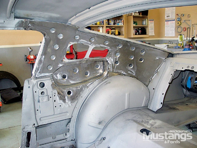

Couldnt I fabricate those inner supports? Something along these lines..
And do something similar with the supports that are inbetween the trunk and backseat area. Something similar to the picture would give plenty of structure correct?

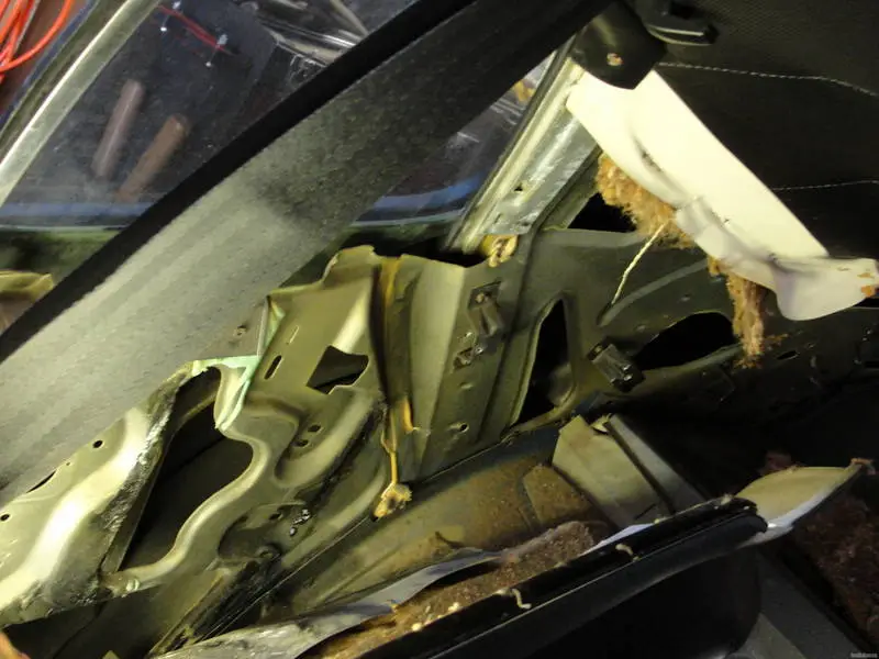

Does anyone have an image of an interior back area of a 71-73 fastback without seat and interior trim so that I can see the support structure.
I'm sorry to hear about your father, but I always love seeing people do meaningful things. If I can get everything apart easily enough I'll snap some pictures on weds.. I think this is a pretty cool project, and I don't see any reason why it wouldn't work. If the pulled it off 36 years ago in the factories, it can absolutely be done.

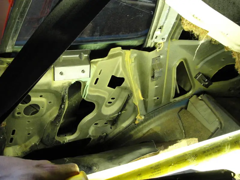

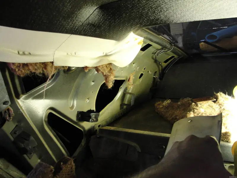

Hey man, I didn't forget about you.. I brought my camera today to take the pictures and forgot the memory card. I was able to take 1 picture but now I can't find the cord to connect it and get the picture off . I'll post it tonight if I can find the cord, but if not I'll take another tommorow. I didn't want to take the whole rear section apart because the headliner would need to come off, but the picture shows the basic setup of the bracing. Sorry it took so long .

Here ya go.. Remembered the memory stick today. The headliner is stapled in place nicely, so sorry.. you wont see that part .
