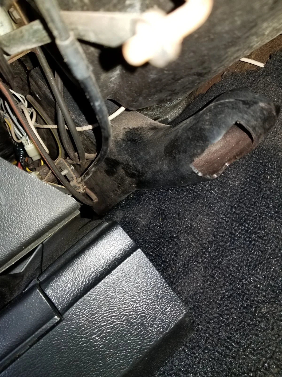

Maybe you have an idea what the attached picture is. I posted before but like my other posts a lot of views but no replies. I feel it is to get air to feet area but it is not connected to anything. It is under the dash behind the radio and tubing comes out on the driver and passenger sides. Hard to explain it. The approx 2" tubes just get larger as the in the center to 5 to 6" high, open at the top(measurements are a guess). It is all one moulded piece. Both ends of the tubing have the same rough cut out near the ends. The cut outs do not look professionally made. The picture is on the passenger side.
