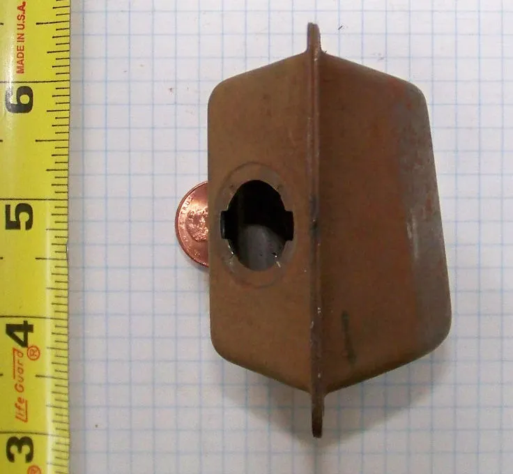

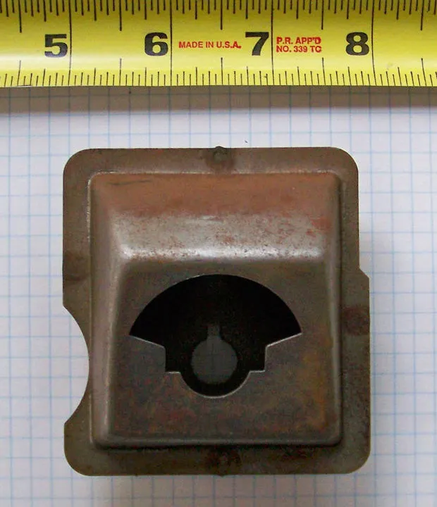

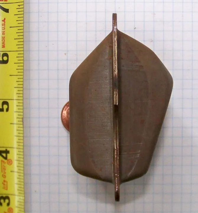

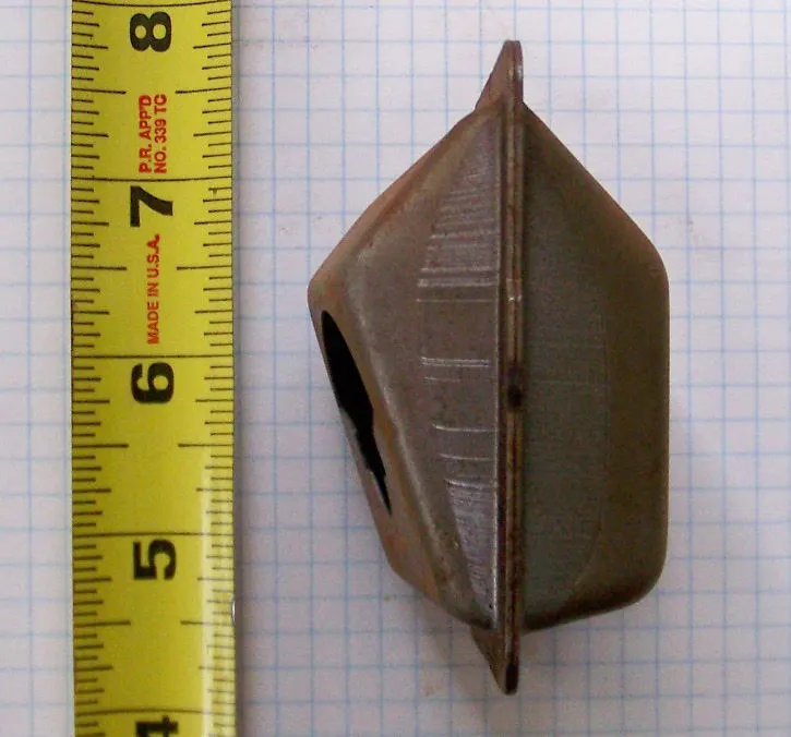

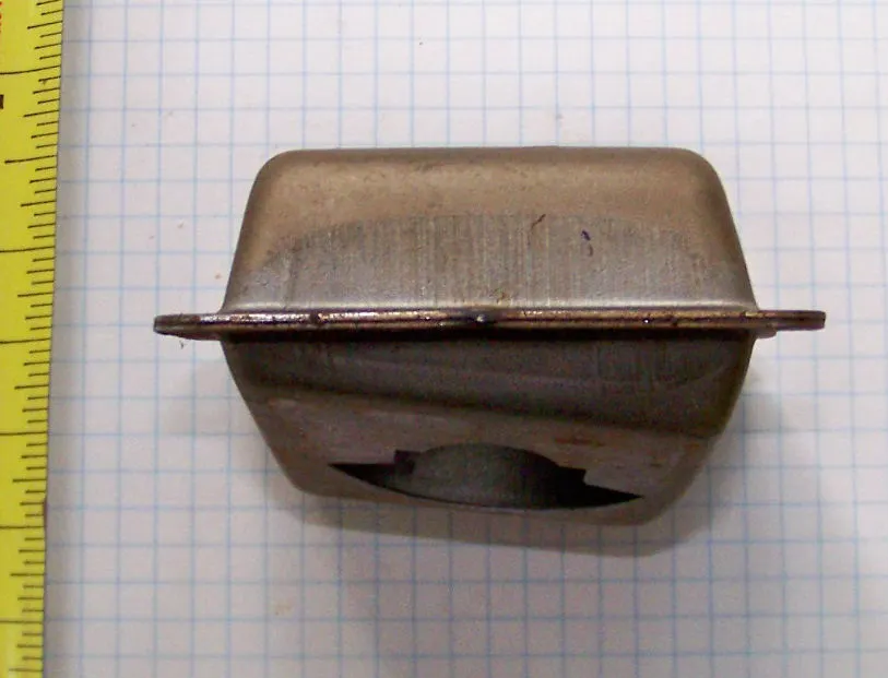

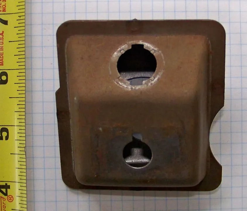

That's going to be a tough part to make by hand in any material. Here are a few pictures to assist you: (graph paper is divided into 0.200 squares)
Thanks for the pics Platonic. I'd love to find an original but what I ended up doing is take a big piece of styrofoam, drilled a hole through the middle, and then razorbladed the block down until it gave nice tight fit. It's working good.
