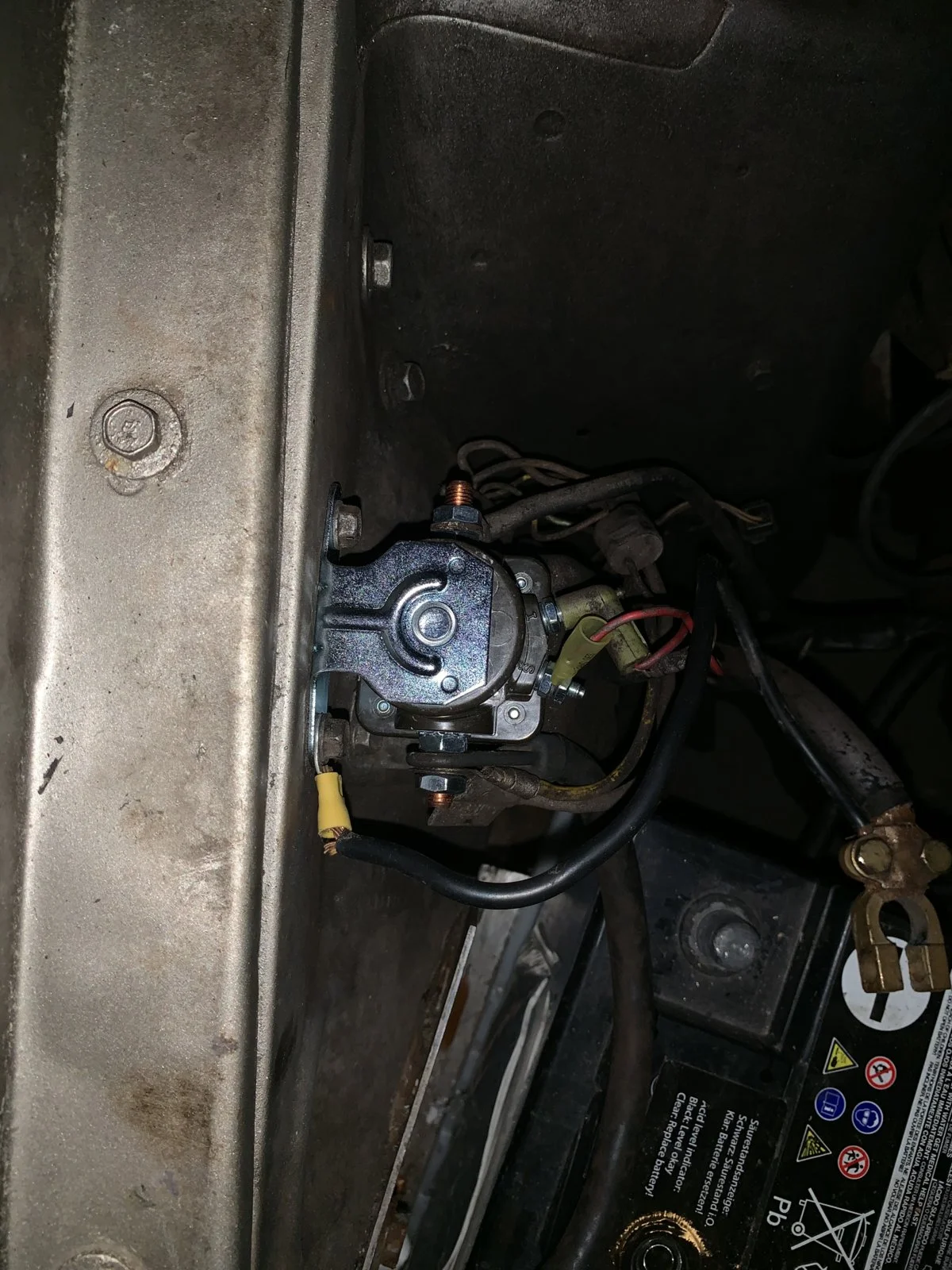

Hi sorry.. I can post a picture of the setup on the starter solenoid... if you'd like.. I appreciate the advice so far..
OK, I may have misunderstood. Do you have a test light? If you don't buy one, they are cheap. With the key in the run position you just need voltage at the "+" wire on the coil. That power comes from the ignition switch, threw a resistor wire, (I think It's Pink). And if I recall there is a bullet connector plug at the firewall with the ignition wire and the sender wires in it. If you don't have power at the coil trace it back until you find it. If you need a little hands on while your doing it I'll give you my test # if you PM me. I'm generally putting around my shop on the weekends.
