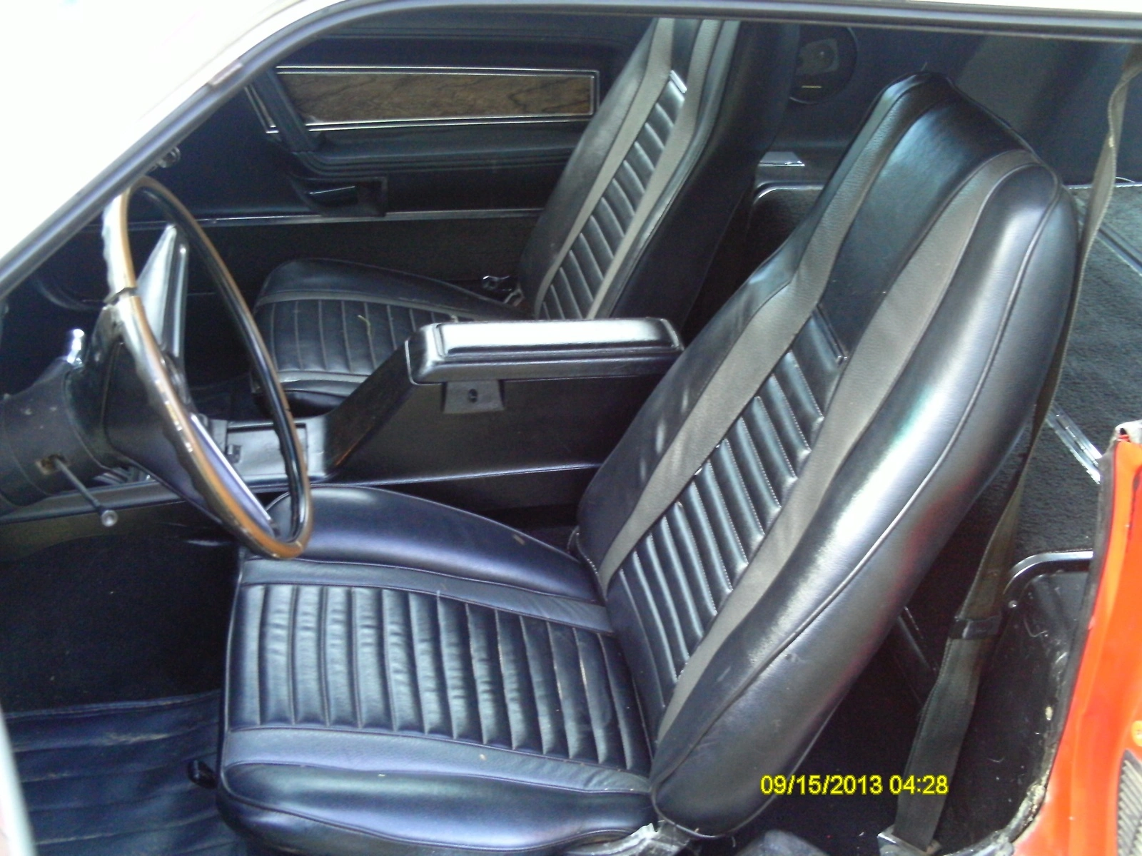

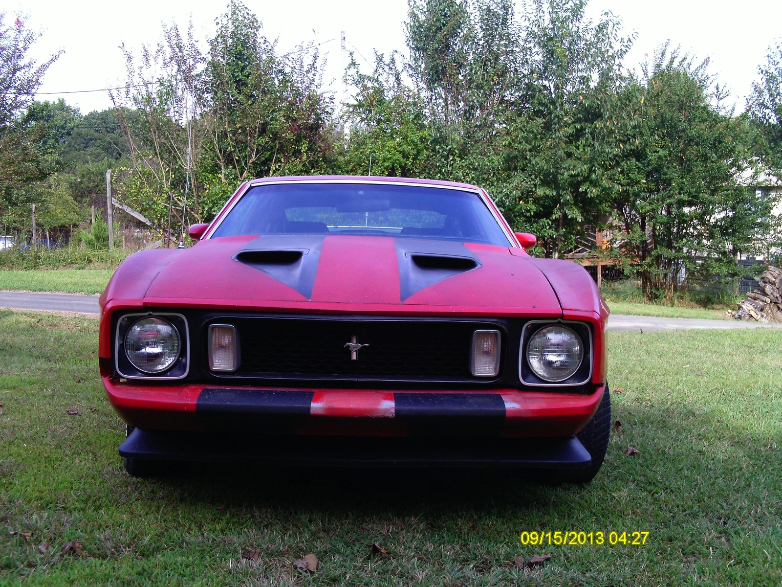

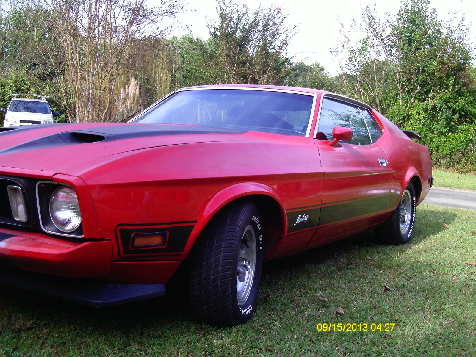

I have never restored or even have the skill to restore a car...however; wanting to start. I found a 1973 Mach 1 351 Cleveland 'H'...owner says ALL original. It has virtually no rust on it and it runs good he says. interior is in decent shape (needs a few things and some TLC)...person is asking $6000. Is this a good deal? i would have to fly to another state to 'check it out'...and then have it 'trucked' back to michigan.

so, do you believe it is worth a trip to 'bama to view it, then spend the $6000 to purchase it, then spend $800+ shipping it back to Michigan from 'bama? Big decision for me since $6K (plus trip plus shipping) aint just change...and this will be the first car i have ever tried to re-do. Have you ever re-done a car before and if you have...if i get totally 'taken' on this car...do you have any idea of what a total redo would cost (based on the shape the car currently looks like in the pictures)? just trying to determine if i do get 'taken'...what will it cost me to get my money back out of it.
it has been some time since i have restored a 71-73 but i know they are more expensive than the other years .i can't give an estimate of what it would cost .
your best bet would be to get a catalog ,Branda, Mustangs unlimited ,or National parts. and price the parts you will need. i would look it over carefully .check the floors ,frame rails for kinks,rot. look inside the trunk and inspect the quarters .they can hide work from the out side but it is hard to hide from the inside. check the trunk floors . look over the bottoms of the doors for rot . expect to replace the normal . such as headliner ,carpet ,door panels ,dash pad ,possibly battery apron because that is a normal rusted out place .judging from the pics the car is in good shape but i would inspect it very carefully.i would say that $6000 is reasonable if no hidden damage.
