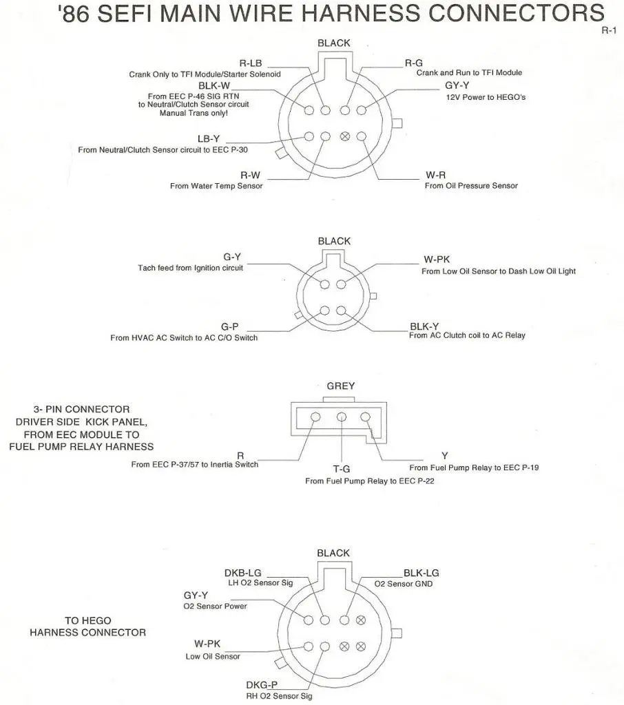

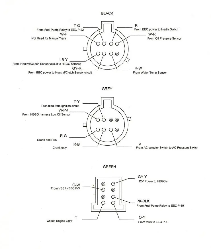

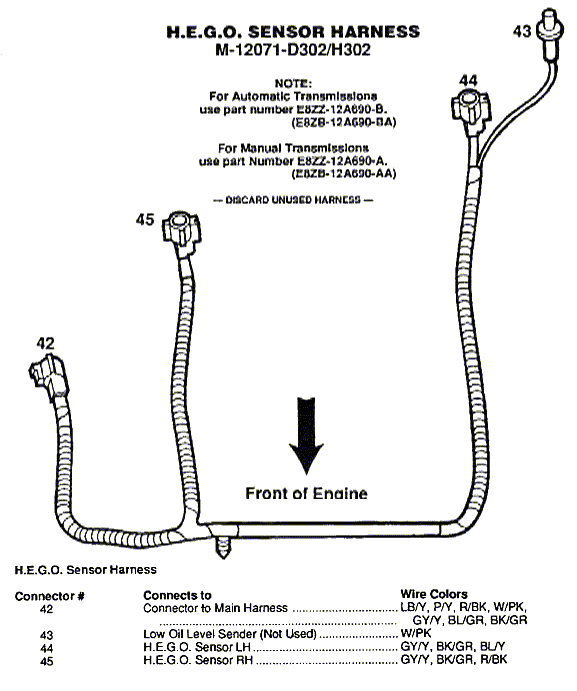

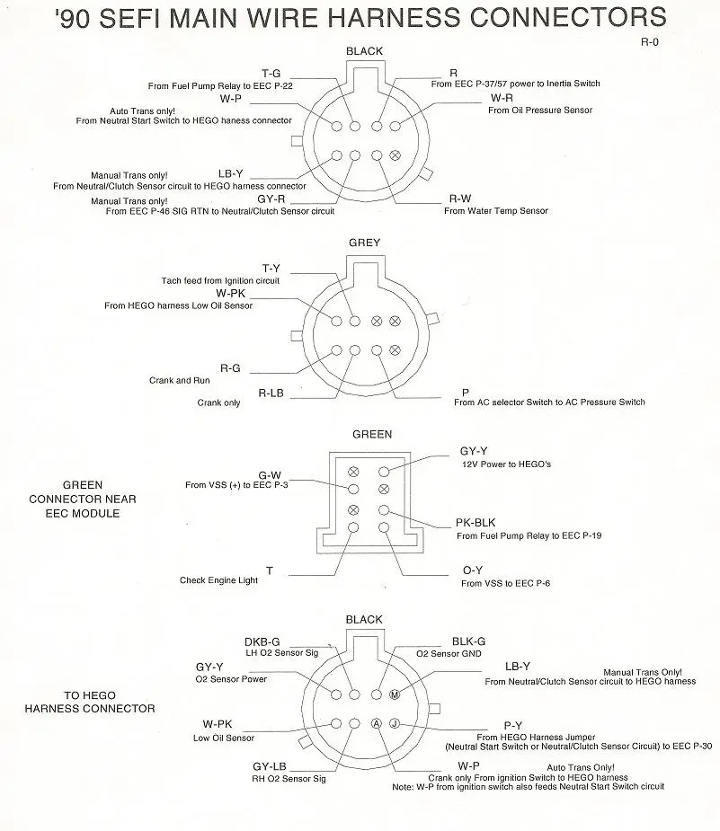

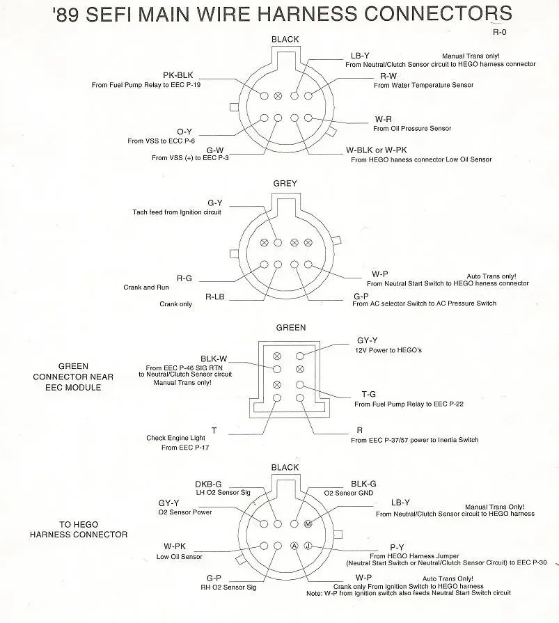

The wiring is not too bad really, as long as you have all the schematics from both your car (which you do) and for the engine harness/EEC. I will post everything that I have as far as the EFI harness for you here. I am sure some of it won't be of use to you as I transplanted a 90 5.0 into an 84 3.8 CFI car. A good website to go to for more info is oldfuelinjection.com. Hope this helps!
