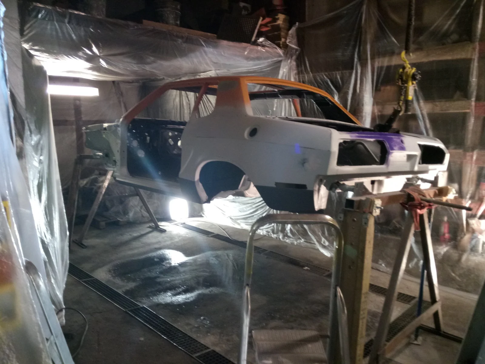

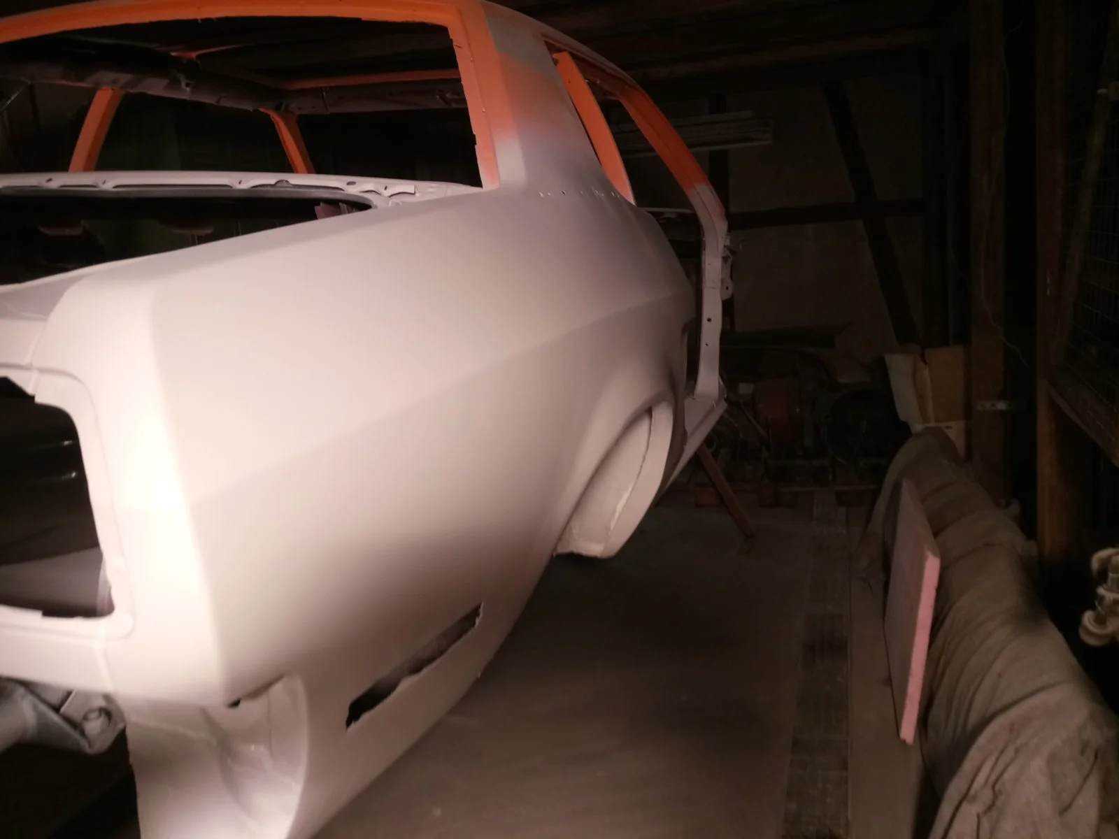

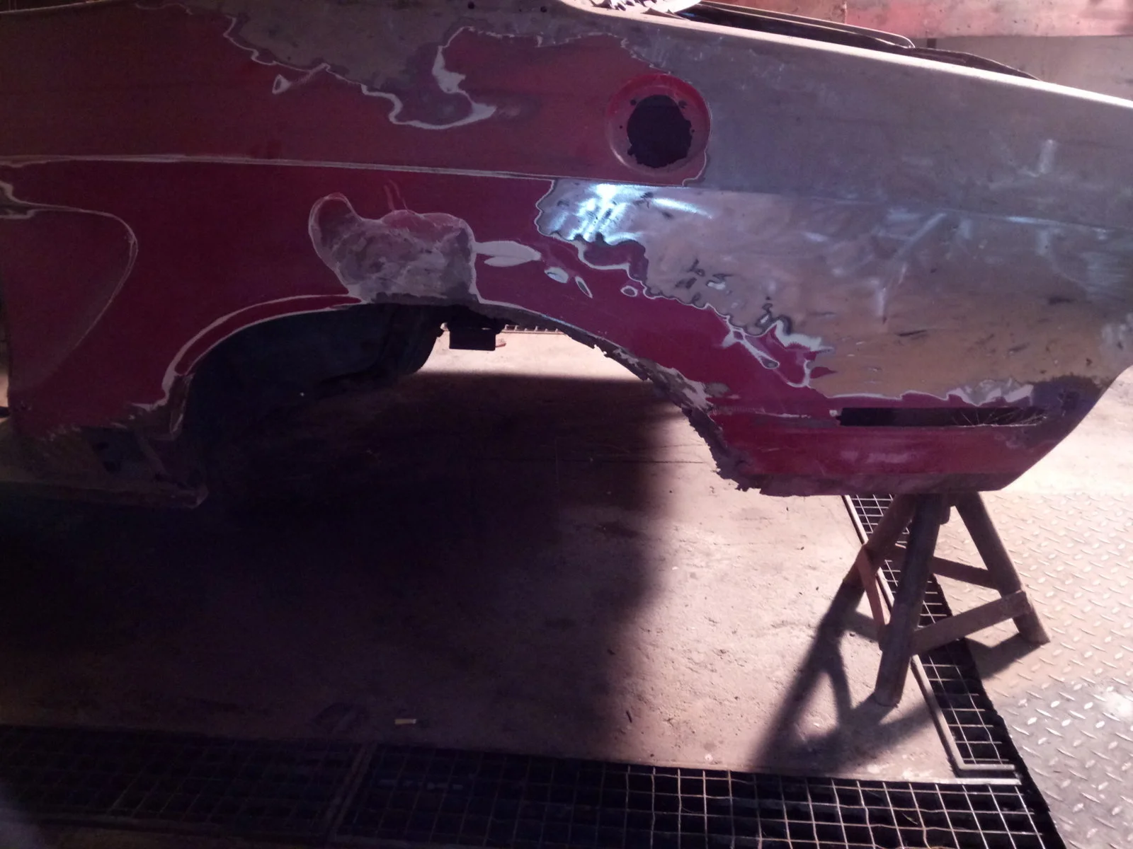

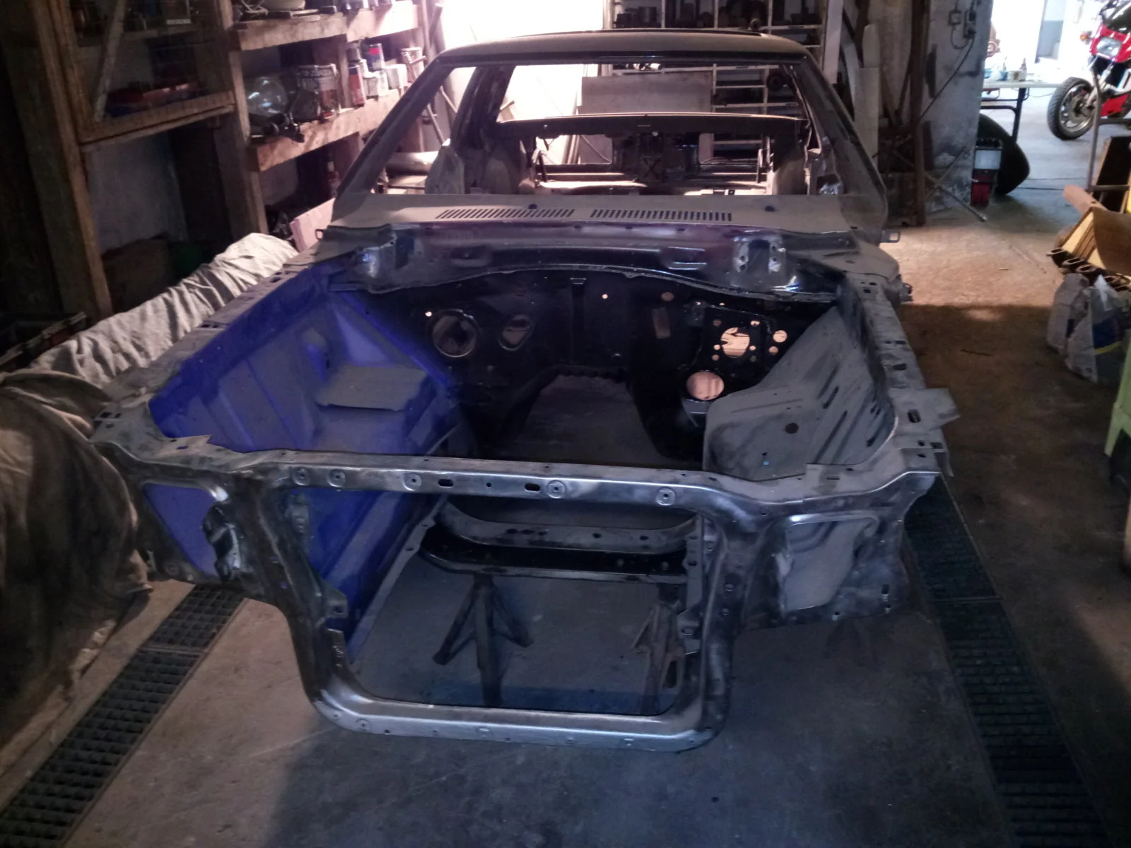

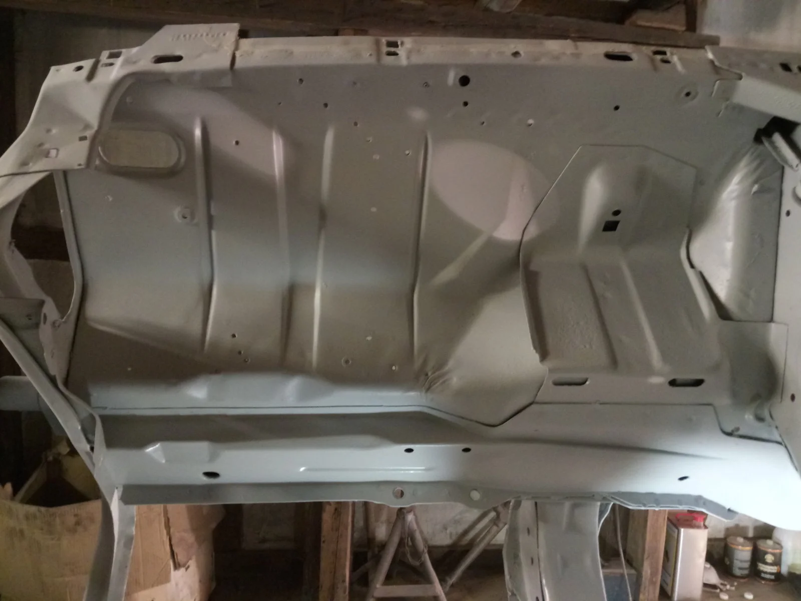

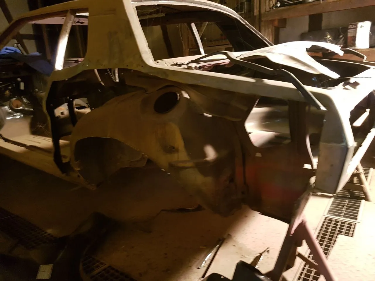

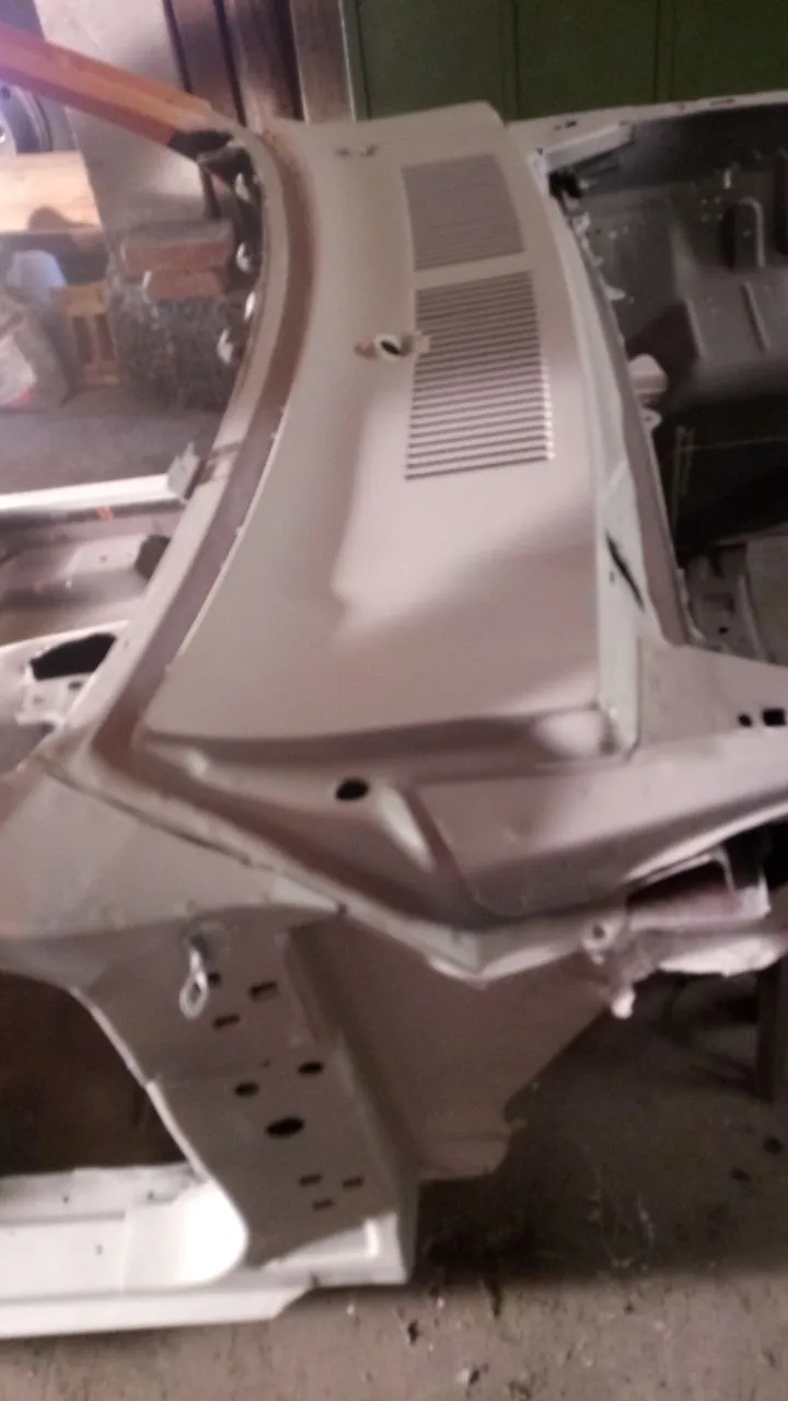

I would like to show you my project.
I have a 75 Mustang T5 Giha ( German wersion). I will install a 302 v8 and a Borg warner t5 gearbox.

Aloha Isegrim

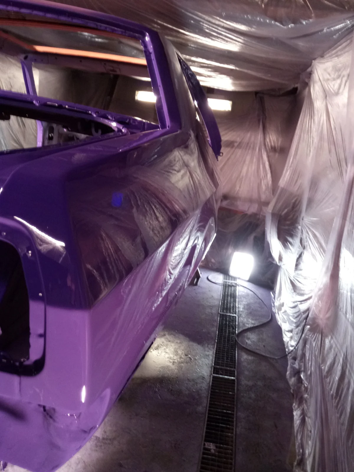

Some serious work on the way to a very nice paint job!
Looking really good. Nice job on all the pictures too, keep it up.
Did this come with V8?
Did they call these 'T5' or Mustang in Deutschland?
Are you going back with the red?
thanks, people
@2Blue2

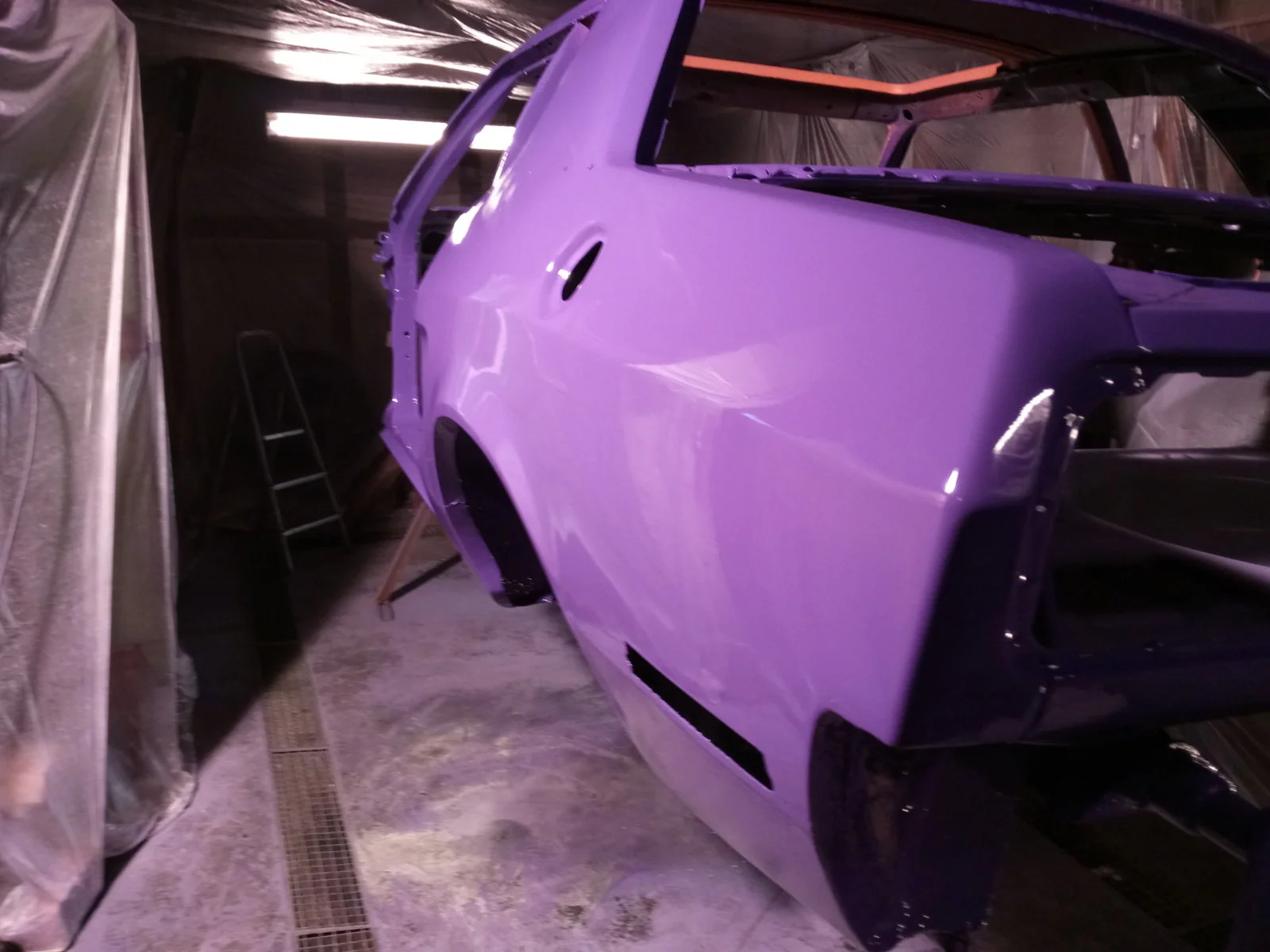

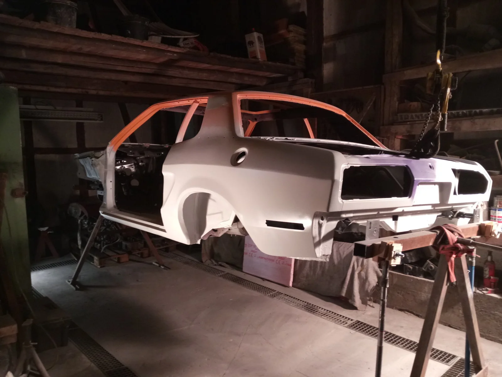

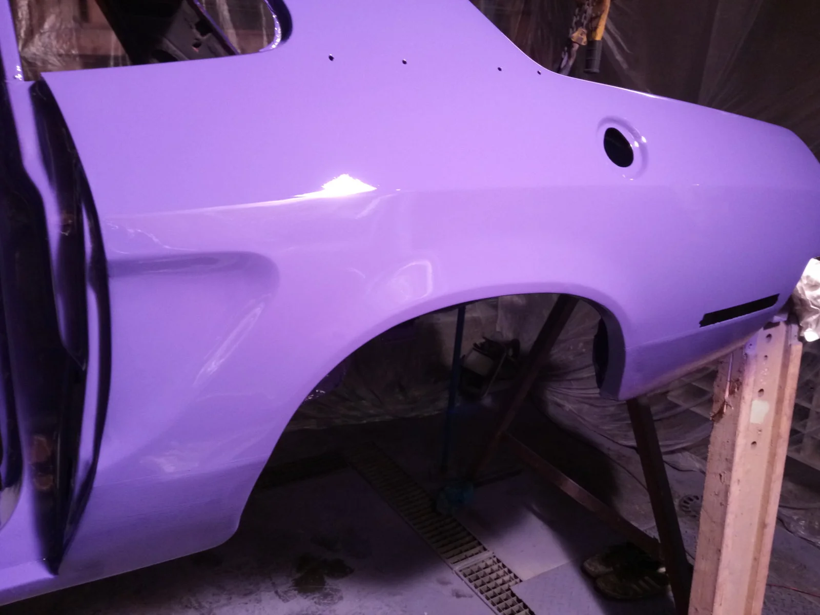

o yes that's a lot of work .... no red I did not want to have a complete other color chosen .... the pictures with the finished paint still come .... it was a v.6 2.8 l installed .. but he was dead.
yes in Germany, the car was not allowed to call mustang because another company had the rights to the name Mustang
Reactions: Manoah and 2Blue2

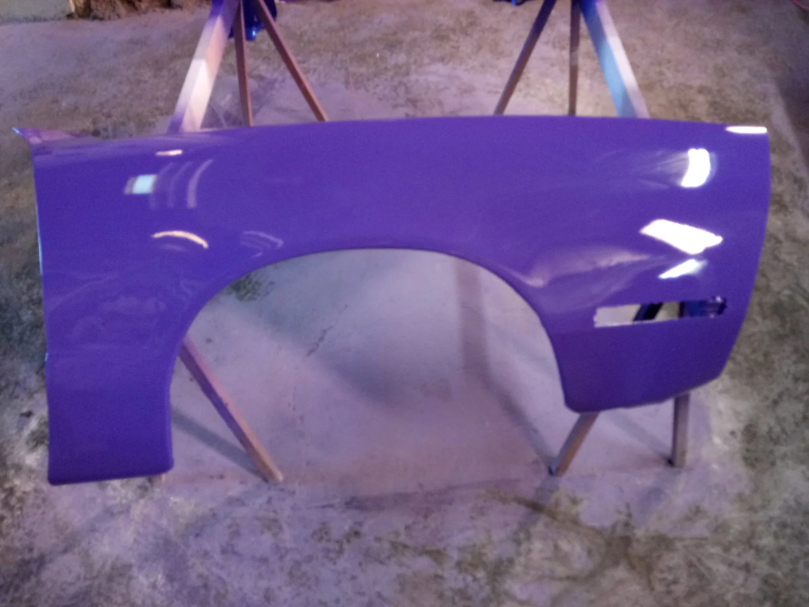

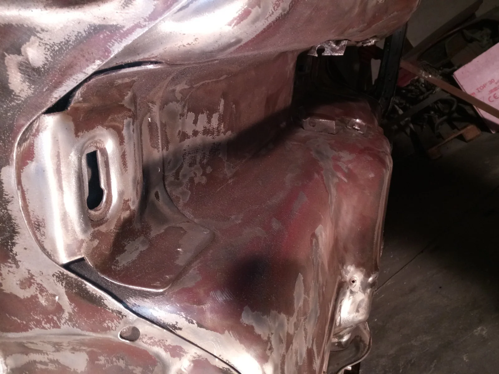

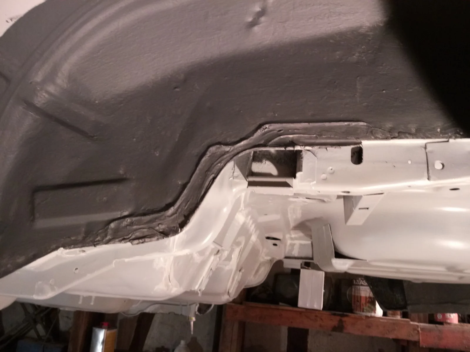

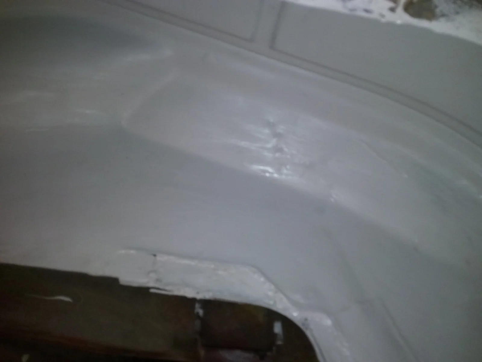

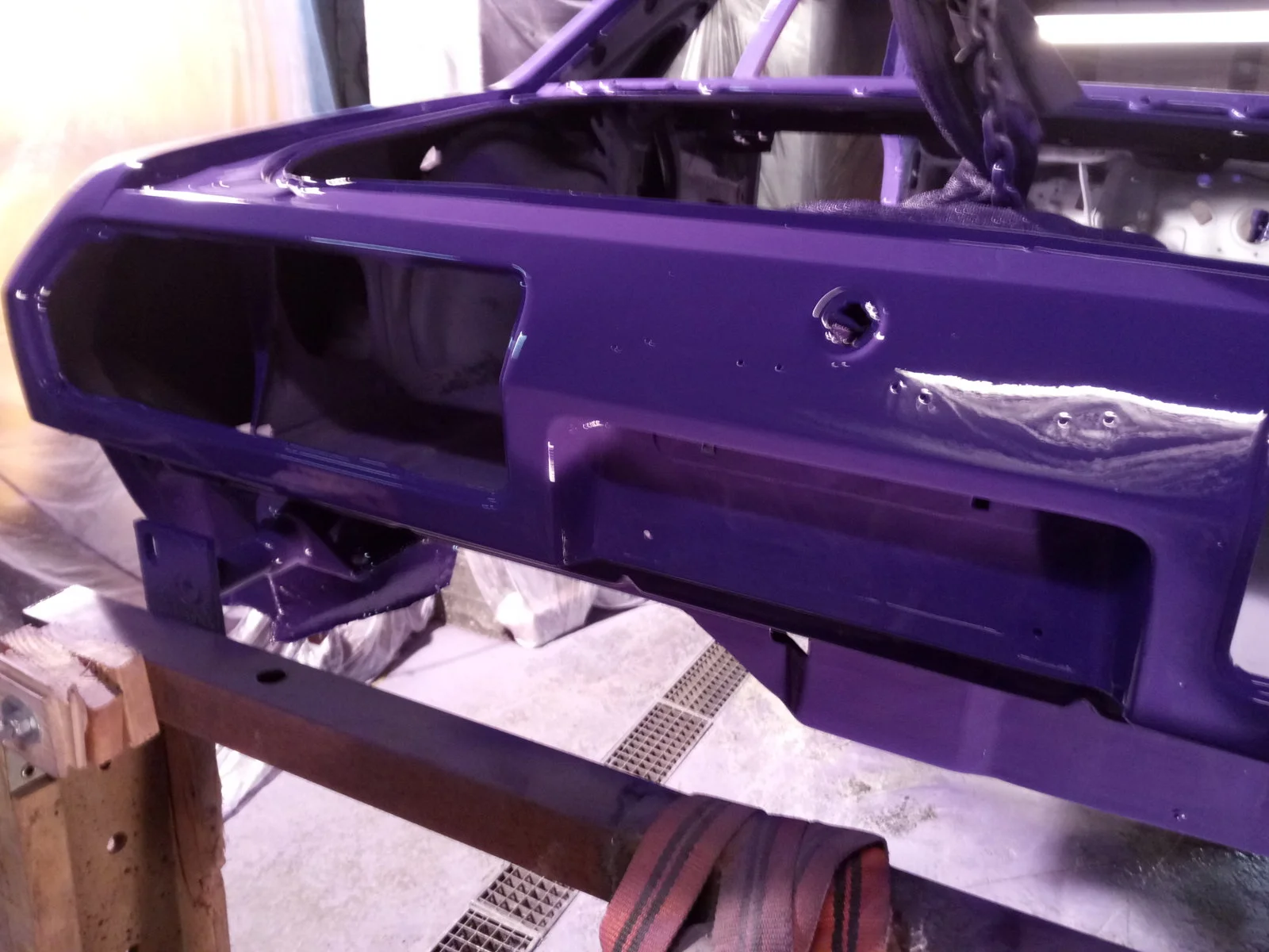

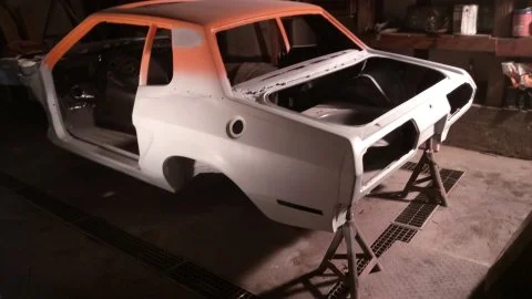

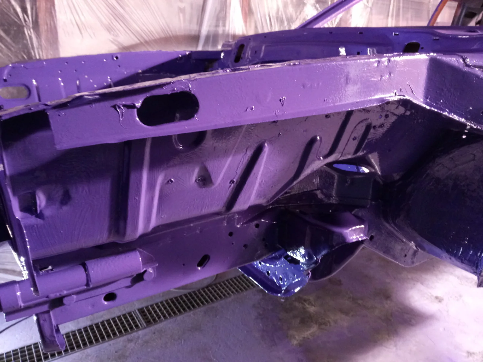

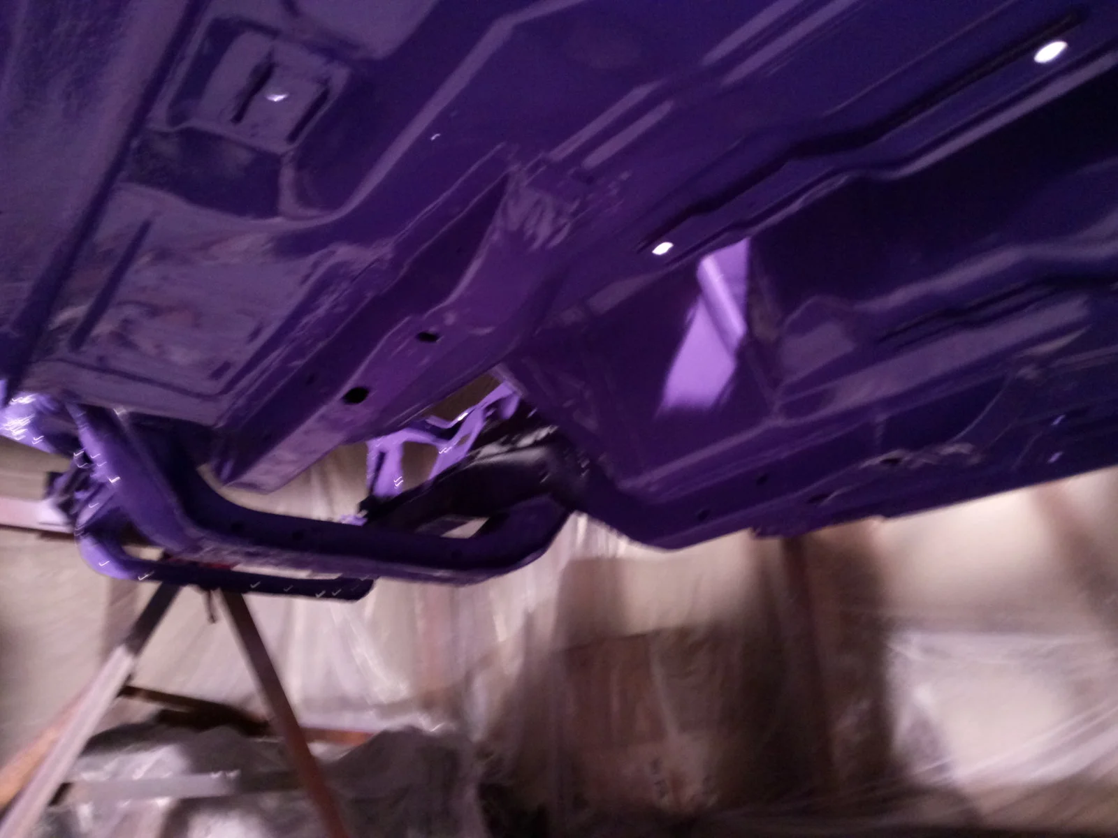

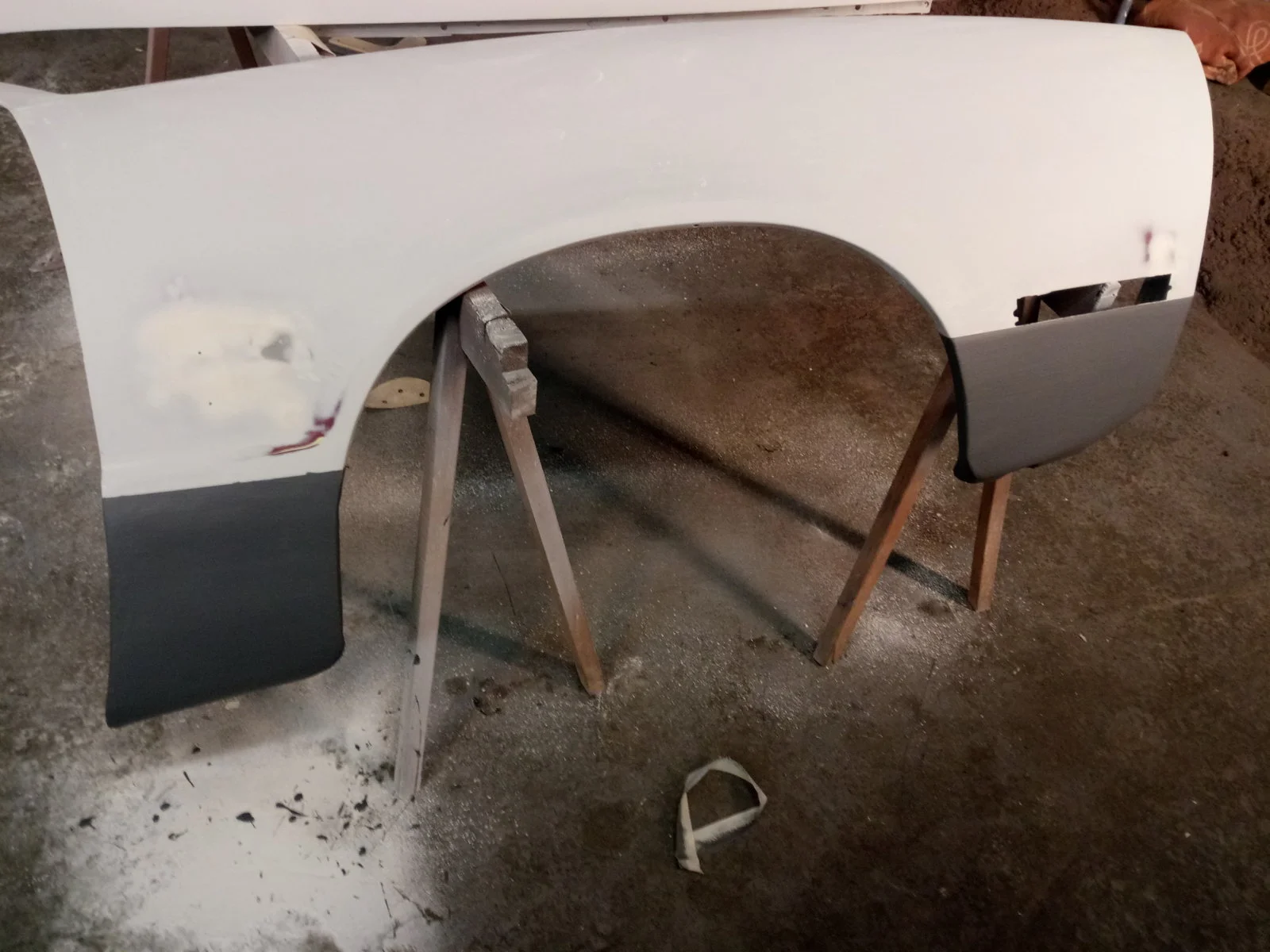

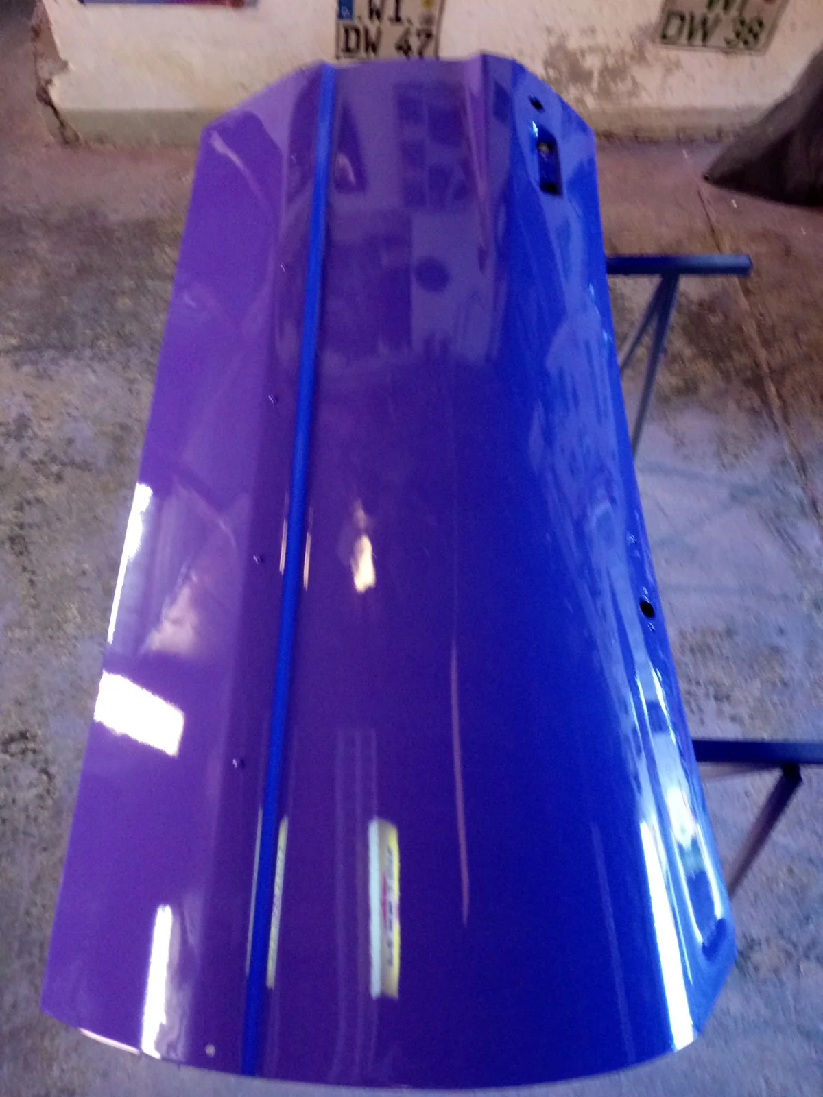

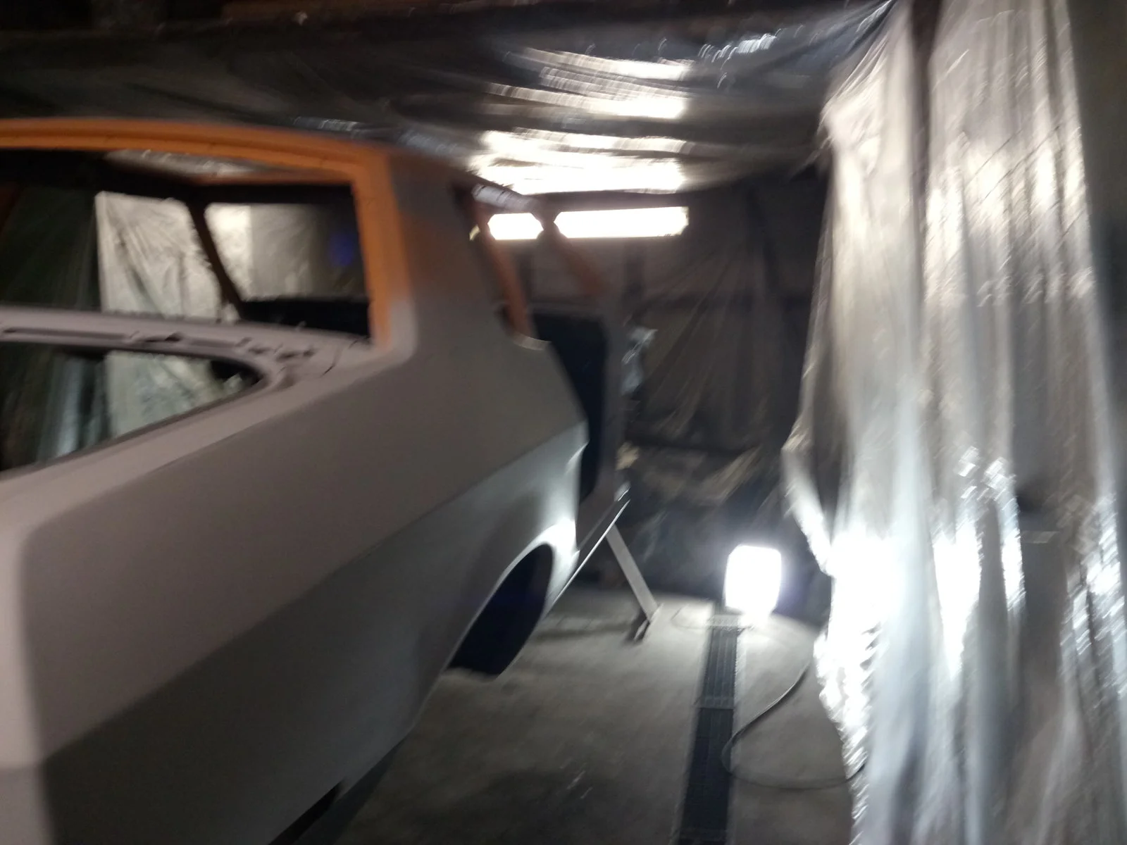

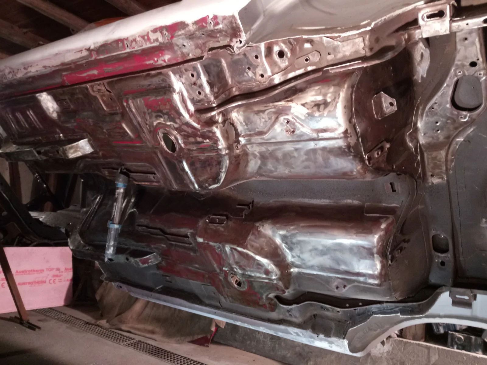

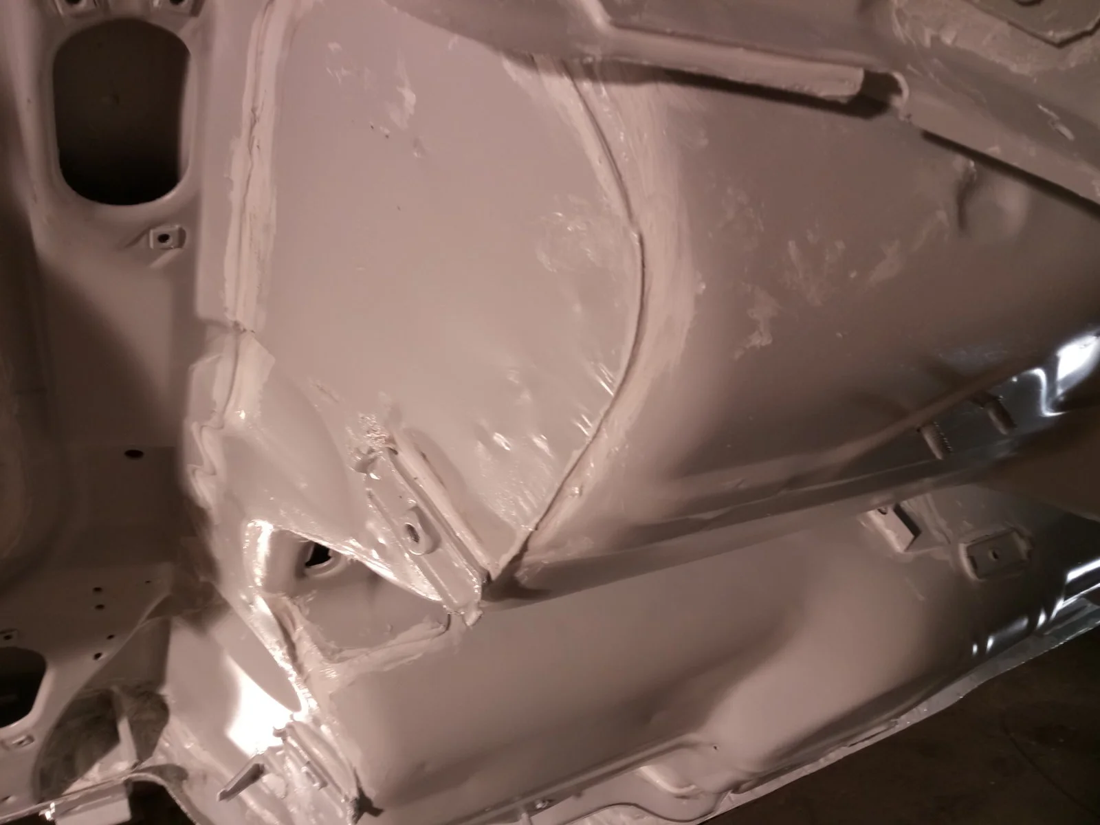

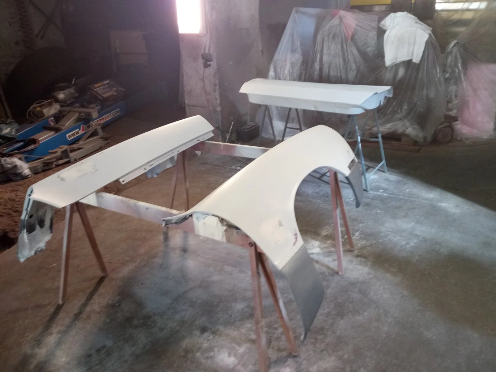

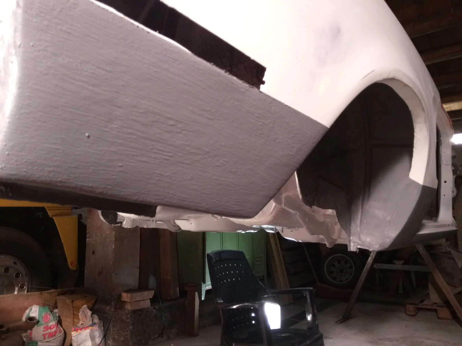

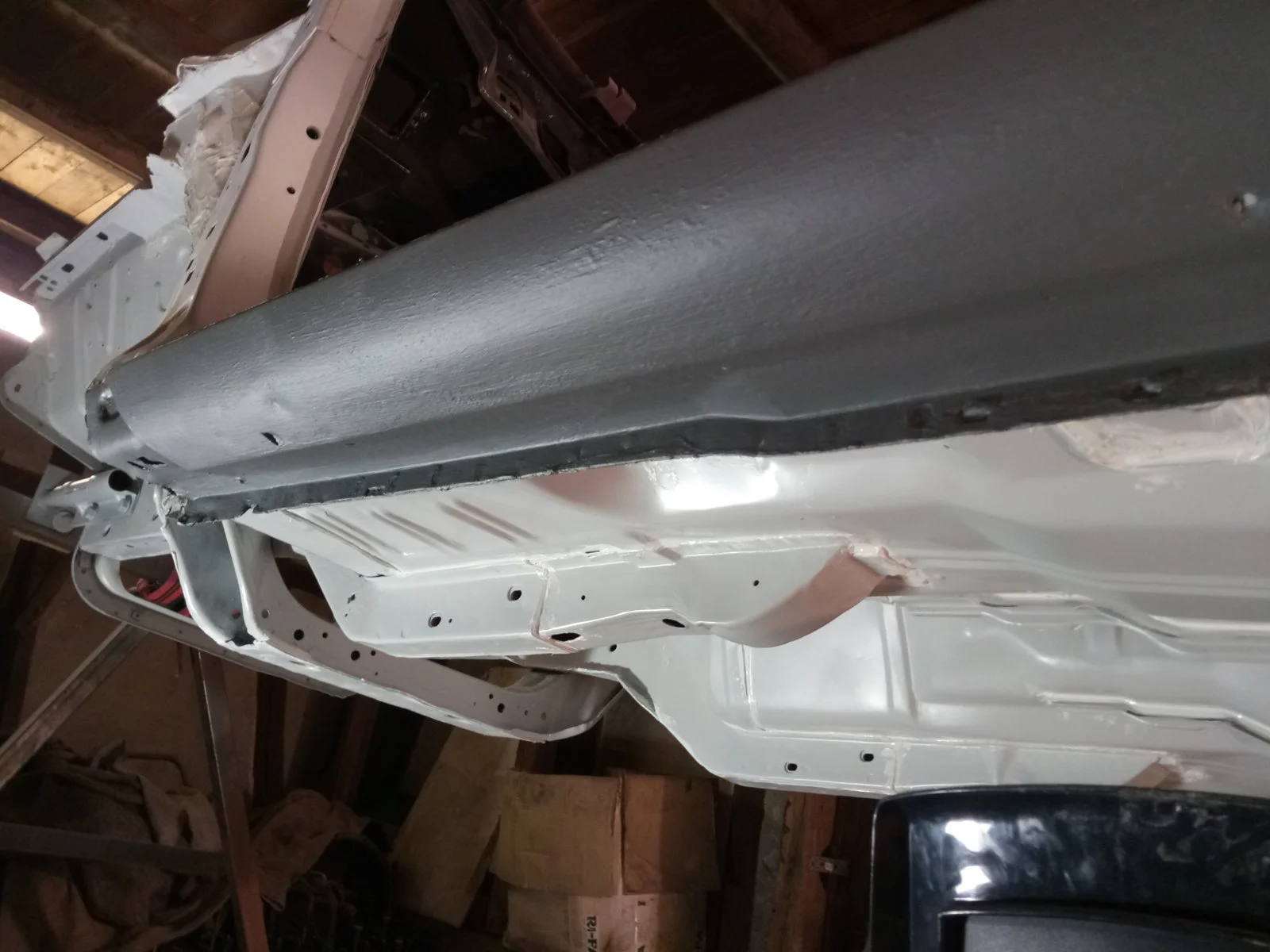

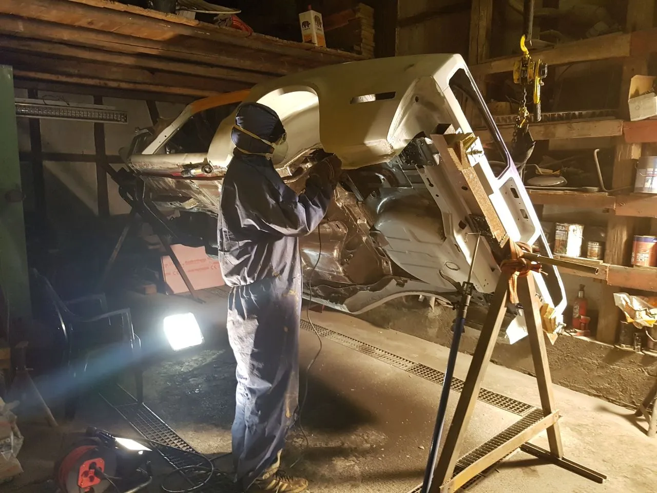

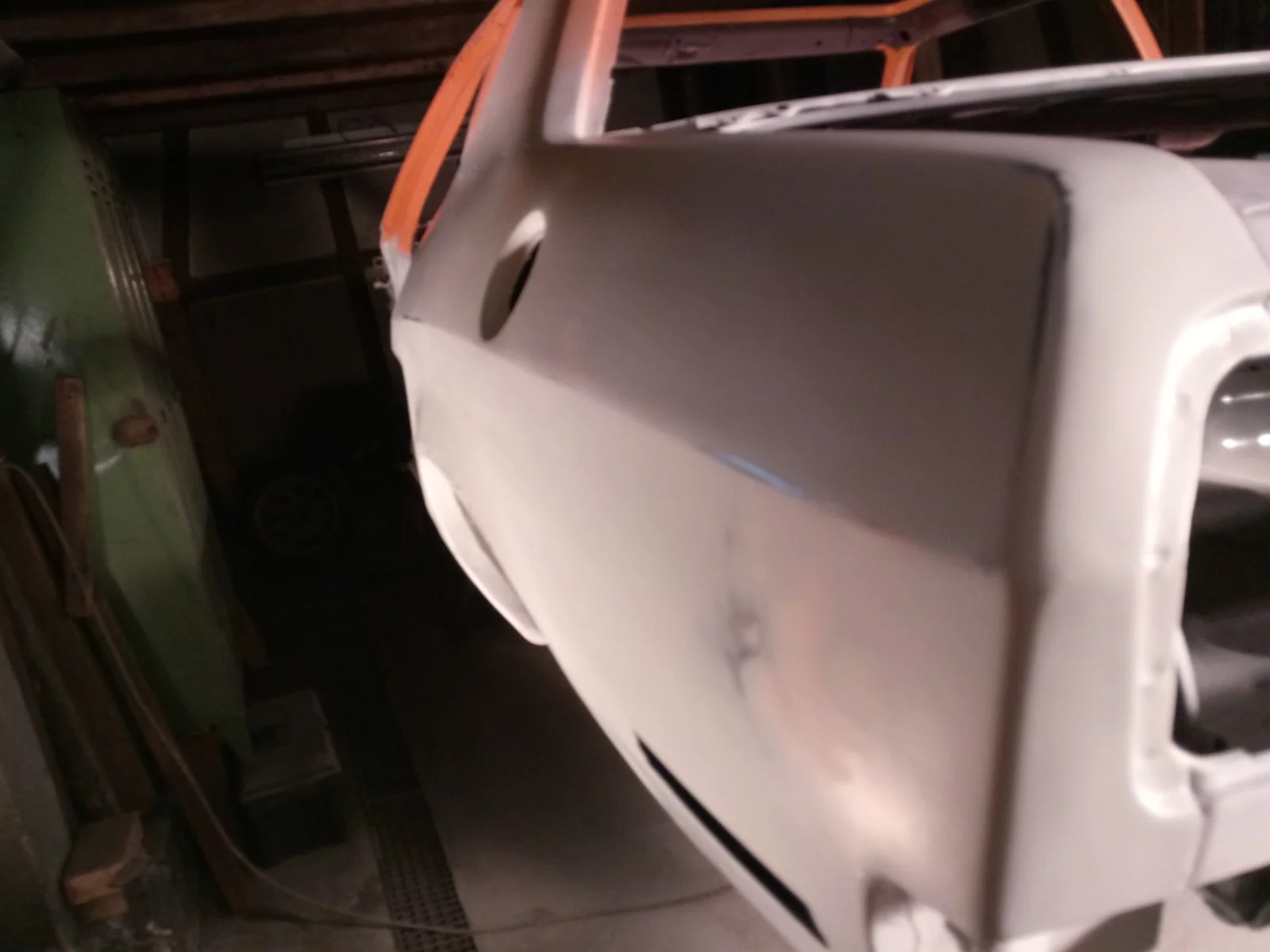

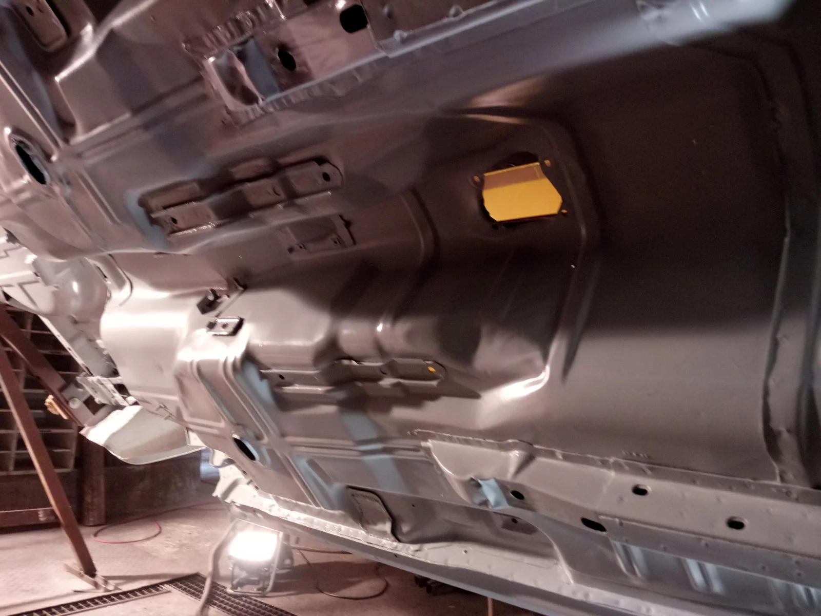

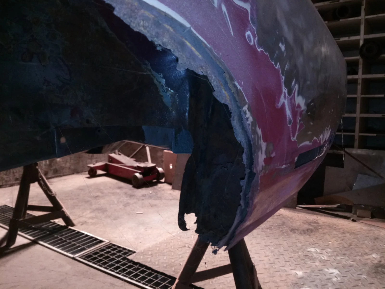

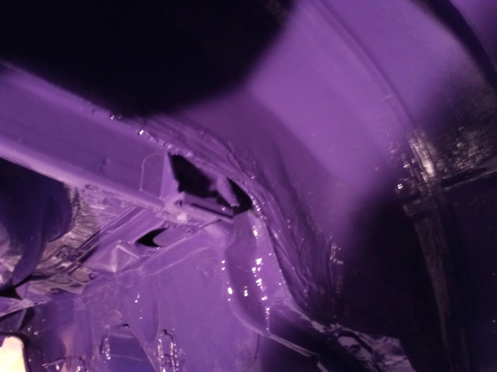

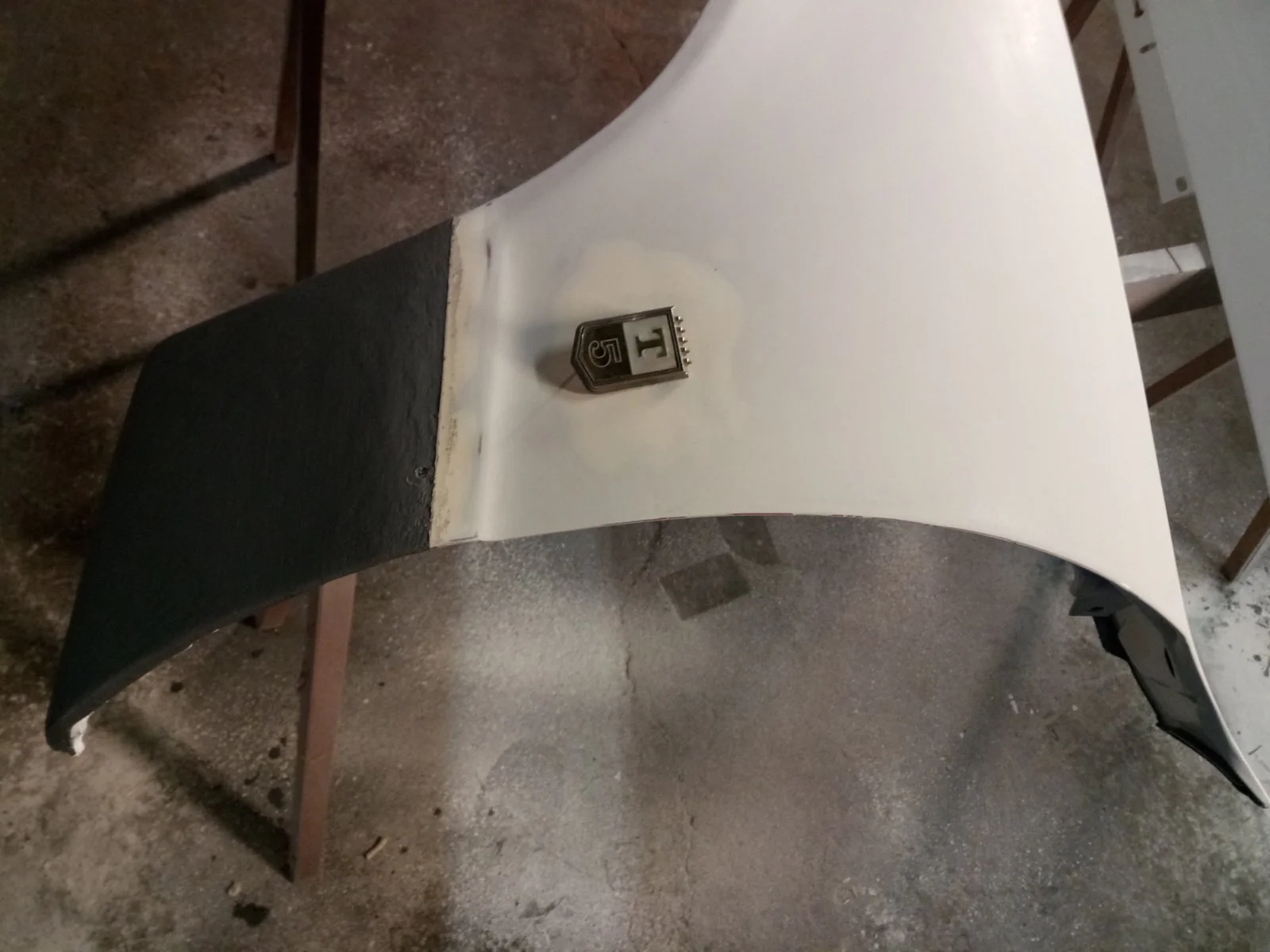

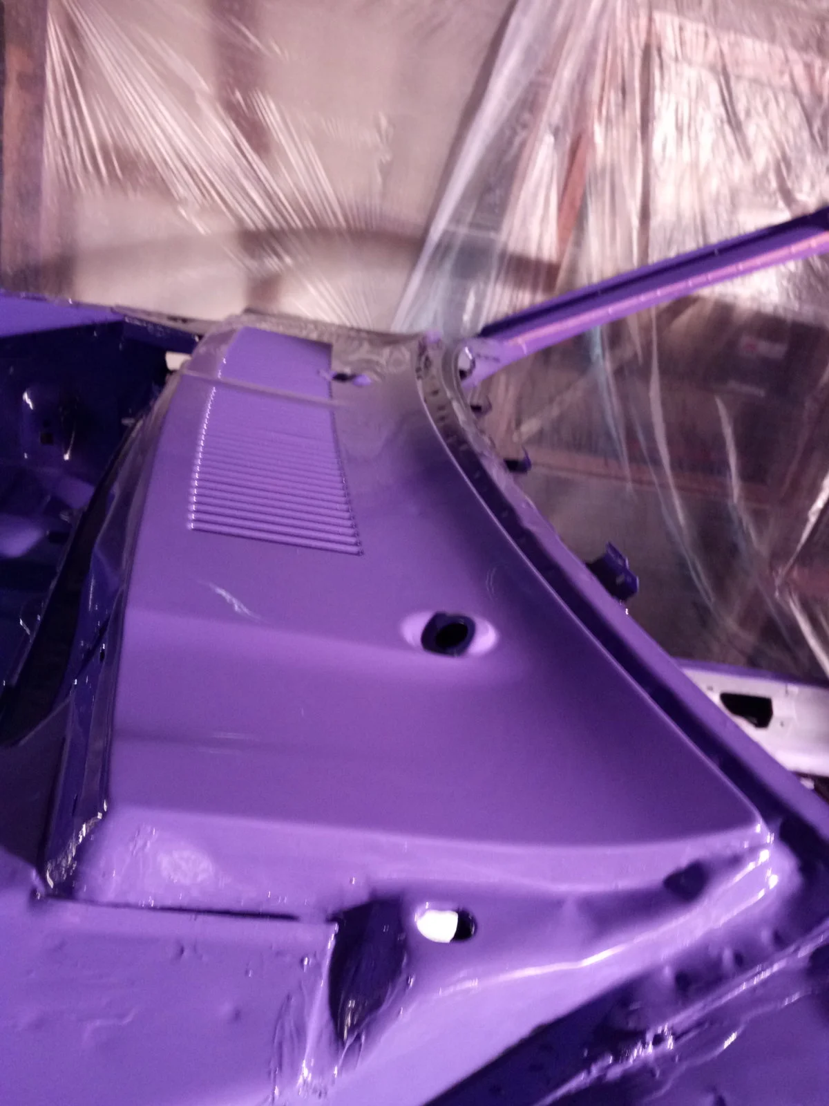

after grinding and grinding and grinding .... comes the stone chip protection
Reactions: Manoah and LILCBRA

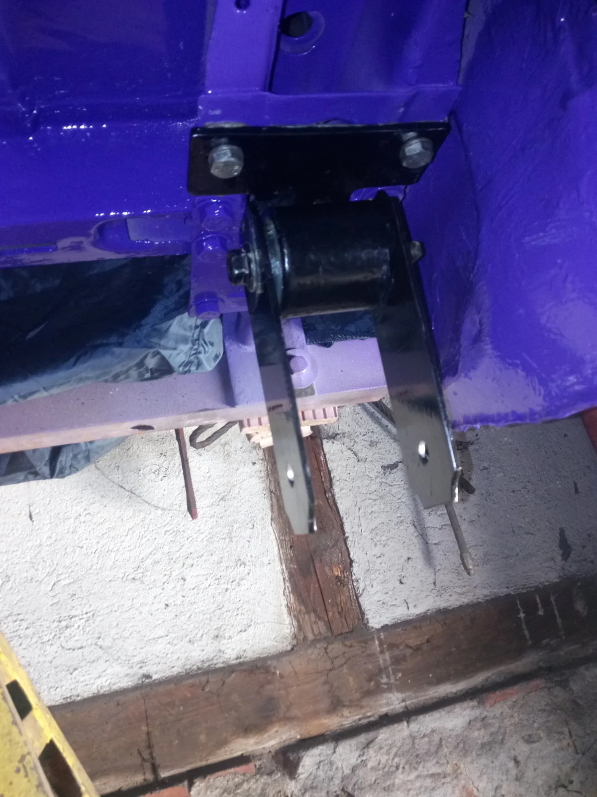

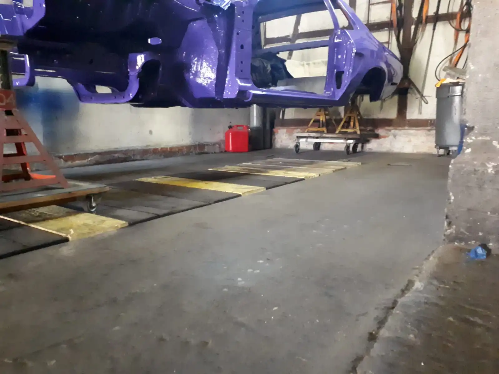

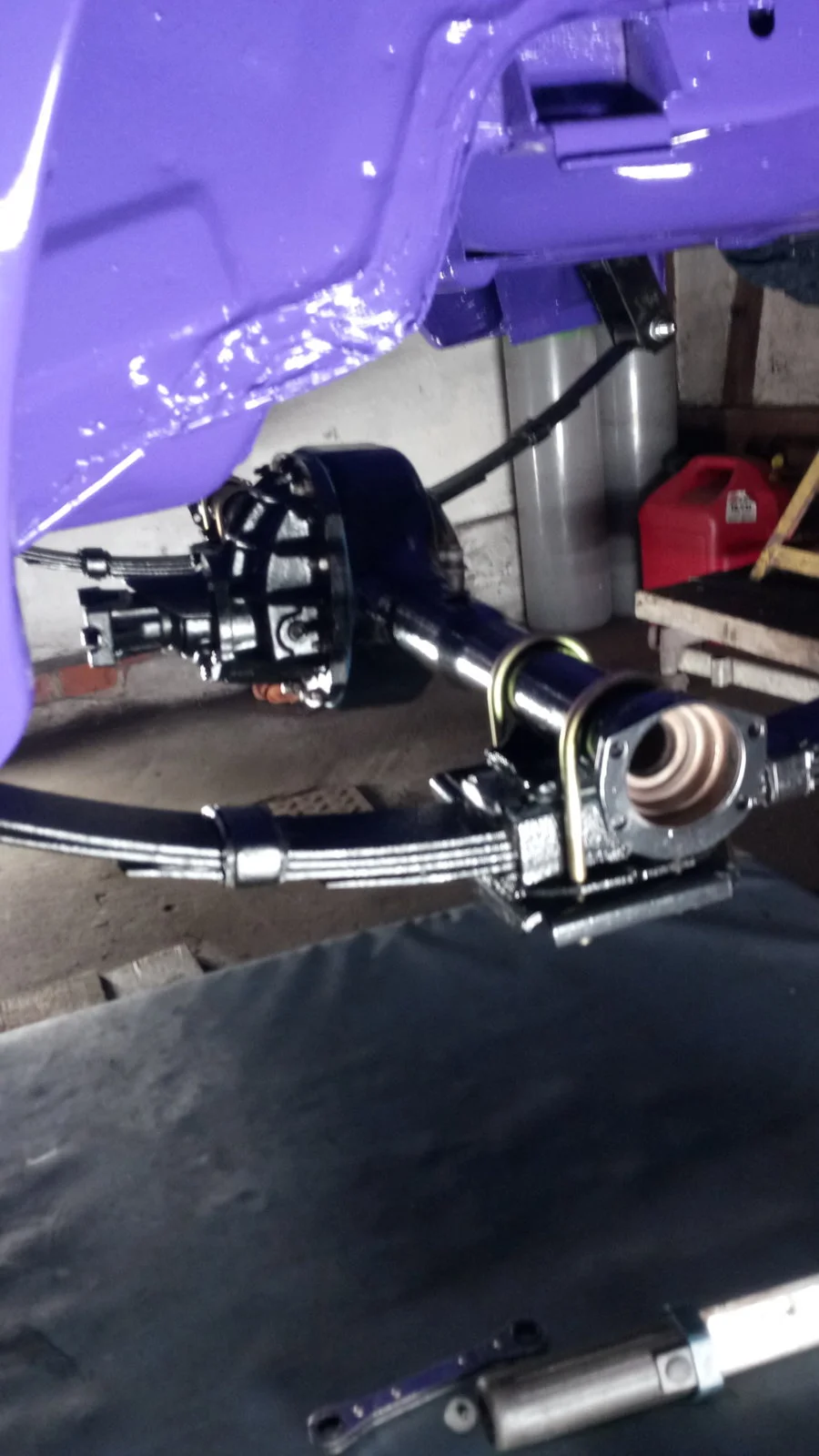

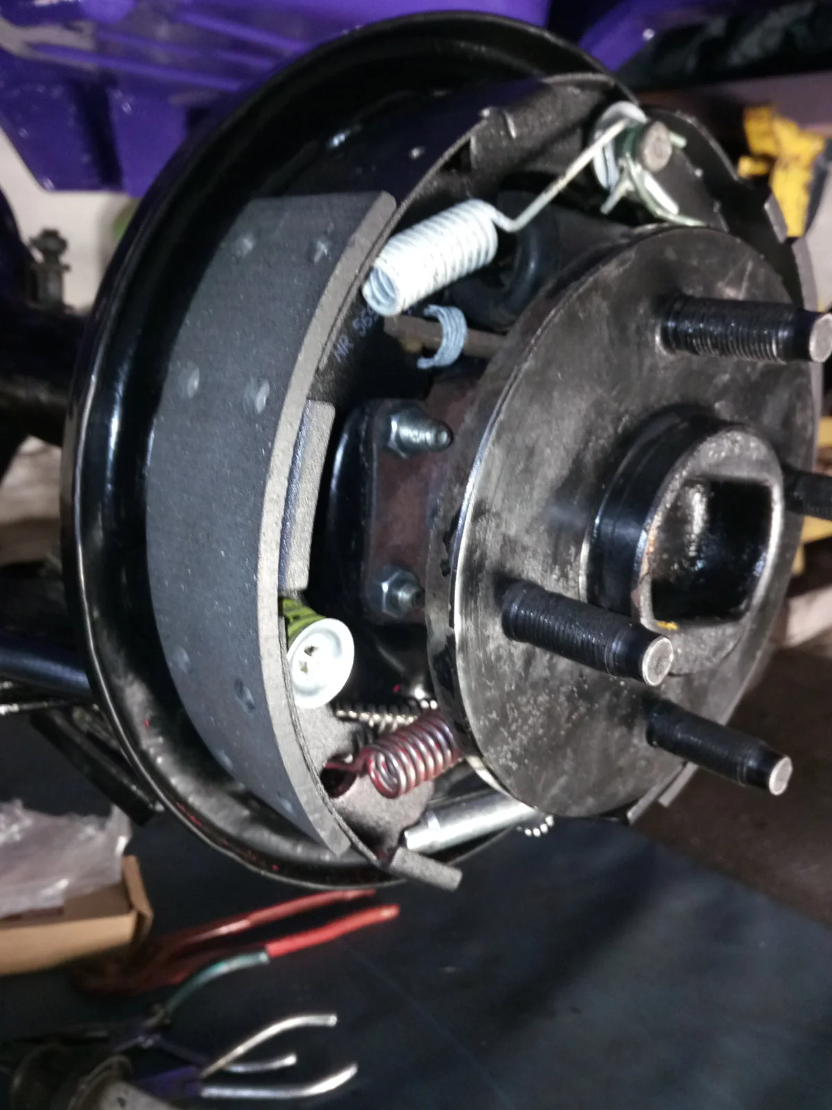

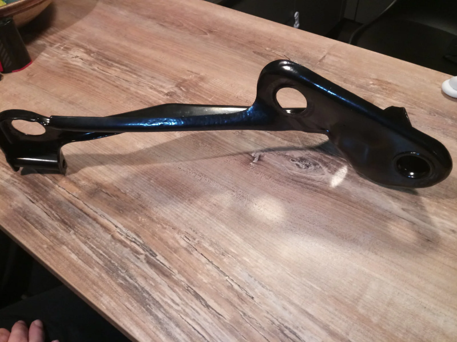

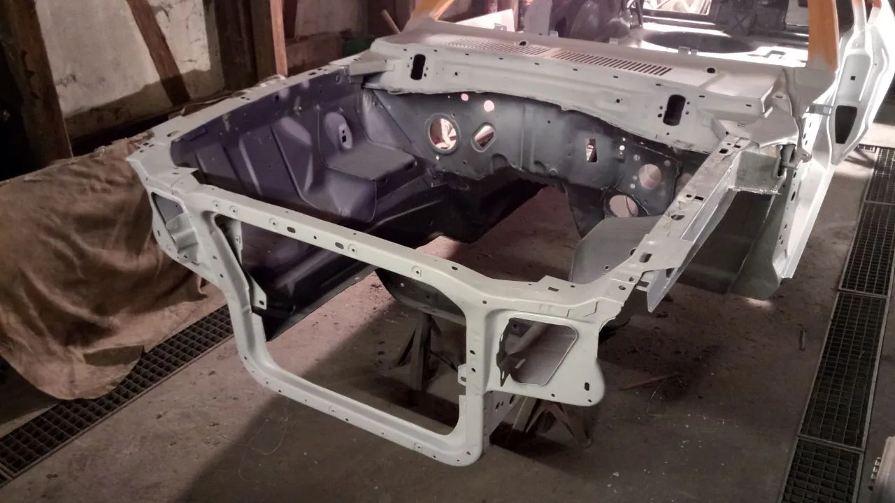

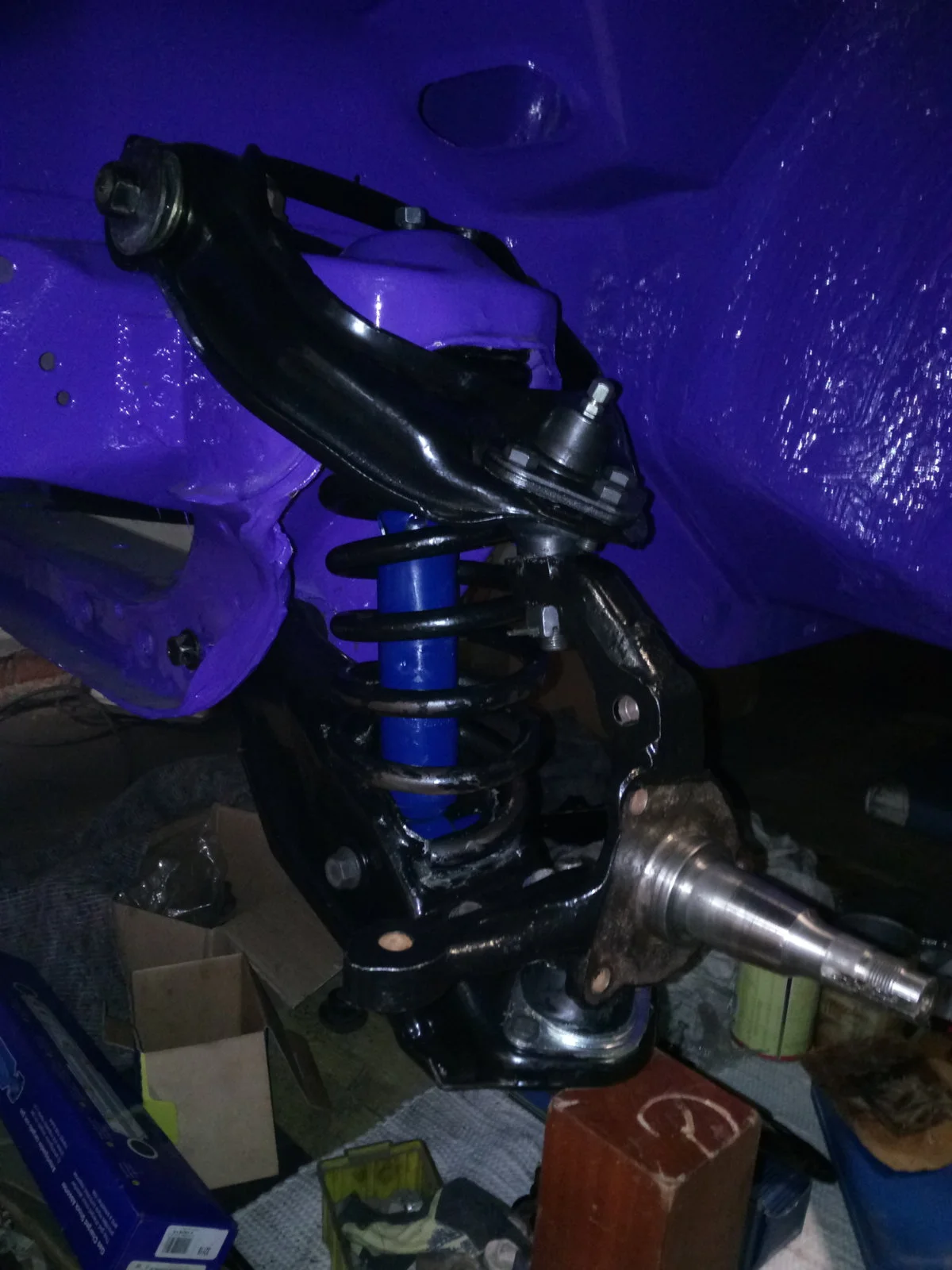

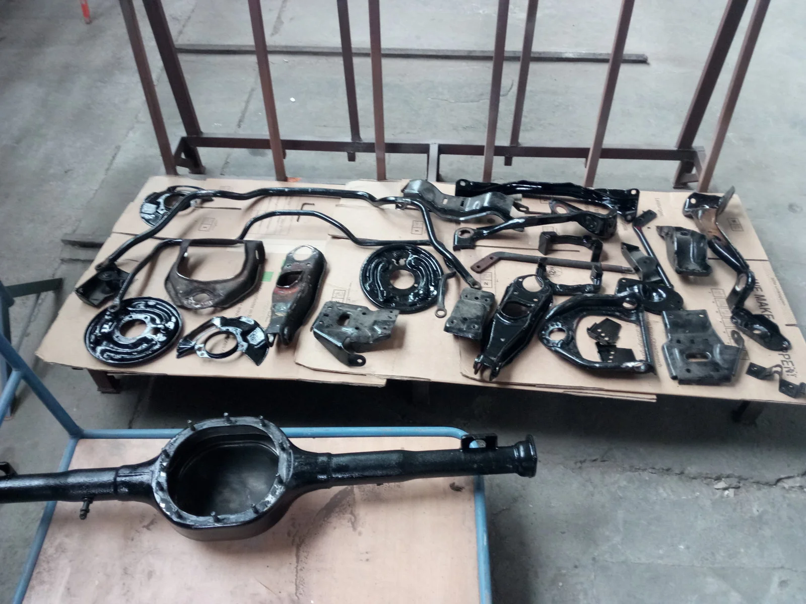

Then it went to the rear axle and other supporting parts.
blasted and black powder-coated.....
all gaskets and bearings have been renewed
