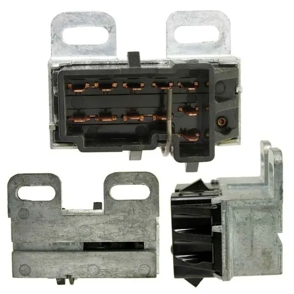

progress report,well i replaced the key lock cylinder. Still sticks in start position. Think i have to replace the switch down on the Colum. Does the switch have a built in spring. it does spring back but not enough to put it to the run position?
I don't remember, but I think it does. You could try lubing the different contact points of the rod that runs from the lock cylinder to the switch, that might get you by. Otherwise it's not that hard to replace - as long as you're a contortionist....
Seriously though, it's not hard to replace. 2 bolts and disconnect/reconnect the harness connector. If you get so far as to remove it, you could also try lubing the slot area that the rod runs through to actuate the switch. It's the slot on the bottom view of this pic.

It's been years, err decades actually, since I replaced one. I do not think the switch has any spring. It can get gummed up. Notchy. Hard to operate. It' s basically a slide switch and when it gets sticky the weak tumbler spring cannnot overcome the resistance in the switch.
If you try to lube it and it works go ahead and replace it. If you do lube it use something for electronics.
Did the old tumbler spring back when out of the vehicle? Does the old tumbler feel like it operates correctly?
Yes the switch has a strong return spring inside

If anything is sticking it is up the column most likely (the key and cylinder or the rack)
If the switch starts to come apart internally it can stick but they usually start on fire or quit starting long before that
The brand new Ford ones do come new with a bit of white lithium grease on the bottom of the black plastic piece where the rod goes in
Reactions: Enzio and LILCBRA
The switch does have a pretty strong spring inside it that only returns from start to run

The tumbler or key lock and cylinder spins freely and has no return spring
The key and cylinder can get gummed up and the ignition switch actuator rod and rack can stick
Kind of hard to completely fic on a old or starting to get worn one
But if you clean the cavity all out where the key and cylinder goes and clean the hell out of the rack and gear teeth
Then lube it all up with new white lithium spray grease it should be acceptable

The switch replacement is a little easier if you lower the column down and rest the steering wheel on the seat
Then turn inside out to replace it
