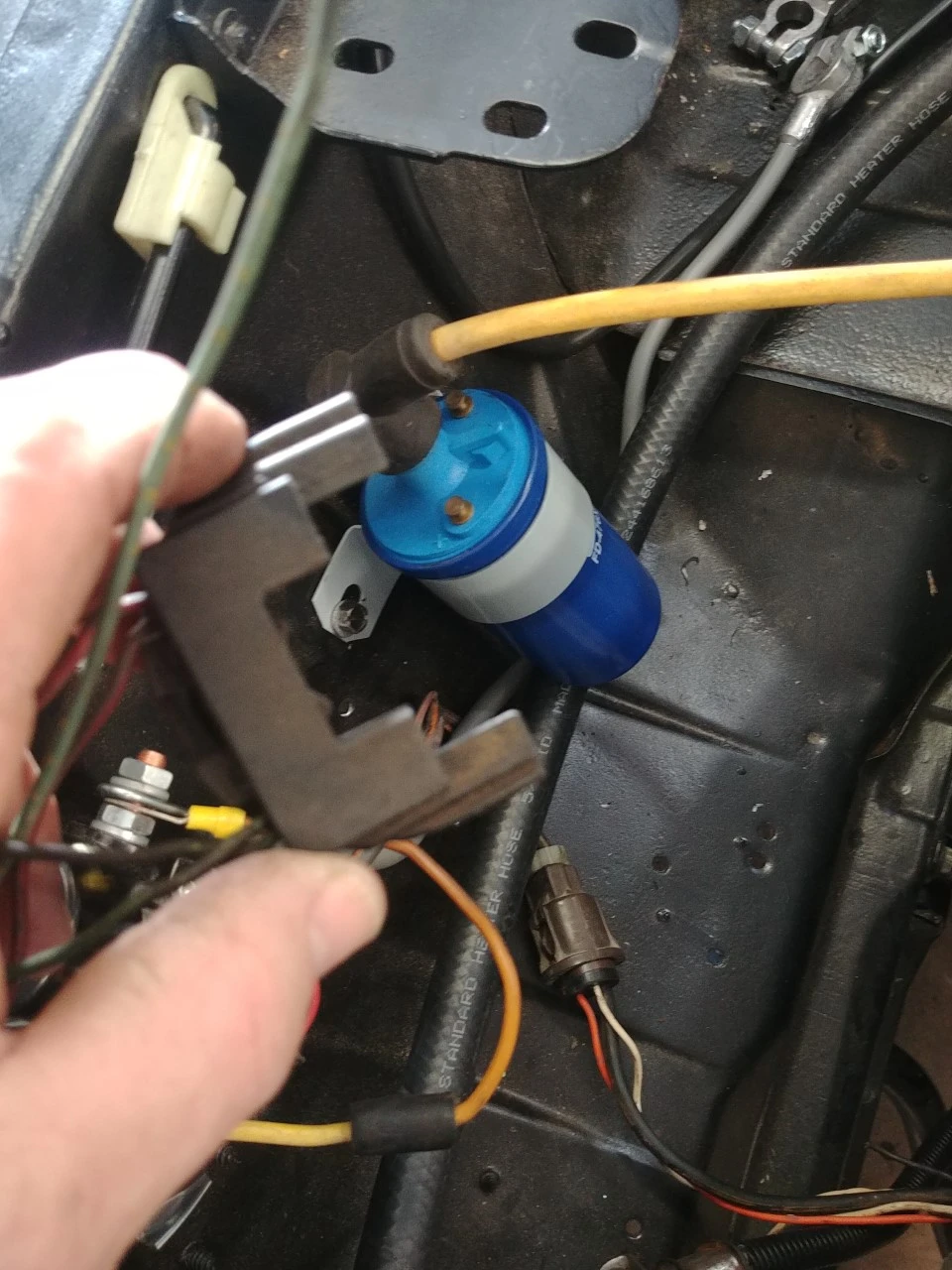

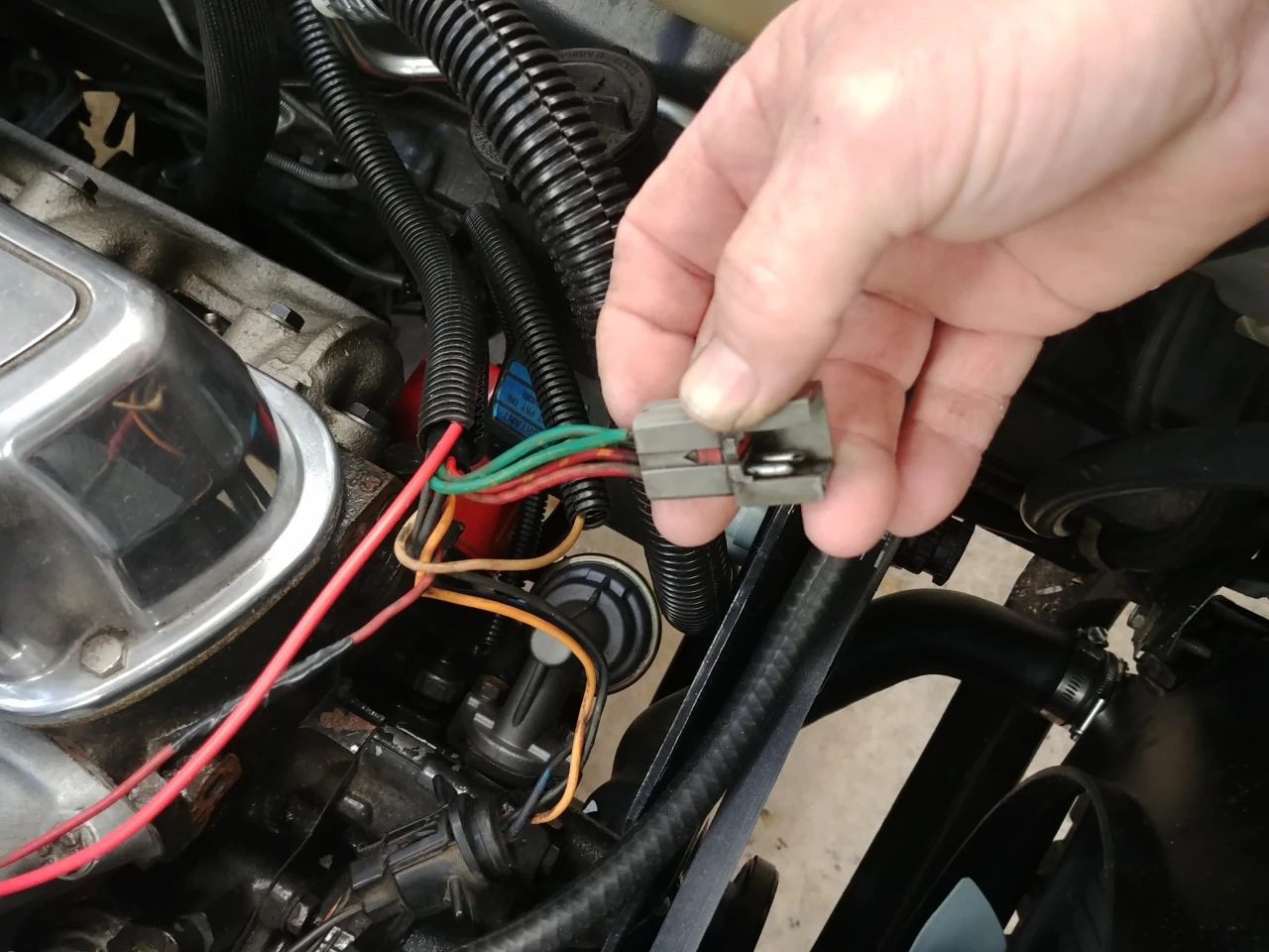

can you also tell me if this is the connector that goes to the ignition coil . the one i have that was in a box of parts has two wire a red and a green ,but no connector on the end of the wires,it it suppose to fasten into that quick connect iam holding.thanks again for all your help.

The connector I am not sure of. I do not use the oem ignition. It struggles at higher rpms in my opinion. There is a sticky thread where I uploaded some wiring diagrams. I also grabbed the diagrams via ebay for about $10. They are laminated and work great if you have good vision. I have a hard time reading them anymore but my son can read them easily.

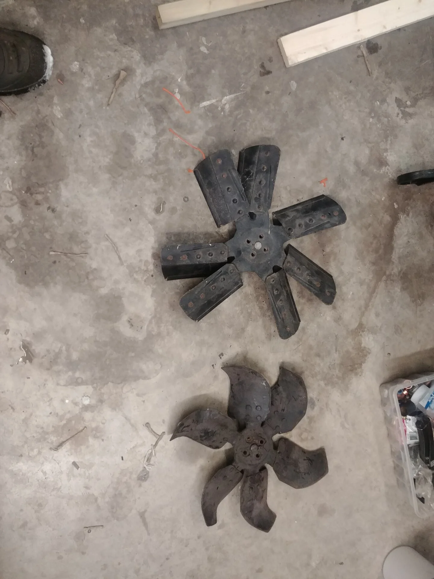

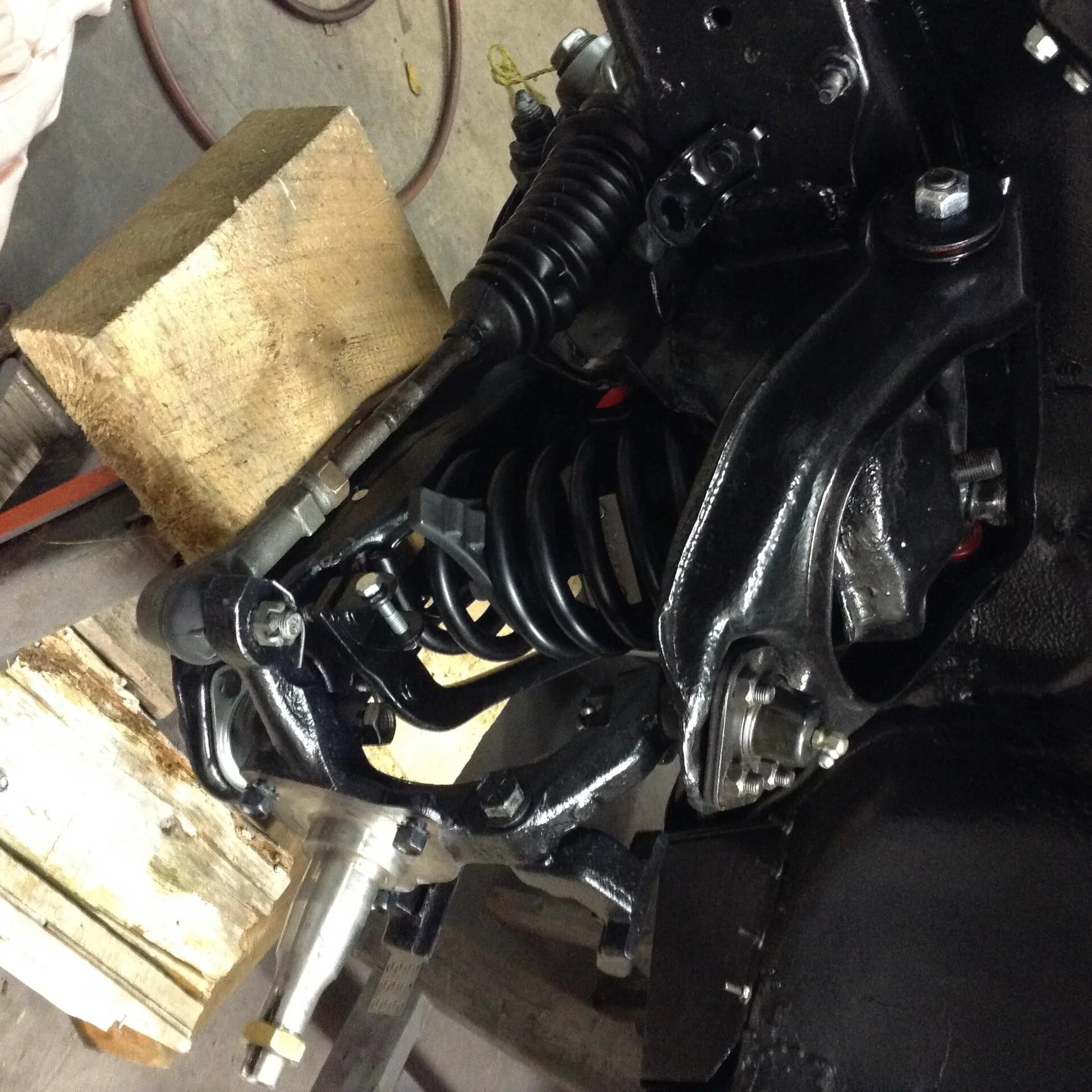

hi guys thought id post some more old pics of when i first started,not ready to post new ones yet.soon i hope.from the pic of the two fans which is the right one to use on my car.thanks

The top fan in the pic is correct for an ac or hd cooling car.
