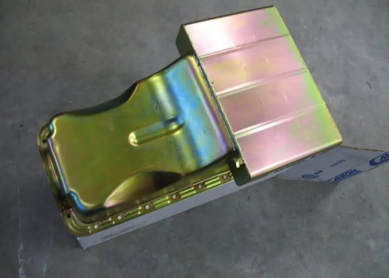

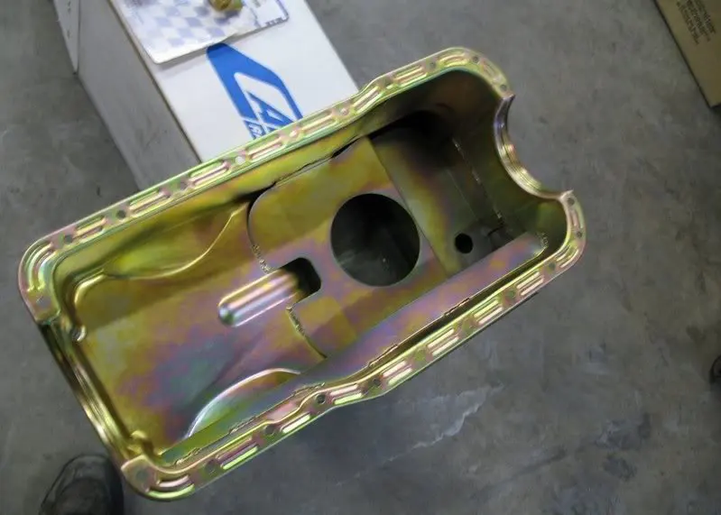

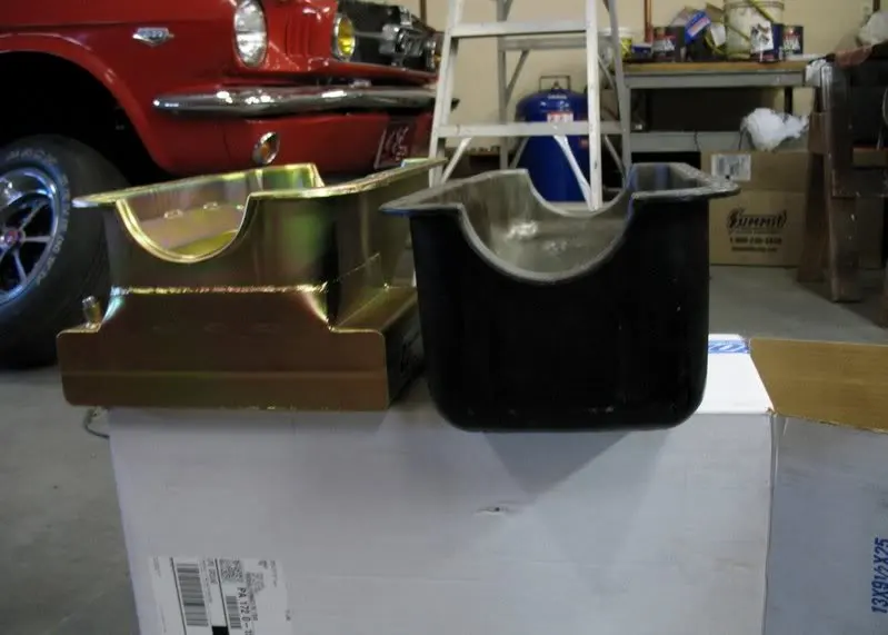

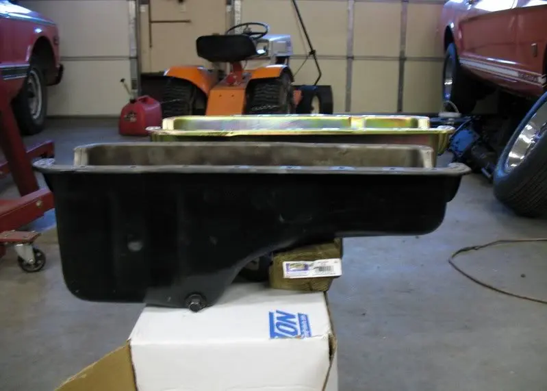

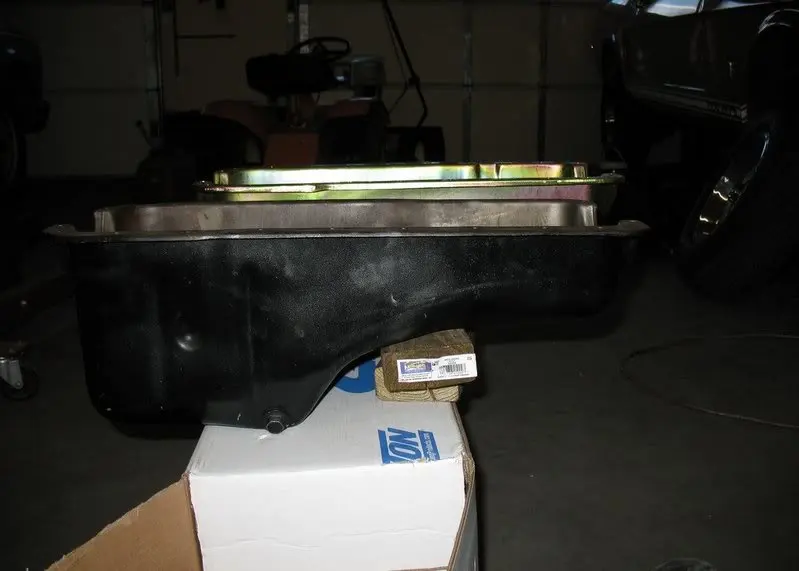

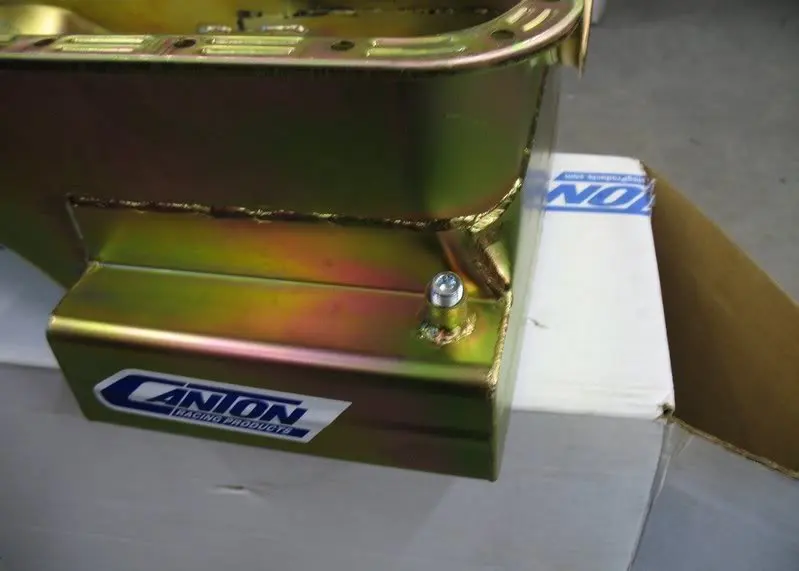

Look at the Canton 7 quart road race pan for a front sump 351w. Same height as the stock 351w pan with side kickouts and slosh protection. Fits the early Mustang chassis/suspension perfectly without issues. If your dipstick isn't in the timing cover it still has you covered as there is a place for one to go directly into the pan if needed. Be sure to get the required pump pickup and the Canton dipstick if needed. If you don't need the dipstick location the pan comes with a threaded plug.
I use one in my 65' and have always been happy with it:

I checked my box and it is this pan:
15-660 - 351W FRONT SUMP STREET T PAN
It holds 7 quarts. I've actually had 2 of them.
I can't find a 15-660S version listed on the Canton website. I had never heard of an "S" version before but from what I read on the Canton website, it typically means that there is no crank scraper. It has nothing to do with capacity.
For that reason I feel that the Summit descriptions are wrong for these oil pans. A basic 15-660 like I pictured is what you probably want as it has a scraper and the pan won't hang too low in the chassis.

You linked the pan that I use. In the notes it says 7 quarts with filter. Perfect.

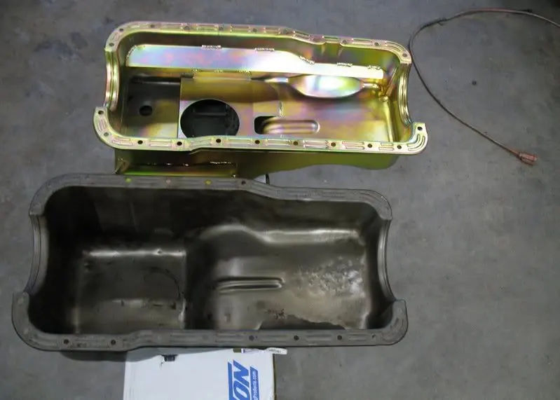

A scraper is a strip of metal on one side of the pan that prevents oil from being thrown up in to the bottom of the block from the crank rotation. Its not made to touch anything so that is not a problem. You can see it at the top of the Canton pan in this pic:
Nothing wrong with having one. I also use a 4" stroke with no issues.
