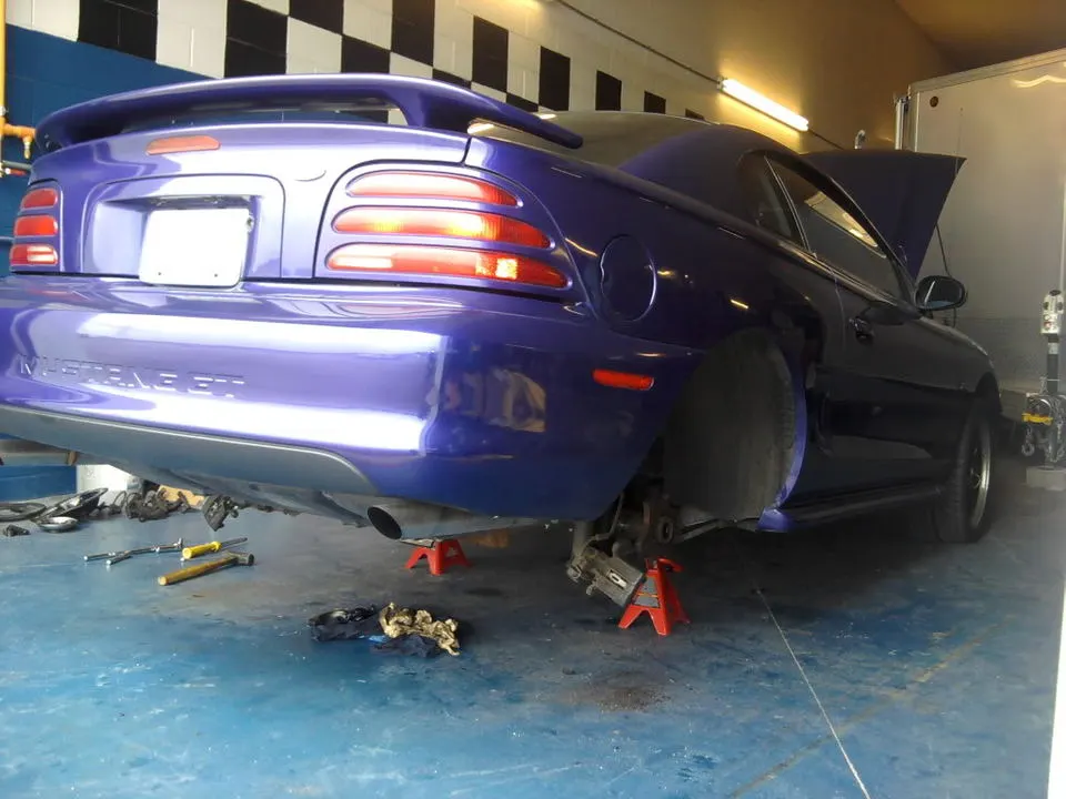

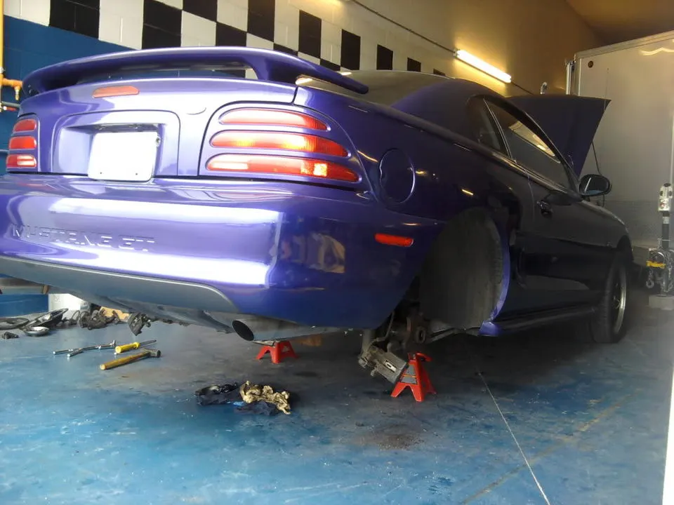

and now for the pics so far...first up, a teardown shot in the shop:

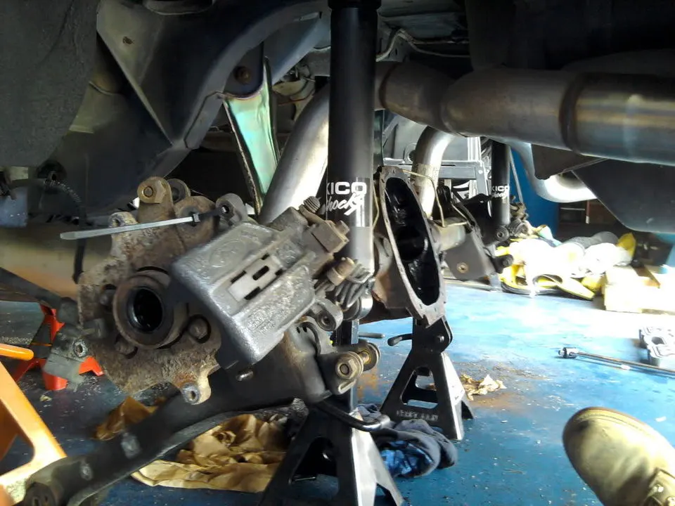

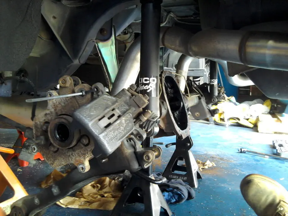

new shocks in, one stubborn control arm bolt that took way too long to remove. ended up cutting both ends off the bolt to get it out:

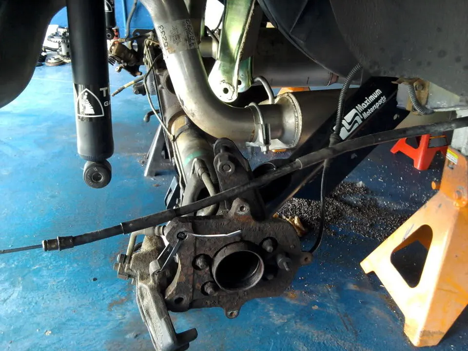

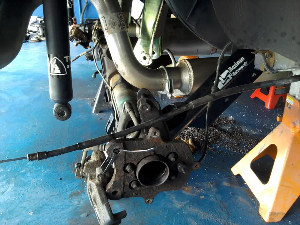

and pics of how i left it today after pouring sweat. shocks in, uca's bolted in and hanging (no bushings in the 'ears' of the center section yet), and MM LCA's bolted up. bearings have also been removed in this pic (slide hammer worked great):

Looking good so far, nice progress. Did that pile of dirt in the second pic fall all over you during the teardown?
It's kitty litter soaking up rear gear oil. It seemed like every time we shifted the axle around during the tear down, more would leak out (from the axle tubes or the back of the pumpkin).
I got quite a bit of rust/dust in my eyes when removing the dogbone though. Lesson learned - put on shop glasses, especially when the shop fan is blowing the crap towards you!
