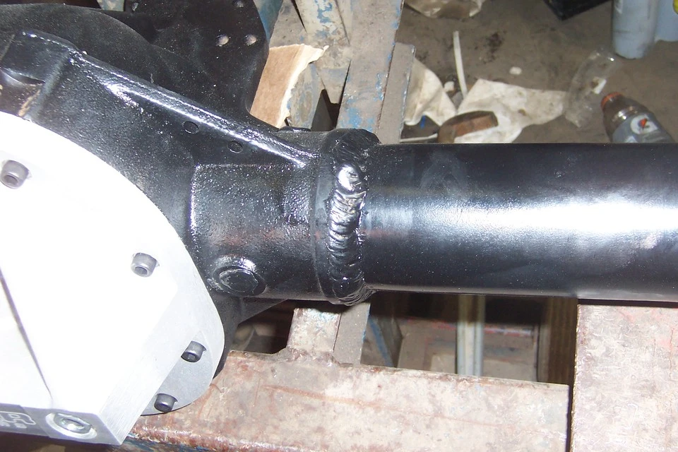

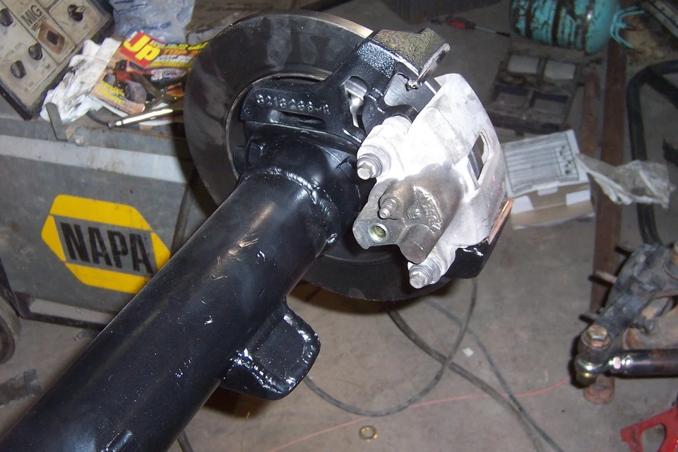

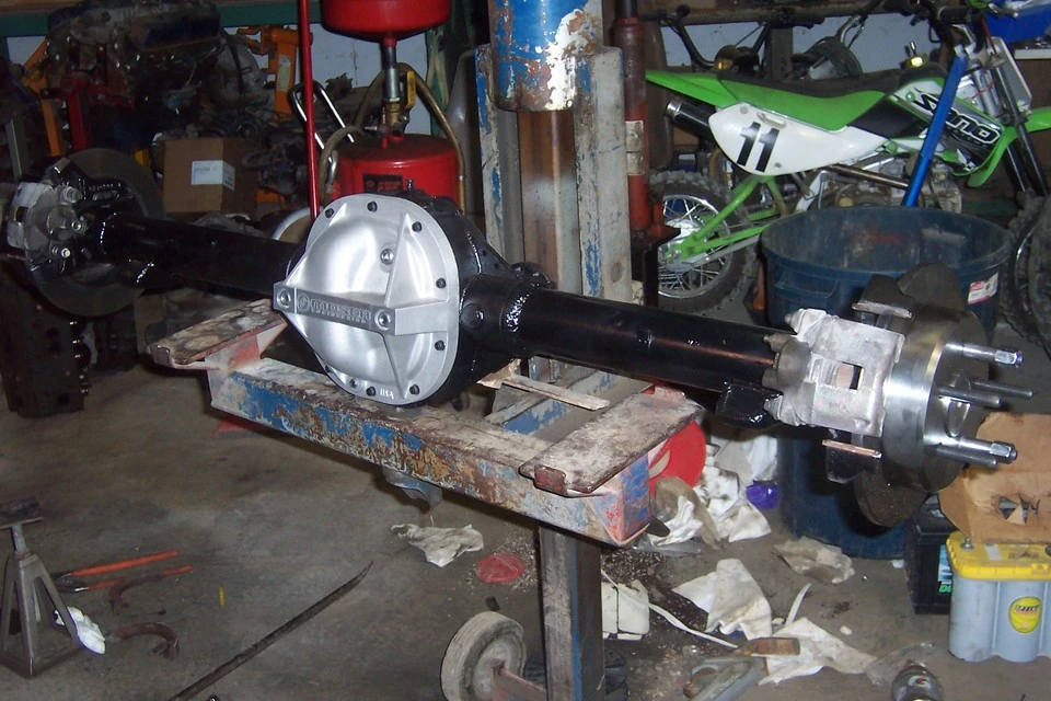

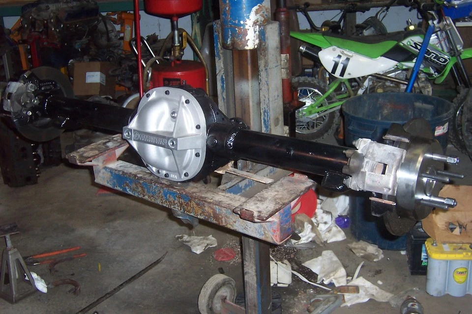

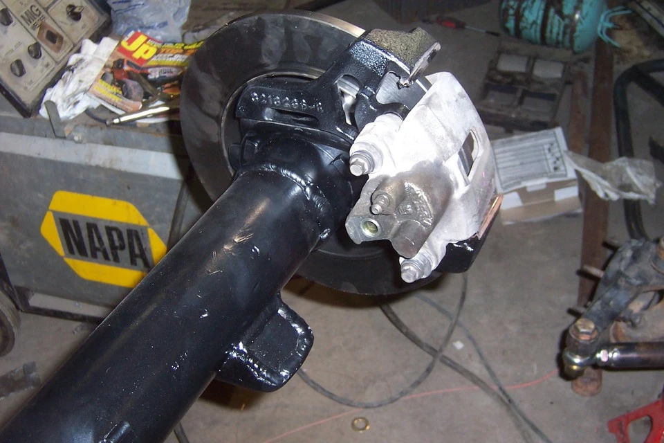

Strong, cheap and everywhere. It all depends on how much power you plan to make. For a mild build an 8" is plenty. I originally put a 95 GT 8.8, which also has disc brakes, in my 67 with late model wheels and no spacers. I had less than $200 in the rear end. It held up fine at around 500rwhp with slicks and drag radials. I replaced it with another 8.8 from an F150 with 35 spline axles, spool, 9" ends and Explorer brakes. I have about $1000 in this one and don't think I will ever make enough power to break it. There are a bunch of options depending on what you are trying to do and what year car you have. A grinder and a welder is all I used to get the GT rear end in mine.

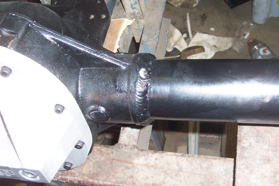

When comparing the two in a head to head strength match, A 9" rear is so much stronger than an 8.8 even in stock form it's almost foolish to make that statement. W/ the c clips, as one drawback, the other is the tendency of the axle tubes to twist and actually bend forward under the stresses of a drag strip launch. ( If you haven't seen more than one 8.8 with the axle tubes bent to hell after being in a drag car, then you haven't seen too many 8.8's.) Additionally, the bearing caps are prone to breakage (hence the need for the girdle) If you're gonna expect the one you're building to withstand 1000 hp, you better consider doing the bracing as I saw no evidence in your pics.
I had an 8.8 in my 1400whp drag car. The Tubes were replaced w/ thicker stronger units, and were not only welded as in your picture above, they had tubular braces on both front and back that tied into the center. The caps were replaced w/ billet pieces and were held in place w/ studs. The girdle was an integral part of the actual bracing that spanned the entire length of the rear. I had 35 spline axles and a full spool w/ 9" housing ends holding thee axles in. Despite all of that, I still expected to break it. All just a tad north of "putting a girdle on it".
