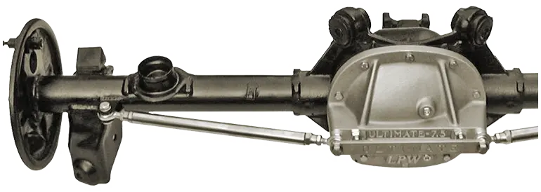

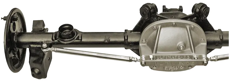

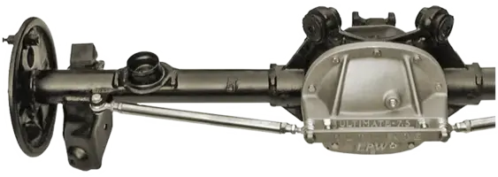

Brian. You sound way more educated than I am w/ regard to doing your home work. I modified the rear w/ what was available at the time in '07, and I cannot testify as to what is necessary in the stock cap vs billet department. They are cast iron and were never intended to hold a gear carrier in place when 800 ft lbs of torque is thrown at it . (I let that be my modification criteria) You have already obviously modified what you have, may as well use it. At your expected power level, I would expect the tubes to pull. As far as wall thickness, vs strength, you already know the benefits of the truck rear. I used two "kits" to supplement the welded tubes on mine:
This on the rear: ( it looks like the pic depicts it being used on a wusskin 10 bolt chevy rear end, please ignore the 7.5 reference )
And this on the front.
If you did this at your anticipated pwr level. I'd be comfortable w/it. Only necessary on a drag strip, though. Again, street tires will always spin before subjecting any "tube bending" axle stress to the rear.

Are the thicker F150 axle tubes necessary, or just desirable if you are starting from scratch? Locally there's a late '80's Fox running a BB/trans-braked auto and slicks and it runs 10 flats and still has 4 lug axles. It does have a rear cover like the one pictured that supports the rear caps, as well as aftermarket axles and c-clip eliminators, but it is a standard Fox housing.
