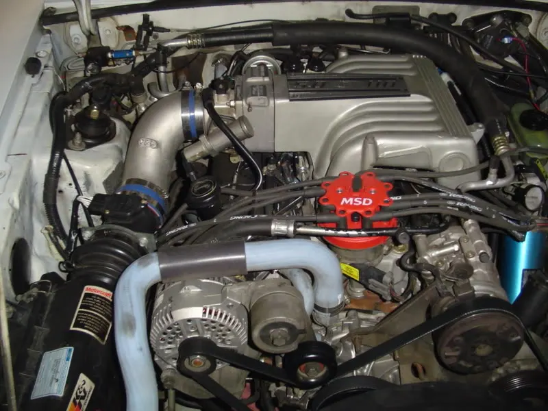

well i personally just switched to the lightning 90mm MAF. I used racepartsolutions.com for their silicone fittings. The 90mm is 4" outside diameter while the stock air inlet tube and air box has a 3.5" outside diameter. So I just used the fittings to adapt the bigger MAF. Take a measurement and see what size you need, then you can use whatever size you want.
And if you are talking about being the flat part where can put an adapter plate on I cut mine off. But there is a place you can get those plates. Then you can get the silicone fittings to go on nicely. I believe the website is Kustomz.com.... check them out and they should have everything you need.
Not sure about the pro-m maf.But a 80mm lmaf or 90mm lmaf will work with a stock air box fine..I use one on my own.
White99gt where did you get that elbow from? Also its not a problem that your going from stock 3.5 inch to a 4inch pipe? Isnt that kind of a bottle neck?
I got the elbow off ebay.But you can buy it buy itself from many places(new its like 99.00)..
I doubt its a restriction.Esp compaired to the stock stuff..Its making 300rwhp so it flows pretty good.:flag:
