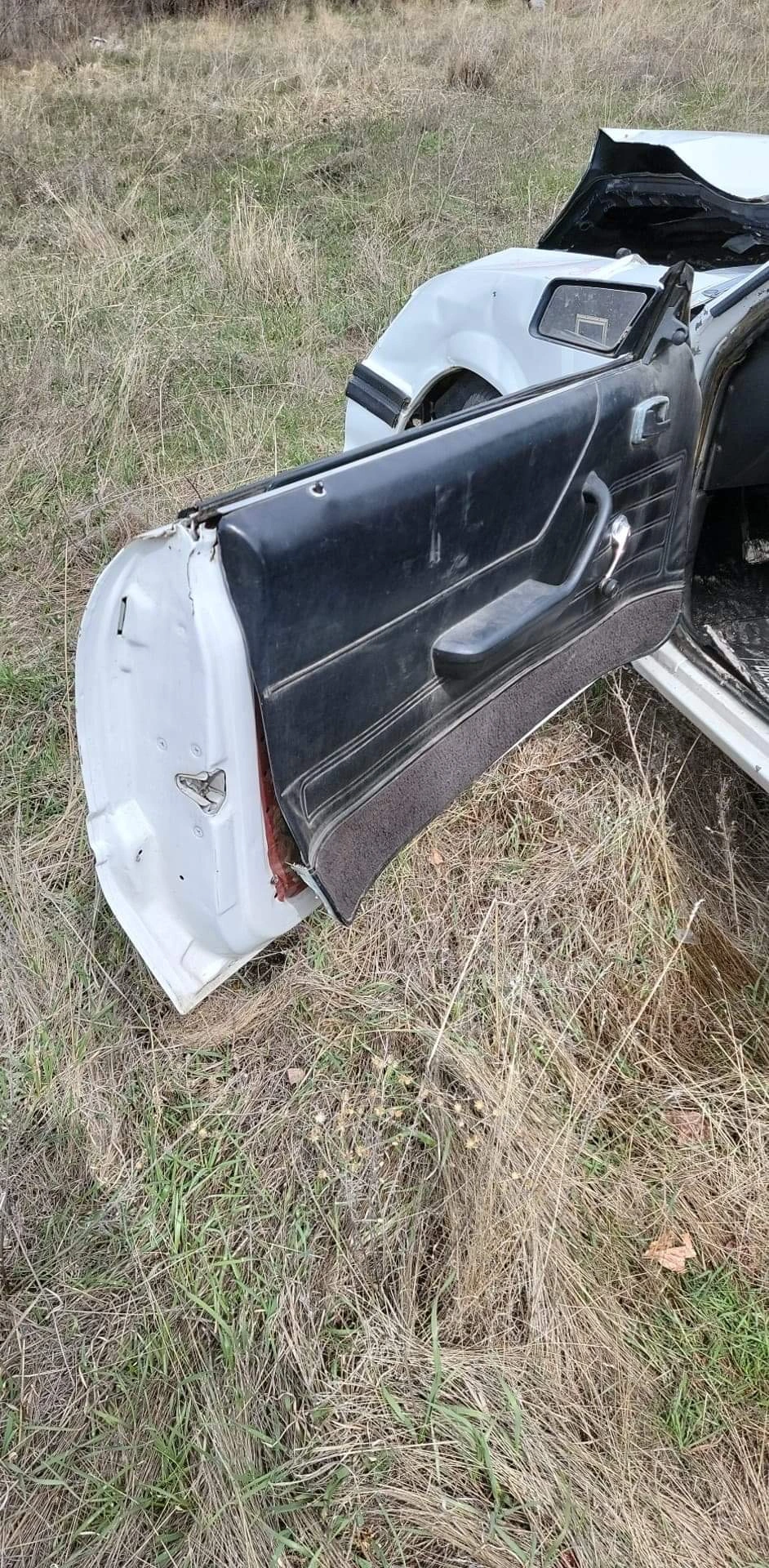

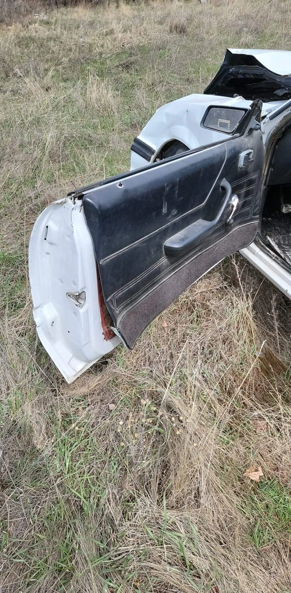

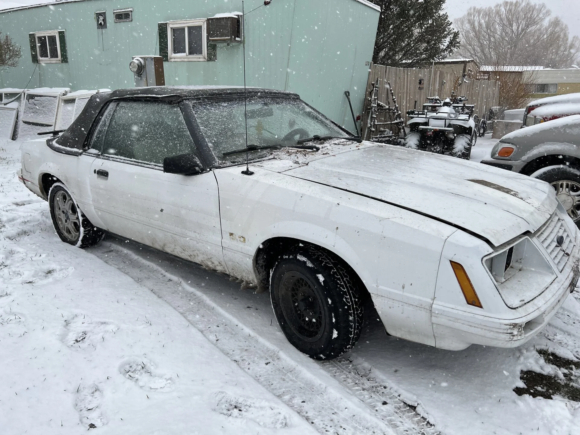

I have a 83 Convertible. Are you saying that a door from a 88 T-top will not fit? Attaching some pics of my car and the donor.

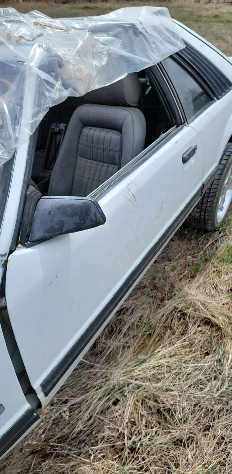

Do you have a pic of the 88 ttop doors?
Early ones had flush mount mirrors but midway they changed to the 1988+ convertible style doors. Ford switched to the “hockey puck” style mirrors that year. They will differ from your mirrors and all the seals will be different.
Here’s the 88 ttop door/mirror
Also keep in mind the door molding is different as well as the dew wipe. The glass is also different and you’ll need to swap your converivle glass in.
For the sake of simplicity, an 83-86 convertible door would be easiest unless you have access to the entire 88 ttop car and can take both doors and all the associated seals and trim to make the pedestal mirrors work. Essentially you are converting your car to 1988 style convertible doors.

My glass experience always said that if the glass changed the door did....
So 5L5, you are saying the 88 door will work if he changes the door glass to 83-86 convertible glass?
Reactions: Voxstang
Yes and no.
there are differences, outside trim on top of the door for instance, location of arm rest, power door lock switch, outside mirror style,
The 87-93 door will bolt on and function.
Wiring, braces things like that are different.
At least I believe I'm being accurate but I don't have a 79-86 door to compare, I do have a pair of 88 T top doors and a pair of 90 vert doors.
What he said.
It will work, but there’s a lot of little odds and ends and quirks you’ll need to account for as well. The 86/87 transition is hard to cross cleanly.

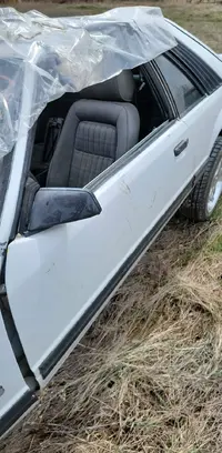

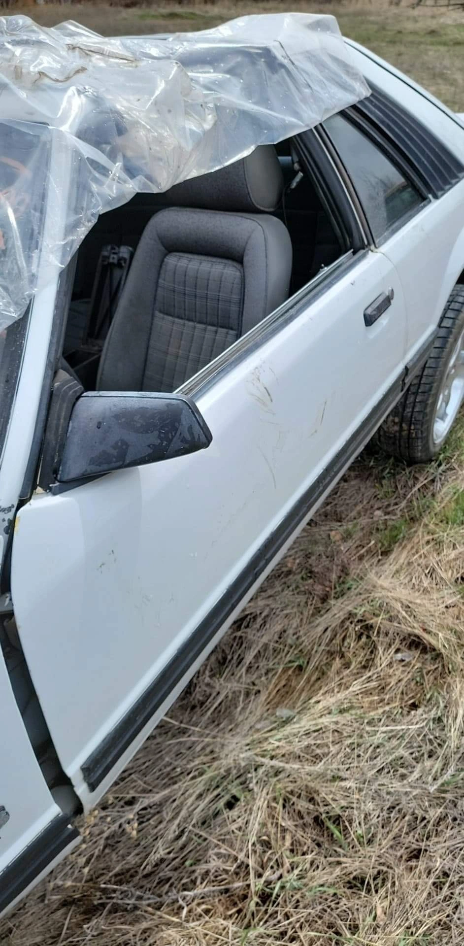

That's great information. I do have access to the entire 88 T-top minus the front end. Here's a pic of the drivers side door of the T-top.

Ok, will take a close look at the 88 Top door in person before diving in. Visually it looked similar based off the pics. It's a 6 hour drive to check out the 88 :)
My windows gone. I'll need to use the door and window from the T-top.
The door glass from an 83-86 convertible is the ONLY glass that will work... I just went through this as I needed a door glass for my 83 vert... I looked for months and finally one came up on EBAY......... The T-Top and Hardtop door glass will NOT work. ( I had to take back the hdtop glass the wrecking yard sold me).

Limp is correct. The ttop door could work but there are things that need to be swapped like Carthief mentioned
Yes, getting a donor door from an 87 88 89 convertible would be best and easiest.
