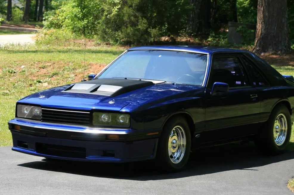

That looks great! Only problem is there is no projector that will fit the four eyed headlights. You'd have to take the glass lense off and use a headlight cover. Takes a bit of work. But has been done. Here's a Capri to get the jist.
Everyone does understand that pre-87 are all sealed beam headlights, right?
Teh noobz , if you check my post i addressed this , the one i posted will keep the glass stock lense and my85gt mentioned before so it would not chnage the look of the car but would allow nick to run an obnoxious green hid kit in them for the track which would look awesome at night
I have all new head light wiring. Not sure if it will support the load of hids but that is easy to change. I'm a bit confused with all of the ideas floating around now lol. I want it to appear relatively the same as the current lights but light up green. I like the idea that @madspeed has but I think they are too big. @MY 85 GT do you have a link for the lights you used?

They make HID housings that will fit in place of the bulbs but they all look terrible.
I can't say that I've ever met an HID conversion for a 4-eye that didn't look it was tossed in by the Pep Boys service center with Altezza in the rear and an under-glow kit.

Exactly why I wanted to find something that looks more original

Nick I got my from the English town swpa meet it was a complete kit head lights...HID lights with the ballast everything needed for like 150 bucks...ebay sell them too just type in h4656 HID kit...there are tons of them....
What i sent you should fit , same as your stock glass housing. I dont think there are too many sizes as far as those lights went. And me and madspeed posted the same size so i would believe thats it
The hids are simple. Being that they only draw high amperage for about the first 30 seconds and once on use i think no more then 3-7amps once lit.
