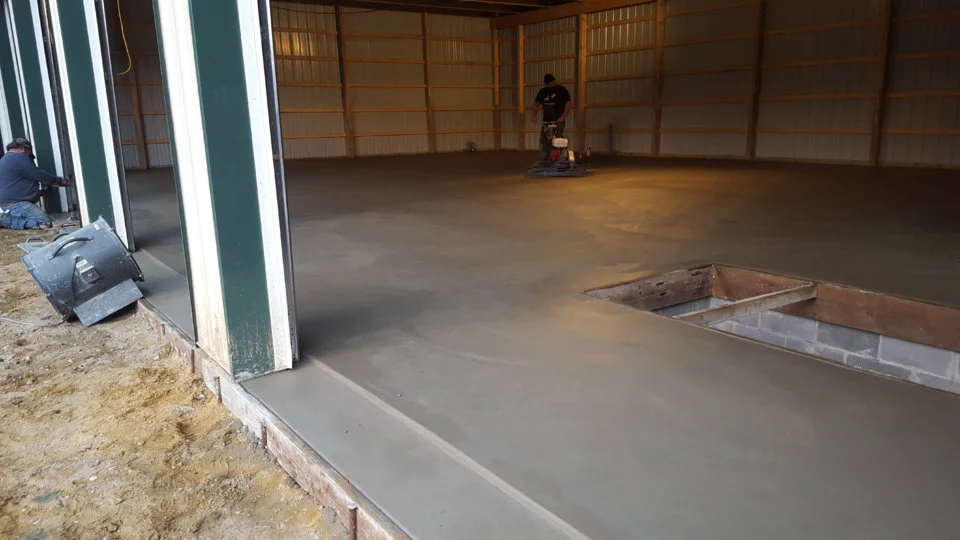

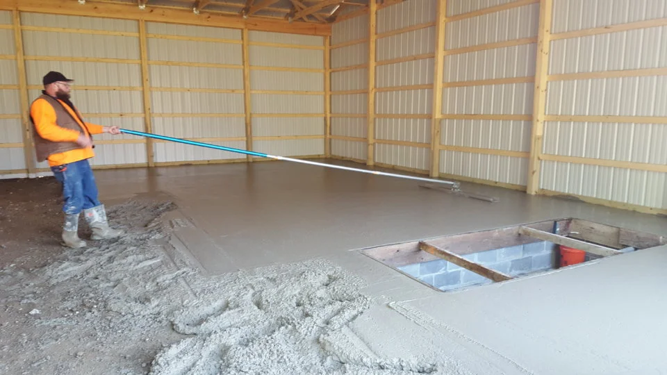

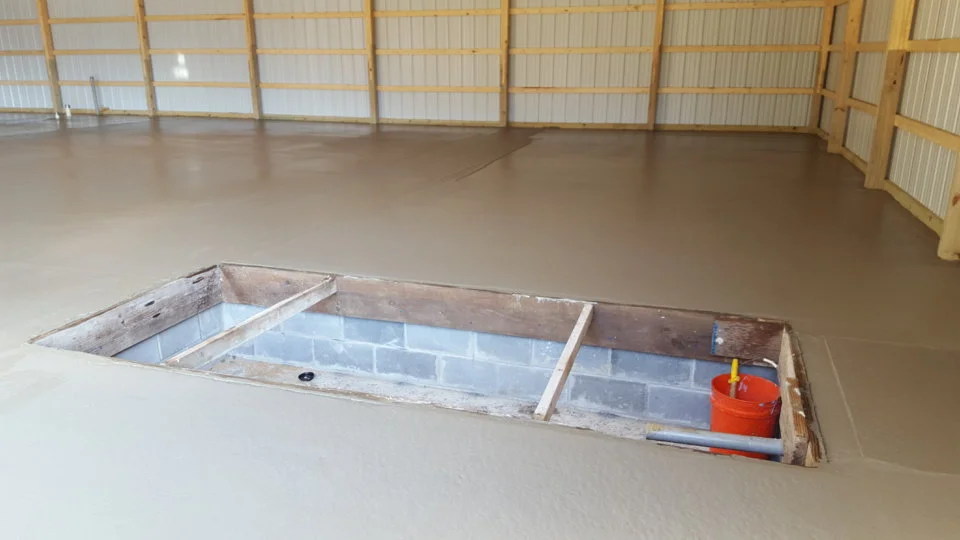

We have concrete.... I'm sure you guys aren't as excited as I am about this but what the hell
I'm looking forward to a few days off this weekend to do some work on the new shop!

No rebar??

There is rebar in the base of the dyno pit as well as the dyno pit walls, the floor is 4,000 psi fiber mesh 4" thick. The floor doesn't require rebar, I will say that the haunch footings for the 2 lifts are 12" deep and have pins and rebar in them.
The front apron on the building will get pinned to this slab as well, we are probably going to pour the apron next monday or tuesday

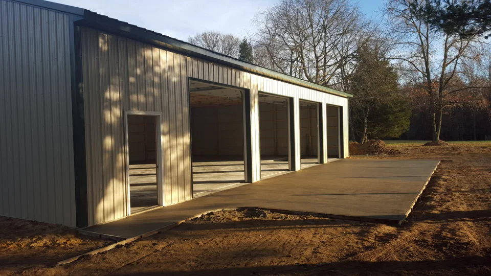

Concrete apron is poured. Need some more stone for the driveway and we will be roughing in the electric next week.

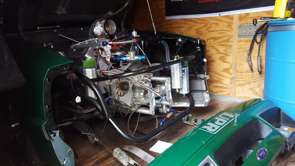

@TOOLOW91 got a good kick out of this one the other day... The reason for the new shop is that I'm absolutely out of space to work on anything. I've been puttering around with the 84 in my trailer, for that matter it's still strapped down in there and partially apart.
