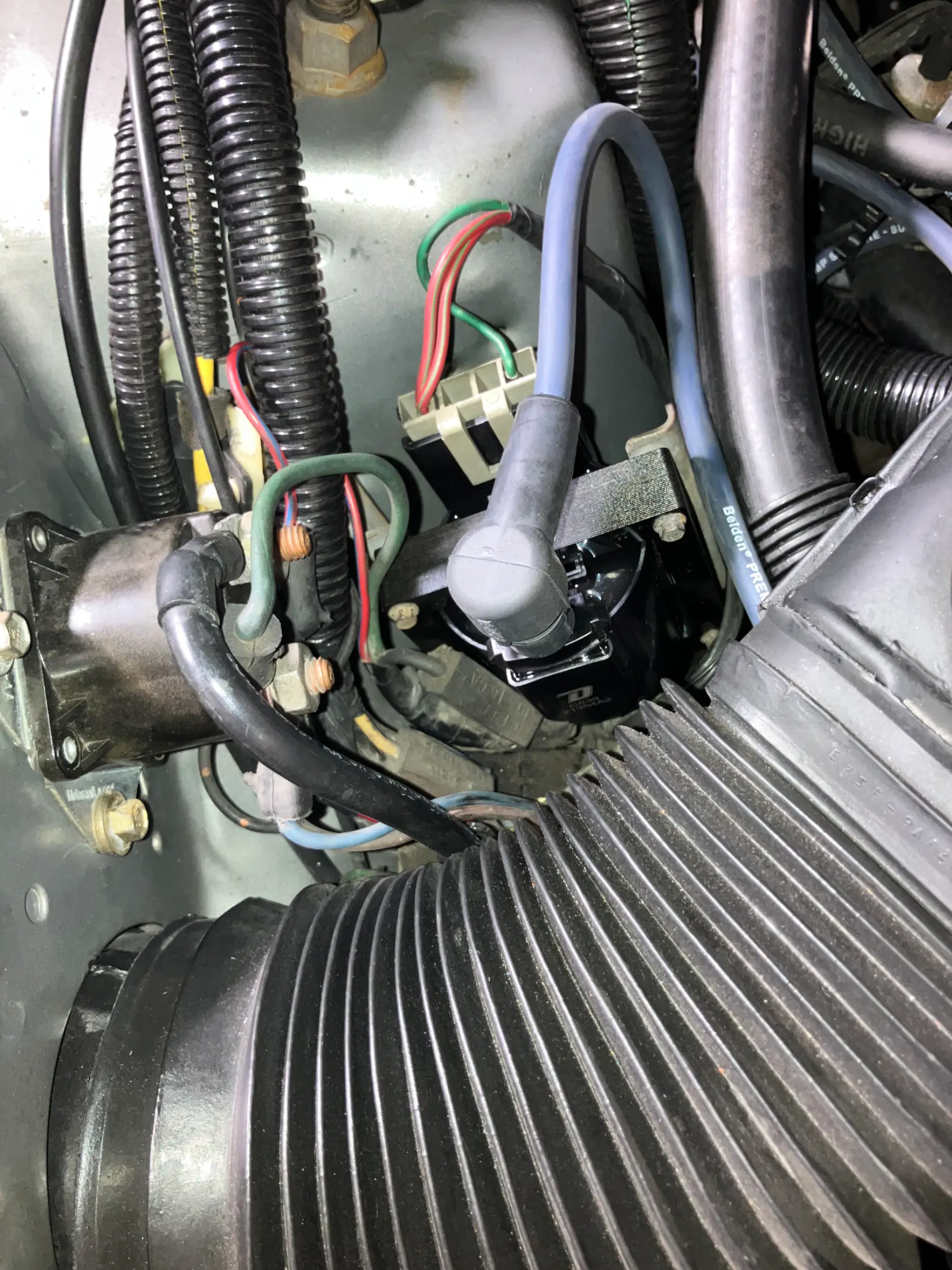

Open the hood at night with no lights on and look for lighting around the coil, coil wire, and the fram/bracket that holds the coil.
Engine running and at temp of course.
I did try that but didn’t see anything abnormal. I’ll try again in bit once dark to double check… what did significantly help the issue was spark wire routing. Here’s the area you’re talking about just for reference.
