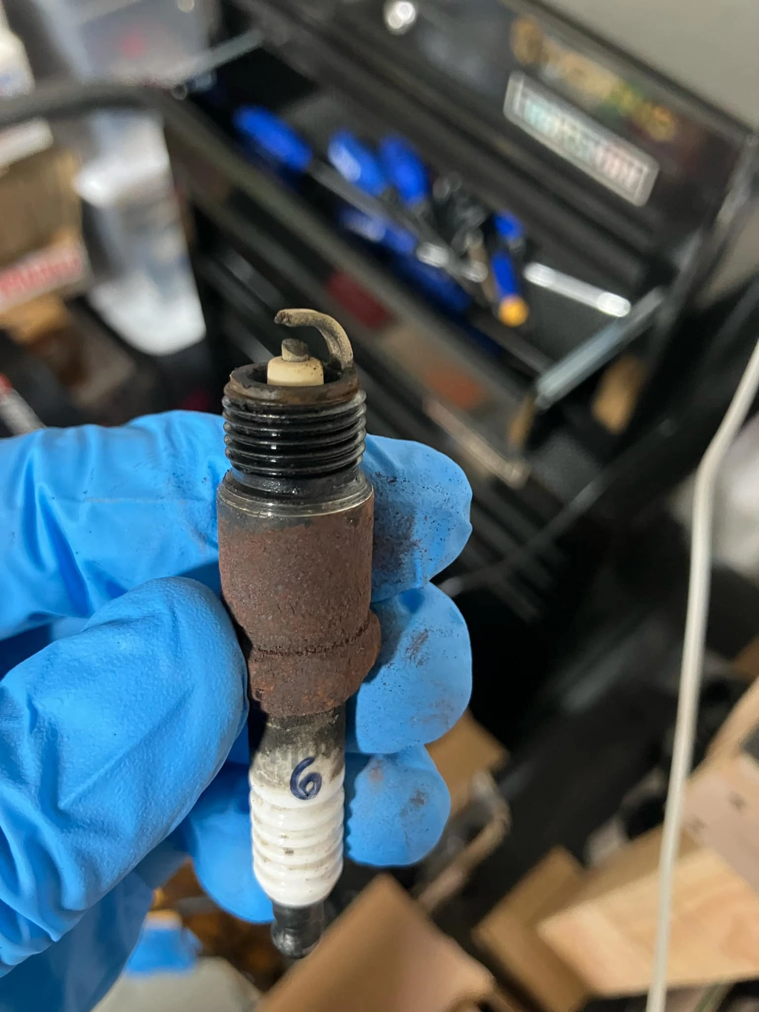

Thanks for the info, I will screenshot that for future. Right now I'm just trying to get it running good. 86k miles. Take a few days but I'll get the spark plugs out and post pics. I'll replace them either way because they're either original or close to it. I could see they're motorcraft when I swapped the plug wires... Those were original too marked 1985 on them. Same with the ignition coil stamped 1985 which I think still works because changing that didn't improve anything.

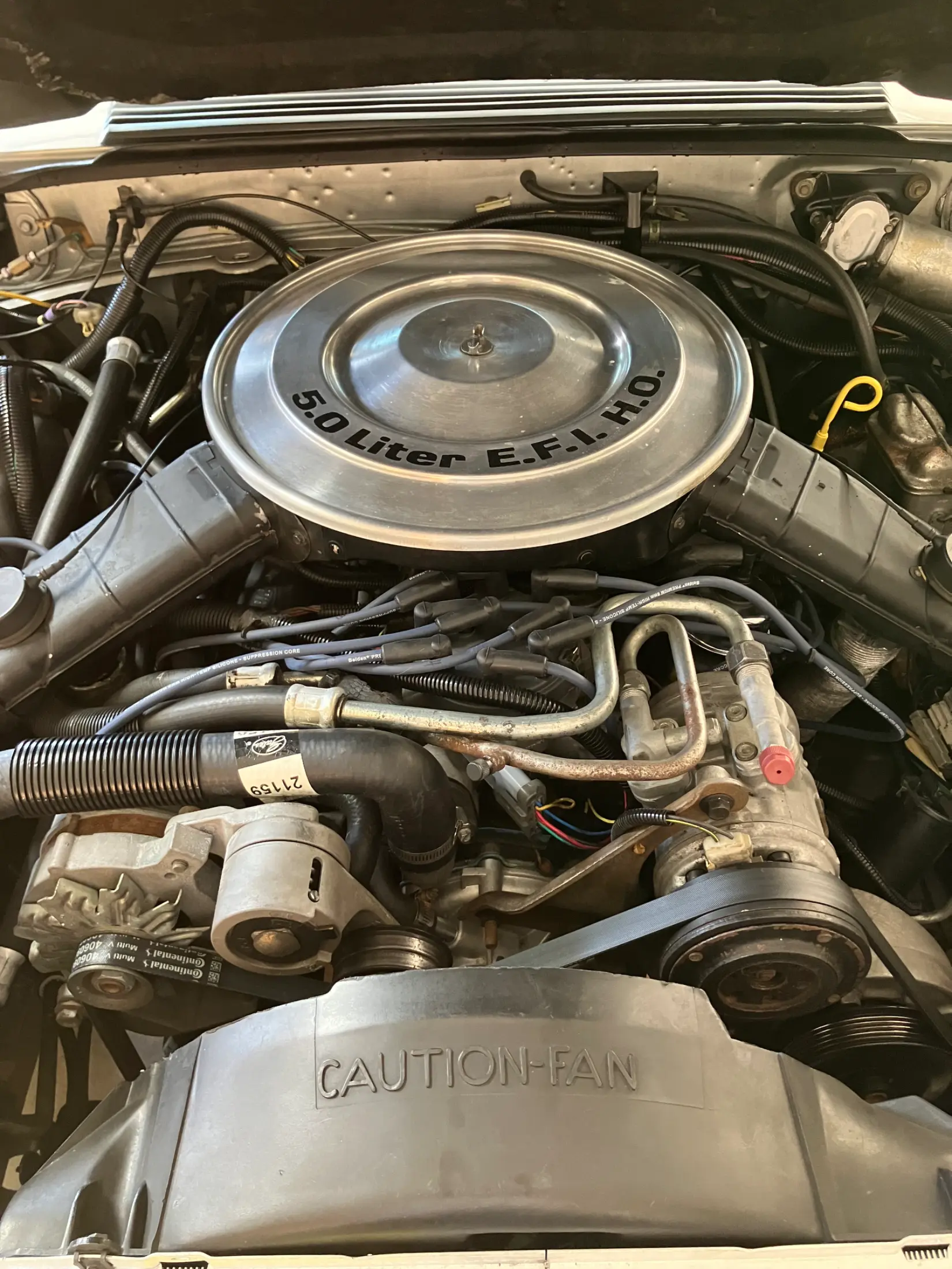

The CFI is mysterious territory even for experienced mechanics, I think the air/fuel system is not the issue here, seems to me to be an electrical issue,
Look under the car, does it still have factory cats?
I wouldn't be surprised if the problem goes away once you swap the plugs out if you think they're the originals. It could be that one or more of the porcelains are cracked. It could be that anyway.... had a very similar issue probably 30 years ago with new plugs. Apparently they had bad porcelain or had micro-cracks. The problem went away once I finally swapped them.

Okay will check ignition switch. Electrical Plug on coil is good, clean contacts and wires. And yes it still has factory cats
Maybe, but i'm not so sure in my entire life replacing a spark plug on any type of engine has ever fixed anything.
thanks. only thing that improved anything was moving the spark wires to make sure 1/3 and 5/6 didnt come close to eachother. that was still with the original spark wires from 1985. I replaced wires thinking would fix it completely but no dice
