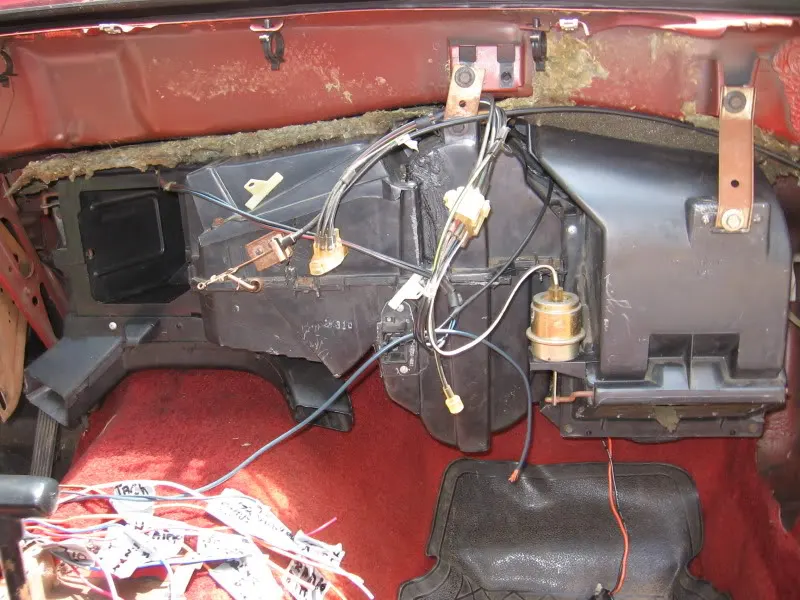

Im not totally sure about your 85 but on my 89 there is no valve like you are looking for. there is a valve that changes the direction of the air flow through the air box but coolant is always flowing through the heater core. the valves are mounted on the side of the air box behind the dash, one is cable operated and the others are vacuum operated. Here is a picture of my buddys 84
