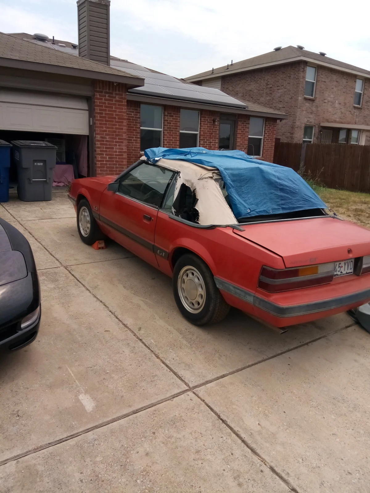

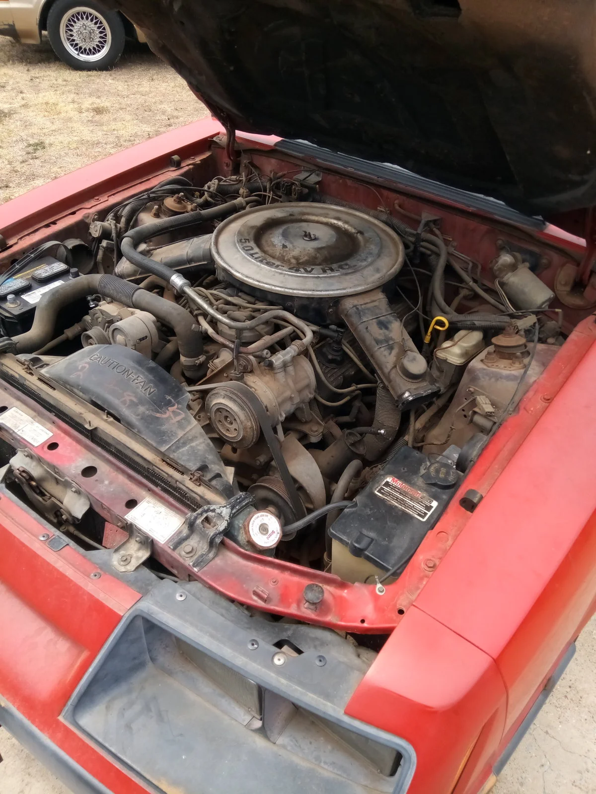

Recently I bought my fourth Mustang an 85GT 5speed. I bought as a non runner and the car has sat up for the last 4 years. I know I need to drain and refill the oil and coolant. What should I do next before trying to start the car?

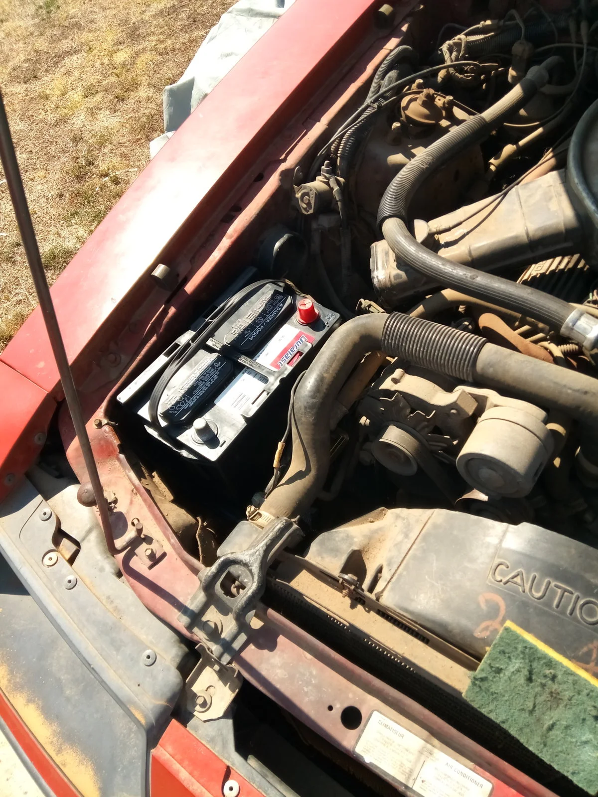

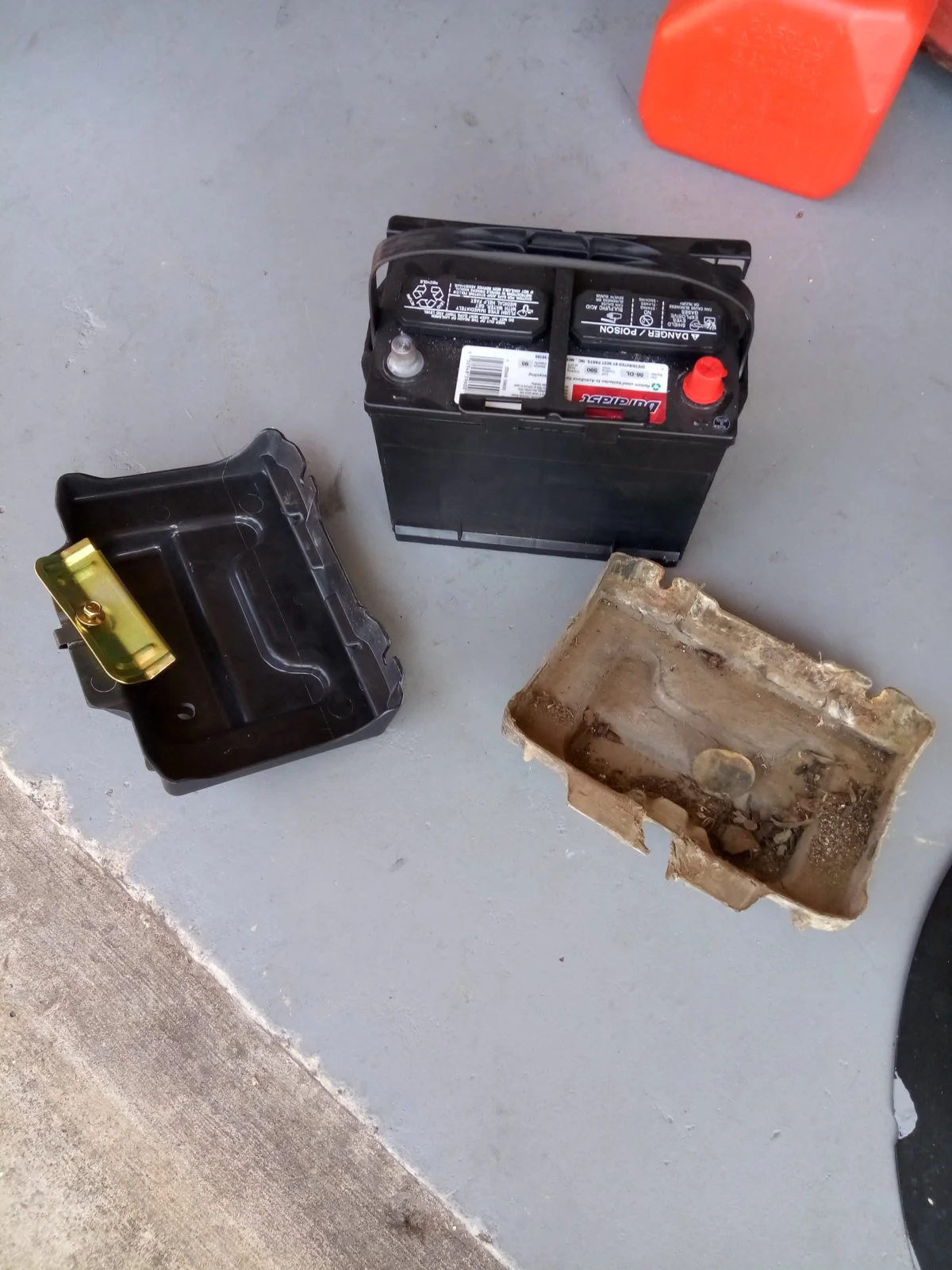

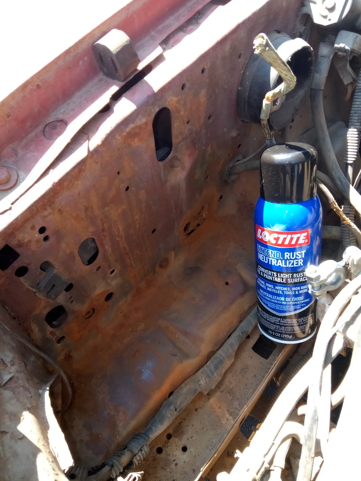

So I made a little progress on the 85 today. I removed the old battery tray and found a little surface rust and cleaned it up with a wire brush and finished it off with three coats of rust neutralizer. Installed a new battery tray and battery to see what electrical components work. The headlights and taillights were the only components to work. So tomorrow I'll be back at it in the morning before the heat wave comes through. I'll keep y'all posted.
