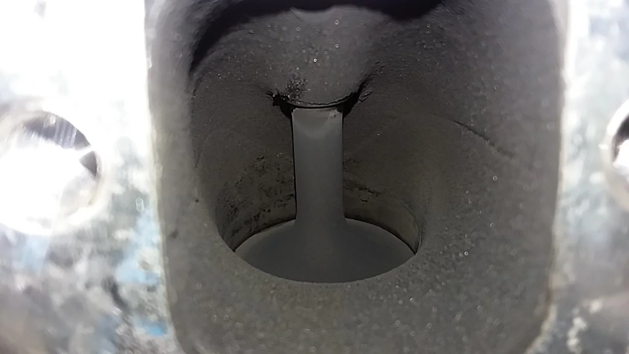

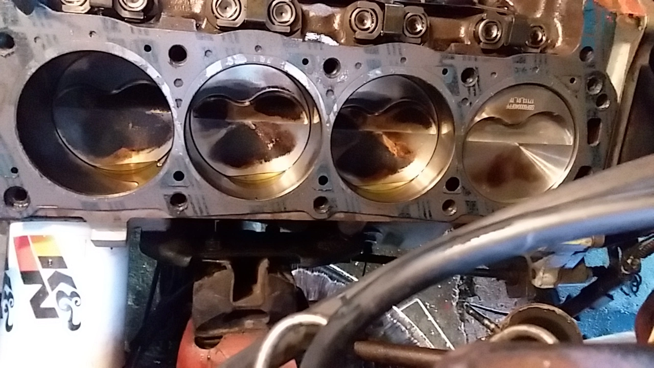

Pulledbrhe plugs, they are fouled badly. I thought a possible exhaust leak so i removed headers to see oil in the exhaust valves. Looks like its coming from valve seals. I pulled the heads and the pistons have some burnt oil on top of them. The valves are not burned up everything is black, bottom of valve and exhaust ports. I did a compression check before i took it apary and all came out to 150psi +/- 1 or 2. Im thinking valve seals/guided nnrings. These heads are all brand new. TRICK flow 170 heads with upgraded valve springs kit. Its came with upgrade on it from LMR ....tfs51400004-m61. Idk what to do now. Ive torn it apart down to block. Ive hesrd bad pcv valve can do the same thing letting oil onto valves. Im running.out of ideads and money.
