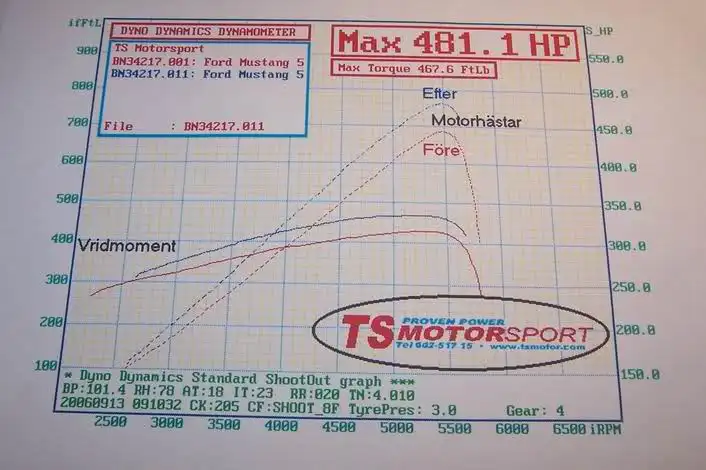

Dyno numbers after my Procharger, 1P-SC install. 0.73bar (10psi ) boost.
Trick flow EFI kit, TFS stage 1 camshaft etc. ( more info at "My Garage" )
Dyno numbers in Flywheel horsepower, (approx 397 RWHP.)
(Torque=Vridmoment, Before = Fore, After= Efter, Flywheel hp= Motorhester)
Any comments presuated, Thanks. :)

Stock block.
Thanks guys. :) Yes, all stock internals. Only new rear main seal, and oil pump shaft, and oil pan gasket. Engine has a milage of 112K miles, and seems to bee ok. Homemade flycutting because of my flat top pistons. Approx 9.2:1 compression. RAM alu flywheel, and a summit SFI crankshaft damper assy. Commetic, three layer steel head gasket.
