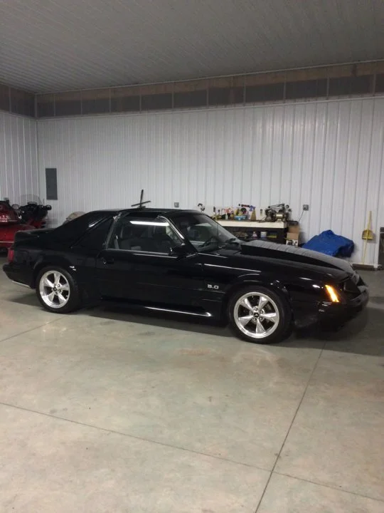

follow jrichker's checklists.. they work. Don't tease me, let me see some pics of your 86. I don't see them out on the road much anymore, except mine and she will be getting parked for the winter pretty soon

NICE!!! T-Top GT. It just looks fast sitting still. Black on black, 5 lug conv, 2 inch hood?, mabe 1.5 inch drop springs, new paint. I wish my garage had that much room. Any luck on your surge? If it dident have the blower, I could help you. I don't know anything about those setups Nice pic...

Thanks, garage is roomy I got a 79 ace car that's in there too. Car has a lower intake leak gotta tear it down all over again.... :poo: happens.
