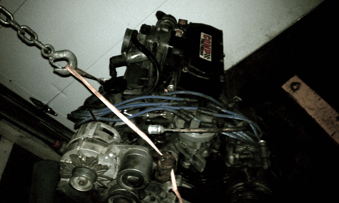

I have a 1995 with the stock 3.8 (blew up), 5 speed, I picked up a 87 302. What am I going to need to complete this swap? I have searched the forum and can't seem to find the right thread. If someone has a link to this please let me know. Any advise would be appreciated.
there are 2 ways to do it....
the easy way and the hard way....
the easy way is to pull everything and i mean EVERYTHING from a 94-95 gt
the hard way is to hard wire thhe motor to the car (the way i did it)
unless your going to go carbed then its pretty much drop it in..
you can use your trans but not the bell
your cross memeber is the same no need to change it
