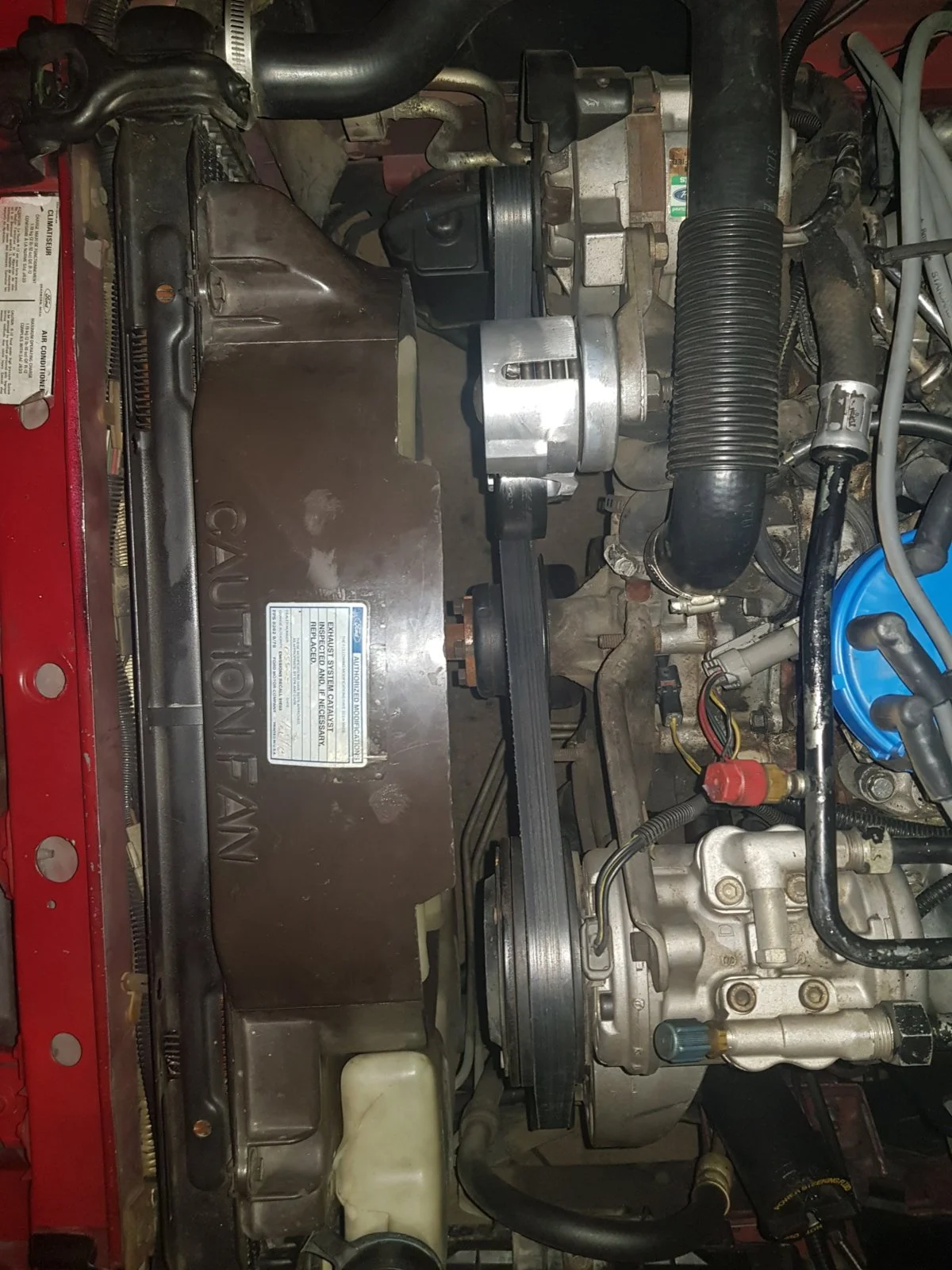

Hi,
I have a 87 GT Convertible that I imported to Australia....having problems getting registered but that is another story.
Anyway the belt tensioner indicator shows it is too tight - past the acceptable range. It is all the way tight and is squealing from somewhere.
Is it likely a bad tensioner pulley ? I know they aren't very expensive but for me the shipping is always much more than parts like this so I don't want to replace if it likely isn't the problem.
Any suggestions ?
Bad belt, wrong belt and wrong belt path are the most common problems. Look for the belt routing diagram on a sticker on the brace that supports the radiator hold down clamps.
I had installed a new belt tensioner and thought it was ok but on acceleration there is a loud squeal coming from what I assume is the belt somewhere.
I took the belt off and the alternator spins freely, as does the smog pump and a/c (obviously with a/c clutch disengaged), the water pumps seems fine..so really likely the power steering pump which I will replace once I order and receive parts as it is really noisy.
To be certain it is the p/s pump though, how freely should the pulley turn...?
There is a pointer on the tensioner that tells you belt wear, where is the pointer at? Now there are some opinions on what to use for fluid in the power steering, I use power steering fluid, not automatic trans fluid, my pump has 140k plus on it and a slight moan when turning, when I changed the rack I flushed it real good too.I
what ever fluid you use should have no effect on belt squeal though, just say'n.

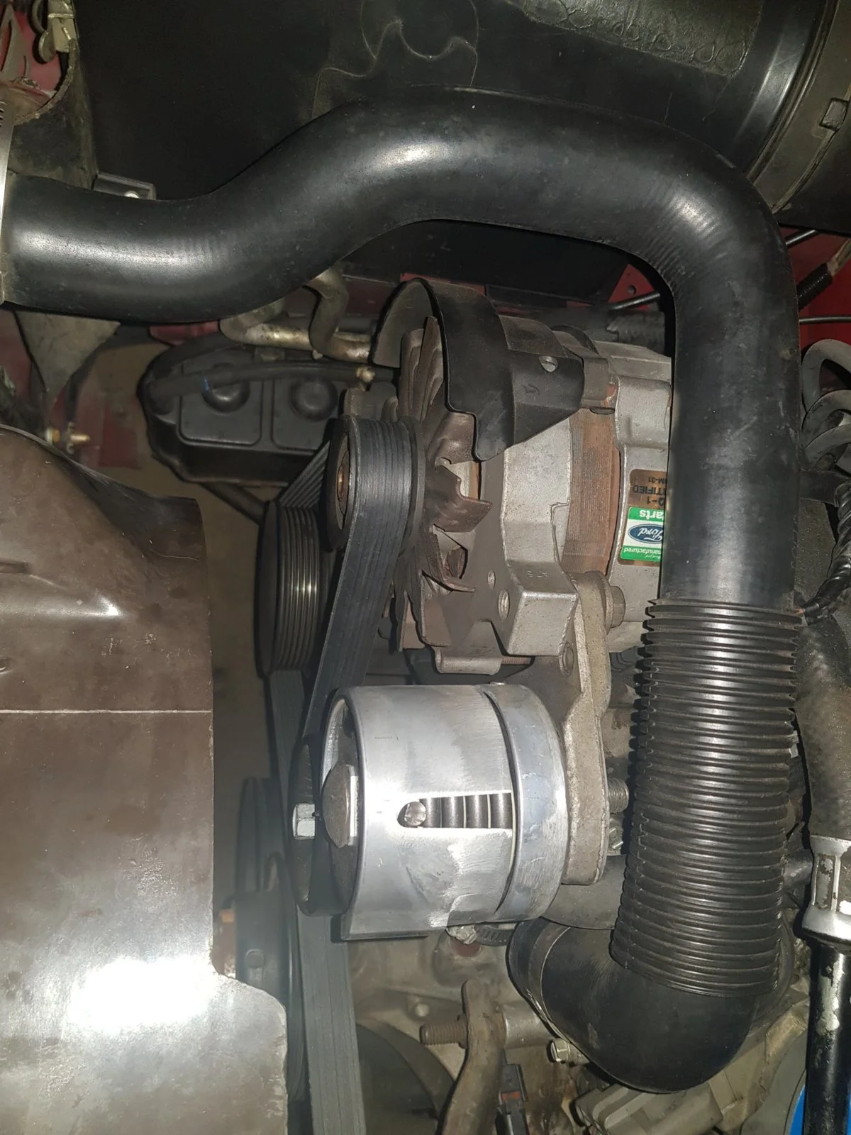

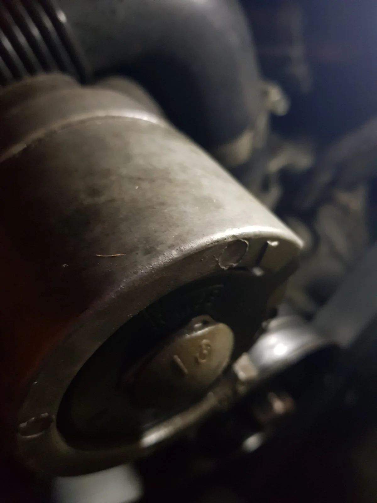

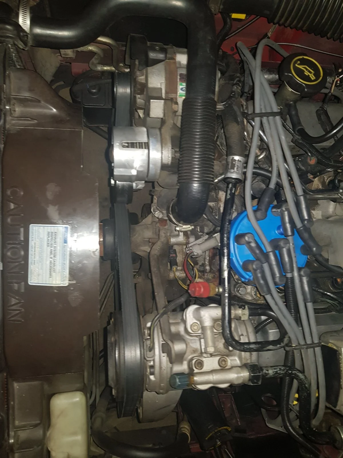

I have a new belt 91 inch and tensioner. The tensioner started out just a half inch off indicator being at top and now it is all the way to top - after only 100 miles. Replaced tensioner and belt because it was all the way tight as well but I guess it wasn't the issue.
Interesting that you use ps fluid and not dex ii
I think perhaps the belt is too long instead of too short ? Which is strange as it is the standard 91.5 belt .
