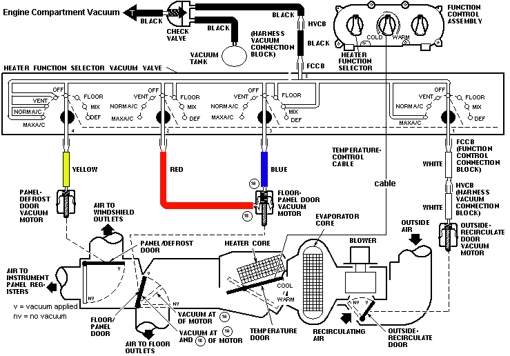

As far as your heater, it's likely the HVAC blend door not opening. Either you've got a vacuum line going to it that's split, cracked, disconnected, or otherwise leaking. With the car running, crawl around the passenger foot area under the dash and listen carefully for a hissing sound, and see if you can trace it to its source. If not there, do the same under the hood and listen close for a hissing. Only other things I can think it would be is a bad vacuum actuator (but those hardly ever just fail outright, really) or the HVAC controls are broken or otherwise unhooked somehow (maybe if someone was installing/removing a stereo and got sloppy about it, might've damaged something).

Try this for your heater control problems.
See the following website for some help from Tmoss (diagram designer) & Stang&2Birds (website host) for help on 88-95 wiring http://www.veryuseful.com/mustang/tech/engine/

Glad it helped out some. As far as the compressor cycling on and off while you control is set for heat, the compressor should only run when in mix and defrost....I think. I know it runs in defrost but not sure about mix. I know its not supposed to run in heat tho. Regardless, you should still be able to get hot air no matter where you have the controls set. It sounds like the damper isnt opening for some reason. That is a very good diagram for the vacuum routing as I just learned something from it myself. According to it, there is no actuator for the heater core bypass door. Its cable driven and not opened or closed by vacuum. Damn, thats good to know. I havent had mine apart yet but will soon cuz my heater core is a leaker and coming out soon. That makes things easier for you then. Just track down the cable running to the door and make sure its working. If thats all good and the door is opening and closing, you are having an issue with the core itself.
