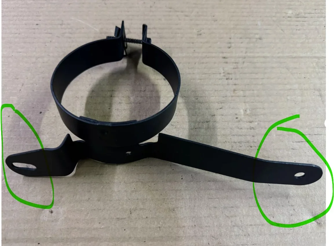

B Blueinfan Active Member Mar 18, 2021 259 60 38 Temecula Oct 24, 2024 #1 Oct 24, 2024 #1 Does anyone know what size are the nuts that are used to secure the bracket to the inside? Or where can I buy them? Attachments AC.webp 88.7 KB · Views: 80
91AOD5.0LX I have a slight sag in my rear 5 Year Member Feb 20, 2021 1,065 996 133 Lake George NY Oct 24, 2024 #2 Oct 24, 2024 #2 7/16 wrench fits the nuts on my 91 Reactions: Blueinfan

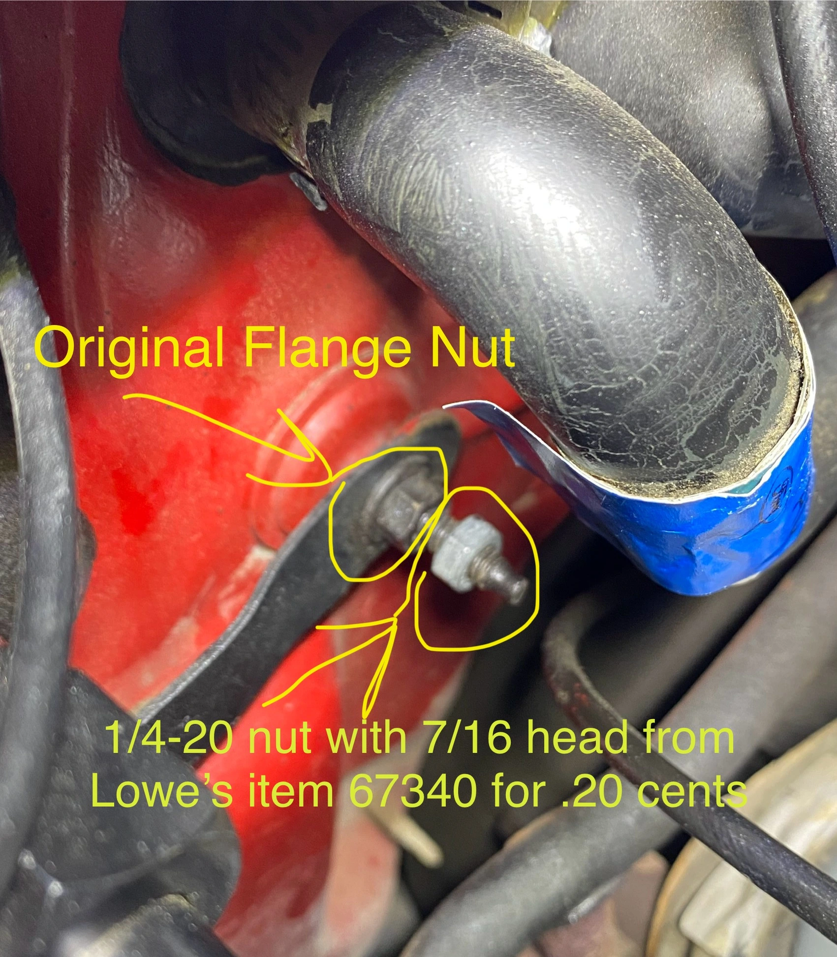

91AOD5.0LX I have a slight sag in my rear 5 Year Member Feb 20, 2021 1,065 996 133 Lake George NY Oct 25, 2024 #4 Oct 25, 2024 #4 On my 1991 LX, a 1/4-20 hex nut with 7/16 head fits perfect on the factory stud. The original is a flange nut with washer attached. Hope this helps Attachments IMG_7714.webp 310.9 KB · Views: 71 Reactions: Blueinfan, 89ripper, Mustang5L5 and 2 others
